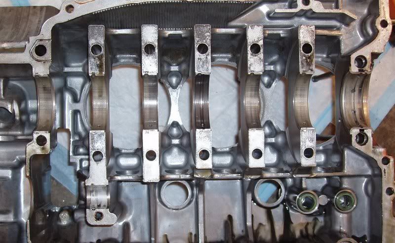

I will be rebuilding an engine in the very near future and have been reading all that I can on the topic. I have come across someones thread where there was some discussion about bearings.
Instead of hijacking another thread, I thought I would start a new one dedicated to bearings.
The discussion in the other thread is concerning "washboard" wear pattern when using aftermarket bearings. Here is a picture:
Here is a post that raises my concern:
=Steve@Rennsport;5125856]Mike is absolutely right. Glyco's quality has really slipped and the best bearings are found at the Dealer due to PAG's QC checks and standards. We no longer use Glyco rod and main bearings sourced from the aftermarket.
I currently have a set of bearings supplied by our host. Is there a way to tell if the bearings that I have will exhibit this type of wear pattern?
Would I be well advised to discard the bearings I have (or return them to our host) and source the bearings from the dealer instead?
This engine rebuild isn't something that I wish to do more than once. (Don't get me wrong, I will rebuild more, I just don't want to have to rebuild THIS one again.)
Thanks for your replies. And feel free to use this thread to discuss these bearings.

I think you would be hard pressed to measure what you see in the picture above. I'm guessing here but I would say that the "washboard" is .001" or less. As with all moving parts that mate to one another a certain amount of run in will take place, but remember that the crank and rods never touch the bearings. There is a clearance between the two that is occupied by oil and maintained by oil pressure. I am using the same bearing in my rebuild but had them coated.
I do agree that our parts for these cars are overpriced from the manufacturer. I don't believe that the bearings we get from Porsche warrant the price difference between other similar applications. NASCAR rod bearings are half the cost (even with eight rods) compared to factory Porsche parts. These are 10,000 rpm, 850 hp motors and the bearings look new after 500 miles of that. It's all about what the market will bear.

No real comment about the bearings other than we use factory bearings whenever possible and polish the bearings with 600 grit wet dry and then dry film coat them.
Both factory and after market bearing alike.
One quick note: A visual inspection of the case shown below indicates that the main bearing saddles show movement. This shuffling can be minimized by applying a thin coat of LocTite 574 to the contact surface. Short of shuffle pinning the case nothing will prevent movement 100% but the 574 adds shear resistance that can be measured and witnessed during disassembly..

Looks like a little fretting with the mains goinn on there!

If you're describing the movement of the bearing web as fretting maybe, but the wear (linear striations) on the bearings is more likely wear exposing a manufacturing defect.
Fretting is caused by small scale oscillatory movements. With journal bearings this can occur through external vibration transmitted to the bearing area. Fretting damage can also occur on the backs of journal bearing shells that are not given an adequate interference fit in the housing.

If using Glyco bearings, they should be inspected by an expert mechanic that knows what to look for. My local wrench buys them in batches of 20, inspects them all, creates sets of "good" bearings and returns the rest. He says that about a third of the Glyco bearings he sees don't pass his inspection.
