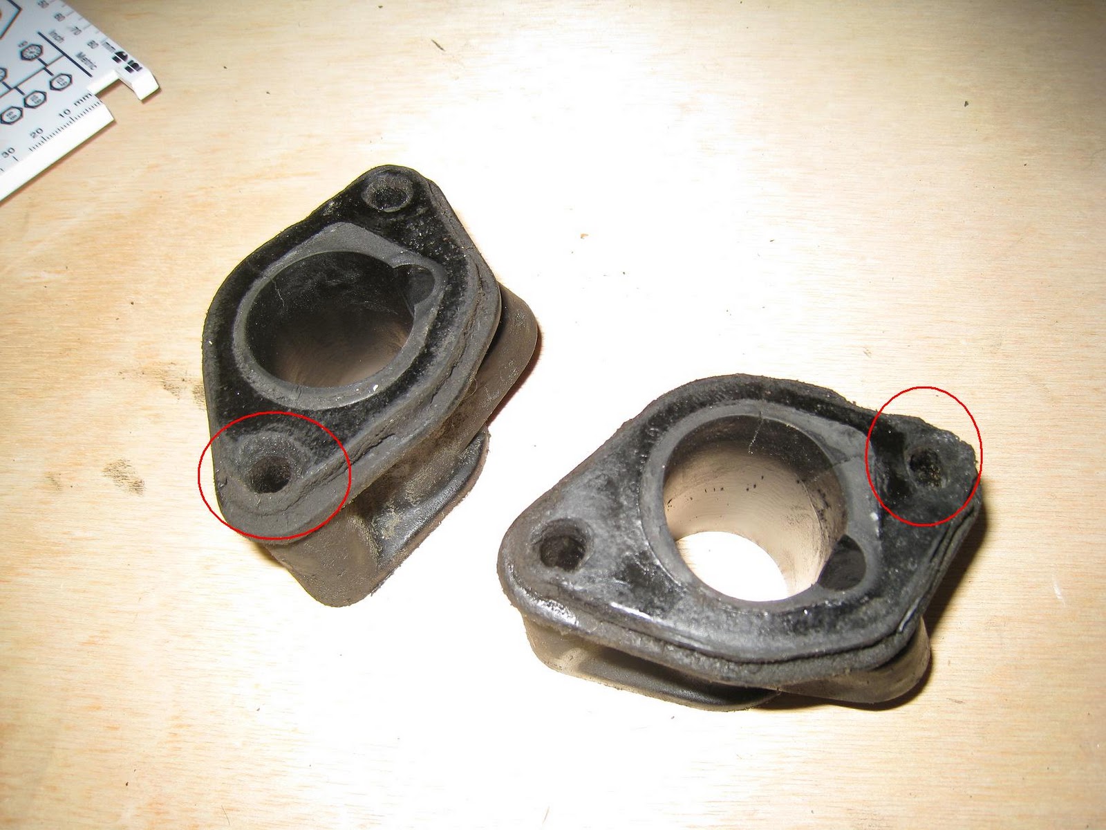

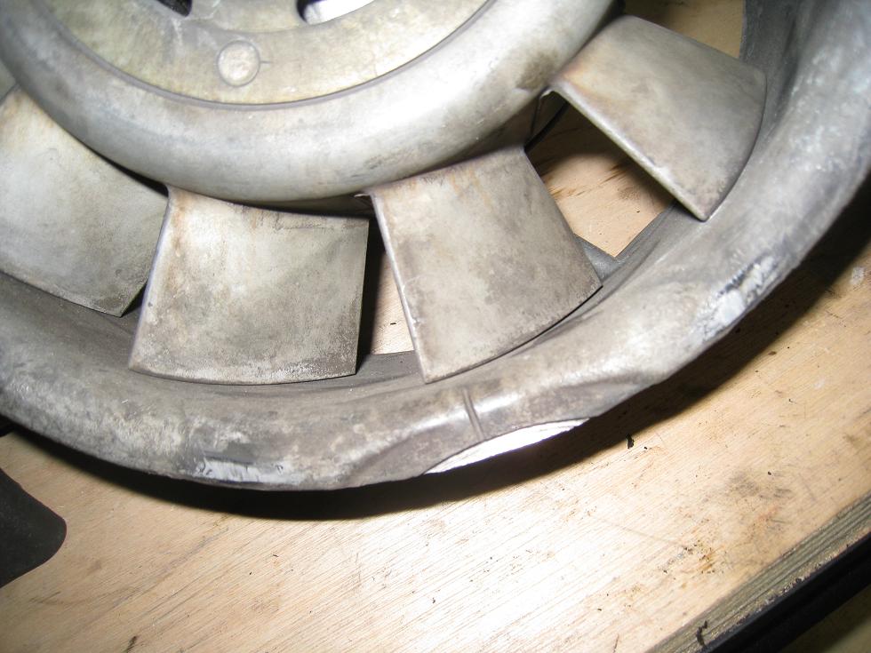

I am completely on board with you when it comes to the camera. I have a ton of pictures just from my first day with the motor. A couple odd ball things I found are below: Deterioration on the injector blocks and wear on the fan housing from the pulley.

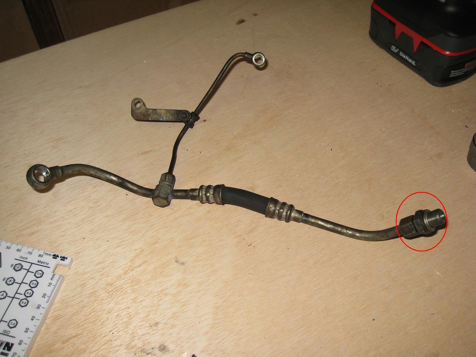

Something else that I ran into on a couple of the hard oil lines was that the fittings that attached to the engine seemed to have been locked up. I was always under the impression that the intended design allowed you to spin the fastener while keeping the hard line stationary. two different fittings were locked up to the point where I had to detach the opposing end of the line and then spin the entire piece to remove it from the engine. Is there something I can soak these in before re-installing so that they work as intended?

It looks to me like the fitting you have circled is the one that attaches to the cam tower. What you should have done is attach 2 open end wrenches to that fitting and while holding the larger fitting still in the cam tower break compression fitting, (the smaller nut) free. This leaves the larger fitting in the cam tower and eliminates the need to rotate the oil lines.
Thats what I thought and I gave that a go but it felt as though I was on the brink of forcing it too much. At the end of the day its off now but thinking ahead to re-assembly I'm thinking of maybe soaking the entire fitting in liquid wrench to see if I can't free it up a bit. Any concerns over that approach?

Throw out the Liquid Wrench. Buy a product called SeaFoam Deep Creep. It is amazing. Soaked my exhaust nuts with it and removed them without heating or breaking a single stud. Had a couple of piston squirters that were plugged. Gave them a shot of Deep Creep and in 2 min. they were flowing free.
