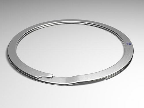

So whats with many now using the spiral circle clips (spirolox) now a days. We have used these at work on clutches for years but now see them working there way in as pistons clips. They are an amazing clip and very easy to install and remove.
