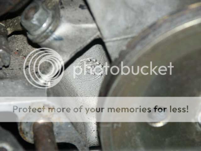

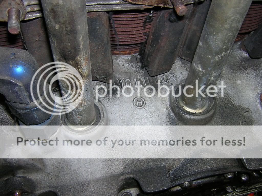

On the engine case, can you find the other date code on the other half of the case please.
If you cannot get a photo, please count the dots around the date. Also, what are the casting part #'s on the side of the case 101.xx & 102.xx?
On the transmission, what is the serial #? It looks 238xxx; that is a late one of the series.

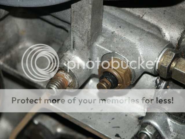

Your ‘no-number’ aluminum engine (below) has the temperature sender from the ’71 (120-300F).
What are the Porsche and VDO numbers on that sender?
You will want to change to the ’65-’68 (140-280F) version.

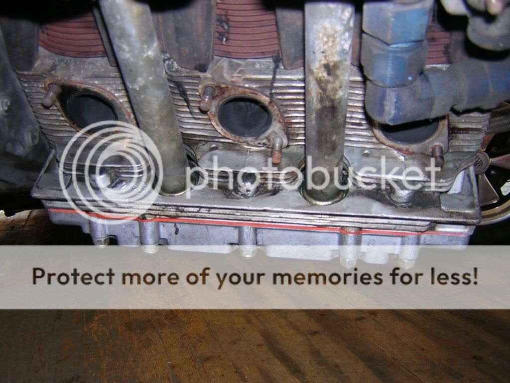

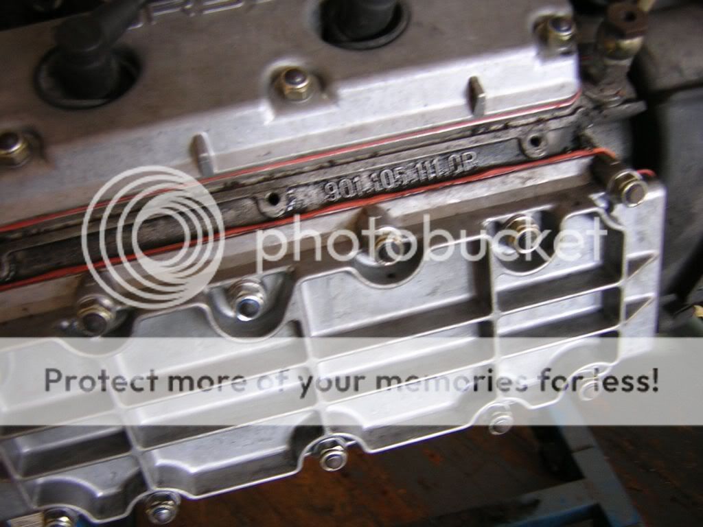

I'll get some pix when engine is in the stand for cleanup, right now it is kind of hard to reach for those pix. I do have some of the numbers though.
Engine cast # 901.101.102.0R
Cam housing # 901.105.111.0R
Gerbox serial is # 238130
Heads ... "through the shroud", all heads are 11-73 and with K1819 markings. 2.4 or 2.7 heads?
Right side case has 5 or 6 dots, whereas left hand has 6 dots, they are matched though, same number stamped on top of case halves.
The flywheel washer is 3 mm, the flywheels inner diameter was 225 mm, suppose I still have to get the right flywheel/clutch.
The MFI diagram was just resting on the bench, I will use double bendix pumps in the car. I think I have a complete 245mm fan setup from 81SC, using that pulley was a good idea, I never thought about that but it would spin faster then.

Old 03-11-2011, 02:19 AM
Grady Clay's Avatar
Location: Arapahoe County, Colorado, USA
Posts: 9,032

No engine number, type number or build number
Case casting dates: left 6/67, right 5 or 6/67 (June 1967).
Case casting numbers: left , right 901.101.102.0R
Parting numbers 971
11/73 head dates, (2.7 CIS?)
iron cylinders, (84 mm 2.2-2.4T?)
Mag chain covers and housings (original or update?)
Large cam oil fitting (original or update?).
Mag lay-shaft cover (indicating lay-shaft bearing shells mod?)
These questions are important to determine when Porsche changed (undocumented) the case to accept the later chain housings.

Okay, so the case is a very early "0R" version (I assume the other case half is 901.101.101.0R).
This came out at about build 10,000, very early in the 1968 model year production.
Any documentation on the case is useful.
Keeper of 356, 911, 912 & 914 databases; source for Kardex and CoA-type reports; email for info
Researching 356, 911, 912 & 914 Paint codes, Engine #'s and Transmission #'s

Took some time to get the engine in the stand, here are some more pix.
Heads from 69 I suppose? A big number 2, 69 and month 6.
