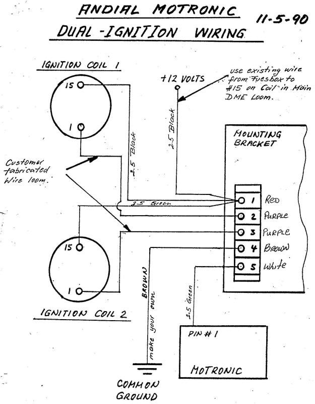

When you cut the signal #1 green wire at the dme plug that one goes from the dme to the #5 on the splitter.
Here is the original setup: you have one power wire (black) and one signal wire #1 (green) going to the coil. You use these two wires (one already hot) and make the green that you cut 12v and run them to the power side of the coils. You run two new wires back to the coils and make them the new signal wires from the splitter #2 and 3 on the splitter
Ground the splitter
Then power up the splitter with 12v
You only cut one wire in the dme plug, thats the #1 green
You have to strip back the harness further from the plug (where is dme wires go into the main harness) to pickup the original black power wire that works with the key
It should work.

Yes, the #1 Green wire in the DME loom is the one that is running to pin #5. It's just that on my splitter (on the splitter side), the wire color is green not white as the Andial picture shows. I'm sure it makes no difference, but want to be sure.
I'll take a picture of the set up and include it a little later.

I just pulled up an old picture of mine and my #5 is also green on the splitter.

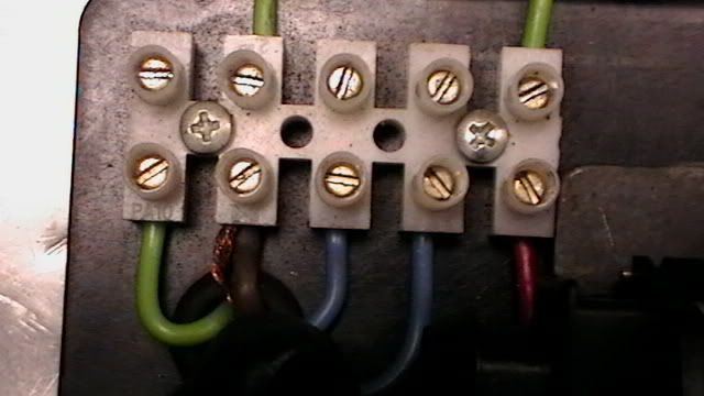

Here's a shot of the wiring I did.
Quick review...stock config is to have the +12V (in wire harness that sits on the floorboard to the left of where the driver's calf would be) to go to the #15 post of the single coil. I cut this and ran the upstream (end the goes toward the front of the car) side to the Red wire on the Andial splitter. The downstream side is still connected to post #15 of coil 1.
Found the green wire that ran to pin #1 on the DME control connector and clipped it in half. The upstream end (side that goes into the large/long DME connector) is now landed on the Green wire on the splitter. The downstream side (used to be on pin #1 on the single coil) is now connected to the Red wire on the splitter and the other side was moved to pin #15 of coil #2.
You can make out the black and white 14 AWG wire/cable I ran to the engine compartment (one black, one white) connected to the two Purple (they are more blue really) wires at the splitter.
My ground (which is the brown wire at the splitter) is running to the lug located on the front stud of the DME mount.
This all seems as the wiring diagrams prescribes. Correct?
When I turn on the ignition, the Red LED on the large box on the splitter turns on. The two ignitor LED's do not. Normal?
I took some Ohm measurements for reference. Taken at the connector on the splitter. Ignition off, bat connected, DME connected.
Between either Purple and Red=about 0.7 ohms
Between two Purples=1.2 ohms
Between Brown (gnd) and door jam=0.3 ohms
Do you see anything screwy? What else should I check?

Do you have two new wires running from #1 term on the coils to the splitter #'s 2 and 3?
What I did with my black hot wire was just T off it and run that into the splitter term #1 and also put the green wire that goes back to the coils in term #1 on the splitter and each of these wires gets hooked to term #15 on each coils.
I dont have led's on my ignitor.

Where is that black wire from thats hooked to the splitter #5 post? That should be the green wire from the dme plug..

#5 on the splitter (my black wire their green wire) goes to pin #1 on the DME (verified with a volt meter cont test 10 times, might check 20 times before I know for sure ).

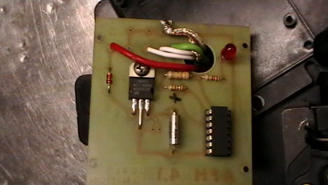

I took a peak at the parts on the splitter board as cgarr suggested and they all look brand new. All solder joints look great.
