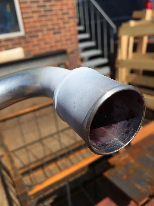

The new breather tank hose fittings are now with the plating shop (along with yet another bag of fixings that need re-plating....God knows where they all keep coming from). I turned a pair of adapters that Lewis then welded onto both a straight M30 tail (from breather tank to air intake), and a 90º M30 fitting (from oil tank to breather).
All welds were leak tested using the sprays below...of course, no leaks found, so off to the plating shop they've gone. I'll then go back up to Think Auto for them to crimp them onto the hoses.

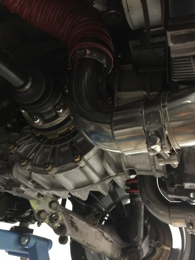

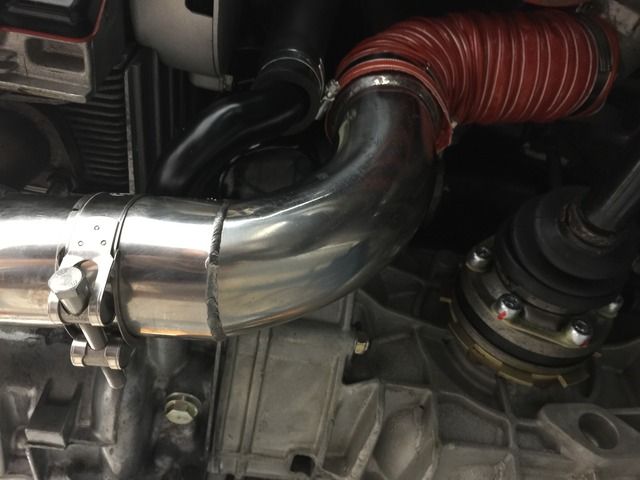

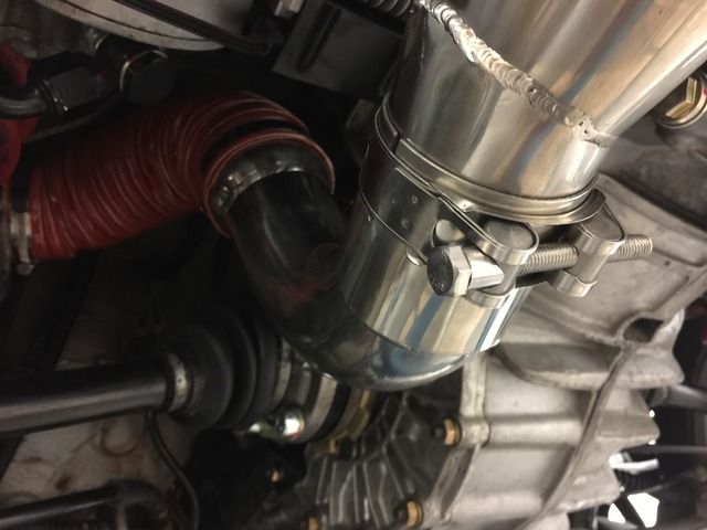

The silicon 1-ply ducting hose arrived this morning....cue drum-roll and blood pressure increase...and breathe. Finally, I've received the 76mm ID hose I need for the hot side heat ducting into the rear blowers.
All now cut to length and installed with new stainless jubilee clips, plus full stainless Mikalor clamps for the rigid ducting pipework onto the heat shrouds on the headers.

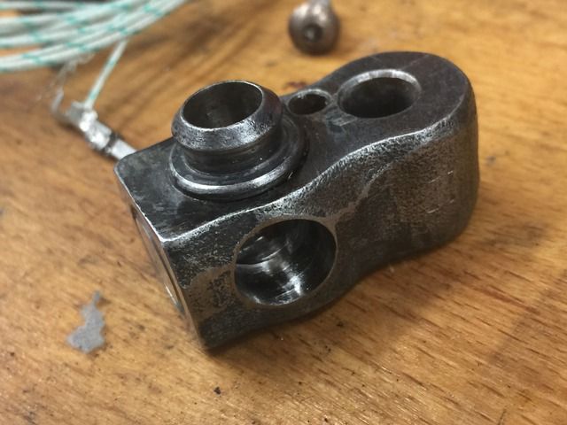

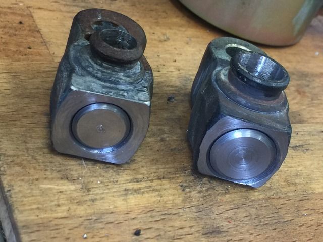

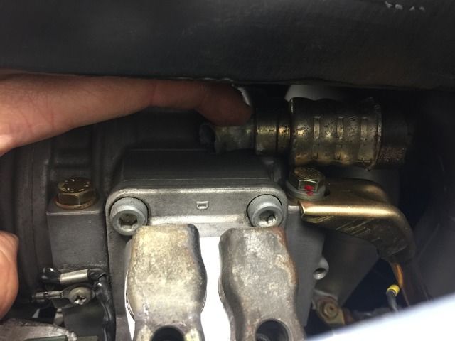

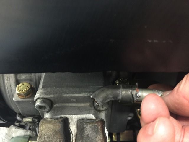

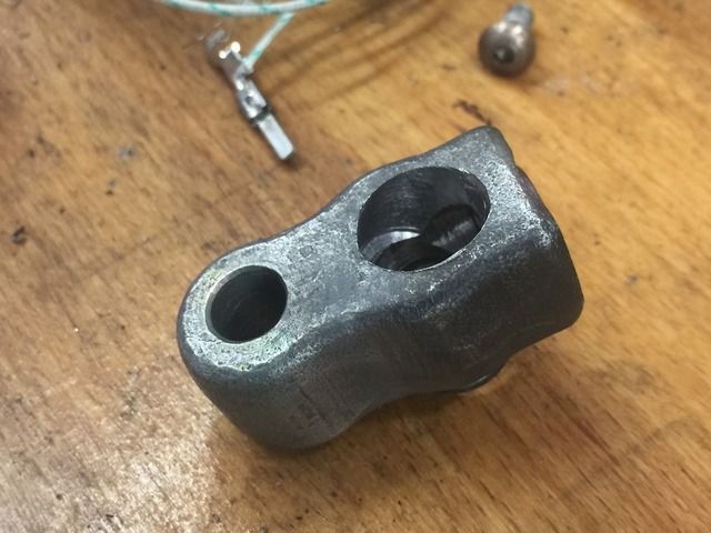

A quick lunchbreak tinker had me thinking about the AC lines again, and whether I could massively simplify the new lines project.
You may remember from a few months (and pages) ago, that one option is to buy from the US a pair of Denso > AN adapters, then use a pair of 90º AN fittings that are swaged onto the hoses. But, now that the engine is back in, I was a little concerned that the additional height of the 90º bends *may* interfere with the engine lid. Plus, more fittings = more opportunity for leaks. Of course, the additional time and cost (those adapters seem damn expensive for what they are) of getting them over from the US, on a punt, is very much my Plan B....so, my new Plan A....
Now that the old lines have been butchered to remove the lengths I need to retain (what I refer to as the Z pipes, that go into the inner wing and screw onto the lines which run to the front of the car down the LH side), it's left the other ends potentially redundant.
However....Looking a little closer at them, an idea I considered a few weeks ago struck me as feasible. I had a play to remove the old rubber hosing from one of them, and it got me pondering whether the outlet pipework was brazed into the "block" which bolts down onto the pump. If so, then potentially we can heat it, rotate to the new orientation that misses the IC, and re-braze or weld.
If it isn't brazed, and can't be persuaded out, then we'll just carefully cut-rotate-weld the pipework. That's the theory, anyway. Have left them with Pete for him and Lewis to play with. If successful, then Burgaflex can hopefully just swage new hosing onto them, job's a good'un.

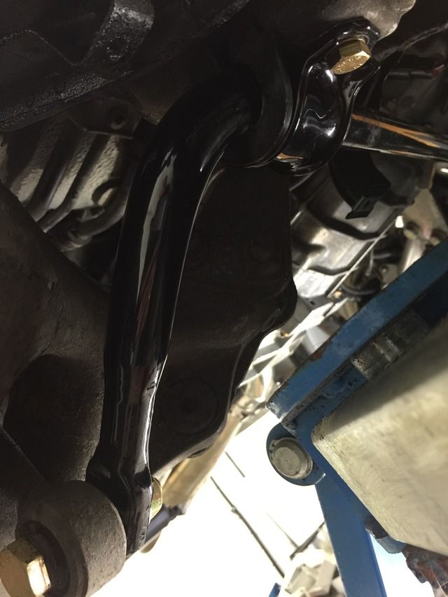

Last night saw the rear anti-roll bar get reinstalled; this was re-cotated in the very first batch of parts almost four years ago, so it was quite satisfying not only seeing another bag of re-plated fasteners disappear, but also 3 more items from my home office (which hasn't been used as a home office for, well, almost 4yrs...).
All installed beautifully, although I did start twitching when I had to re-assemble the drop links; they've not been removed from the car, thus are still looking their age (you have to draw a line somewhere.....apparently). This will be addressed as the often mentioned Phase 2 project, which is the far simpler suspension upgrade and refurb plan.

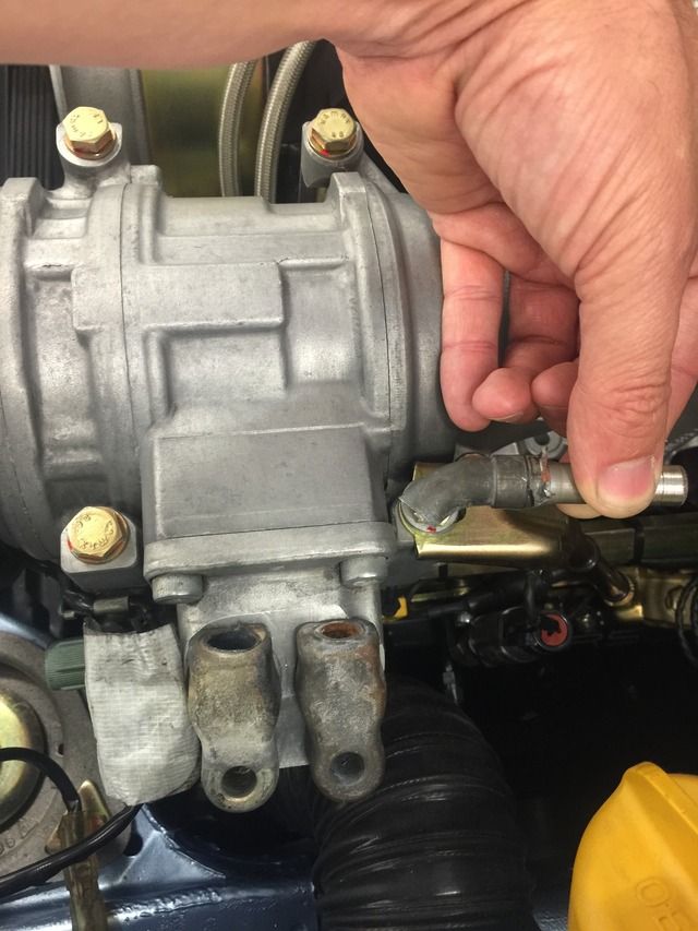

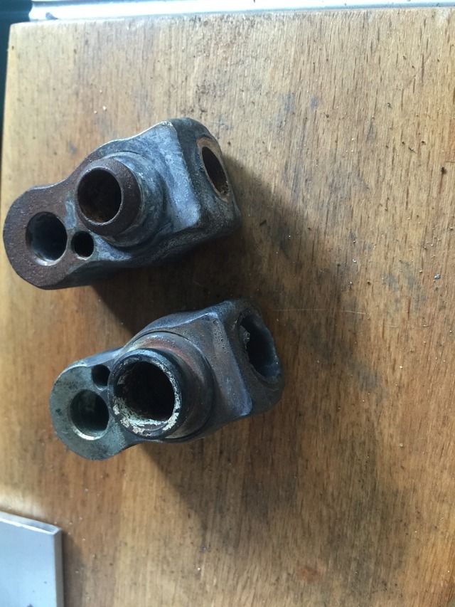

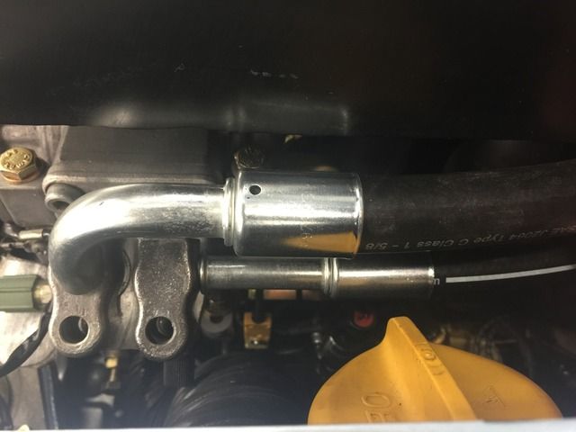

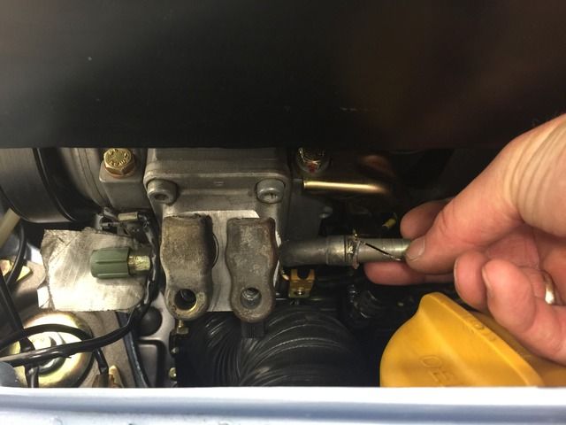

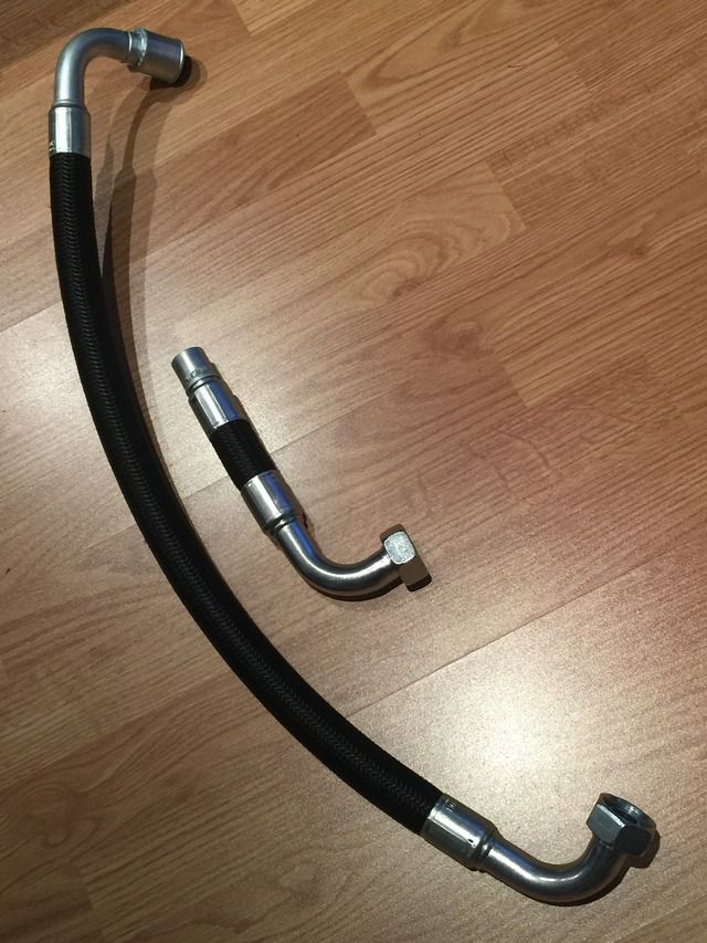

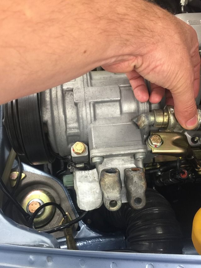

Spoke to Robert at Burgaflex, and we have a plan with the AC lines. After researching options that potentially use SAE screw on fittings, I think the height clearance to the engine lid is going to prevent this from being a good option, apart from anything else, we'd be looking at about $80 to get a pair of Denso adapters into the UK, then the cost of buying the wrong fittings, plus the time involved.
So, the plan as I see it, is to re-use the Denso blocks but modifying the inlet/outlet pipes to avoid the intercooler. Scabby looking but they'll clean up a treat, and will (of course!) be re-plated once modified.
http://img.photobucket.com/albums/v2...t/IMG_7310.jpg

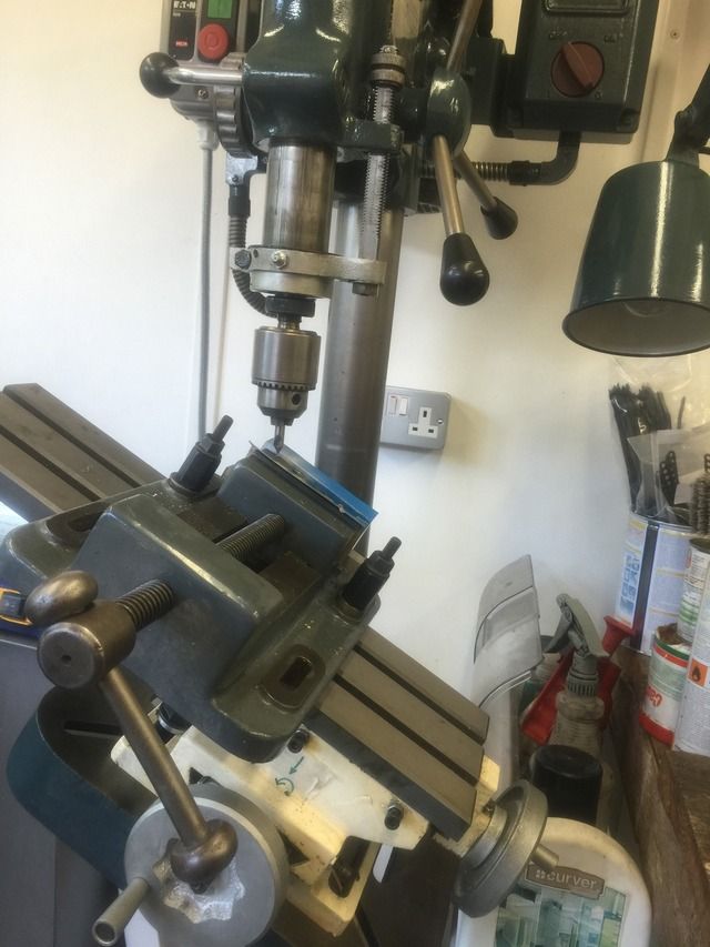

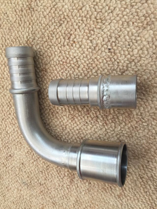

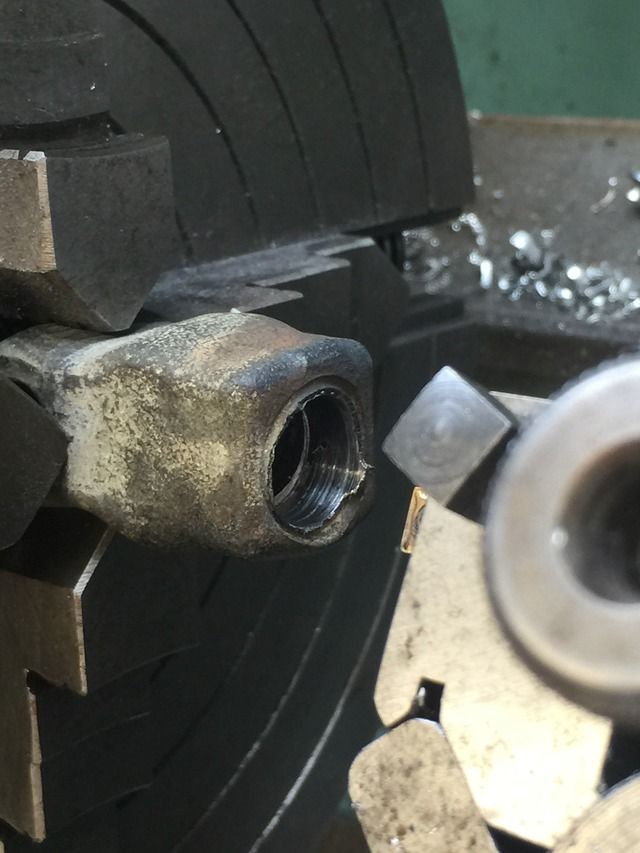

A week or so ago, I took the fittings along for Pete to have a go at heating; the pipework looked to be brazed or soldered in, certainly not welded. However, the fittings weren't playing ball, and one of them tore off when twisting.
My Plan B last night was to re-use the tails of the original hose fittings, i.e., the part sitting inside the hose and onto which the ferrule will be swaged, then order some 1mm walled mild steel tube in the correct diameters, and bend them myself. A simple case of welding at either end would then give me a bespoke fitting to clear everything.
However...there's a Plan C! Speaking with Robert, an easier solution would be to purchase a couple of 90º fittings, remove the nuts from one end (leaving the hose tail) and then welding these onto the Denso blocks....reduces the number of welds needed. A little neater and removes half of the leak risk.
The pics below show my thinking, albeit I was using the old tails to illustrate to Robert what I was looking to achieve and also what I was looking to clear in terms of hardware. I need to ensure that I don't obstruct the M8 AC pump mounting bolt; that could really ruin a day, should the pump need removing or belt tensioning.
Without the intercooler fitted....
http://img.photobucket.com/albums/v2...t/IMG_7312.jpg
http://img.photobucket.com/albums/v2...t/IMG_7311.jpg
Then with the IC installed, showing the overall window of space I have available...
http://img.photobucket.com/albums/v2...t/IMG_7313.jpg
http://img.photobucket.com/albums/v2...t/IMG_7314.jpg
For the pressure fitting (the smaller, inboard one), I can't decide whether to try and use another 90º coupling or whether to use a straight tail into the side of the block. Ultimately, I think it'll be determined by the bend radius of the pressure fitting and whether I can get it close enough to the Denso block so as not to impinge on that mounting bolt....
http://img.photobucket.com/albums/v2...t/IMG_7315.jpg
.....For the sake of a few pounds, I've ordered one of each.

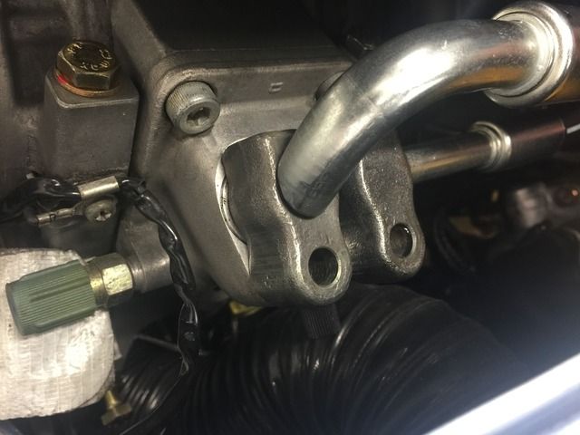

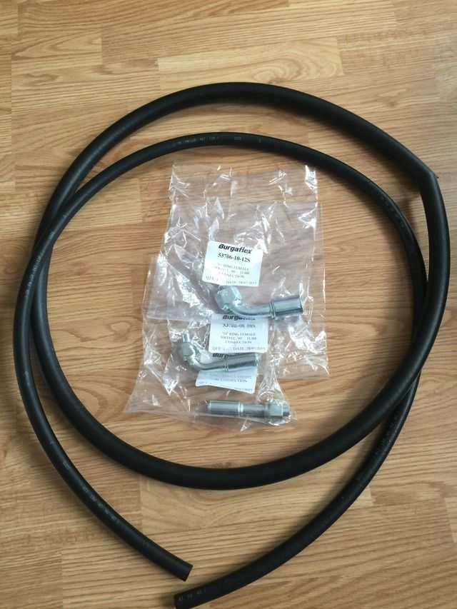

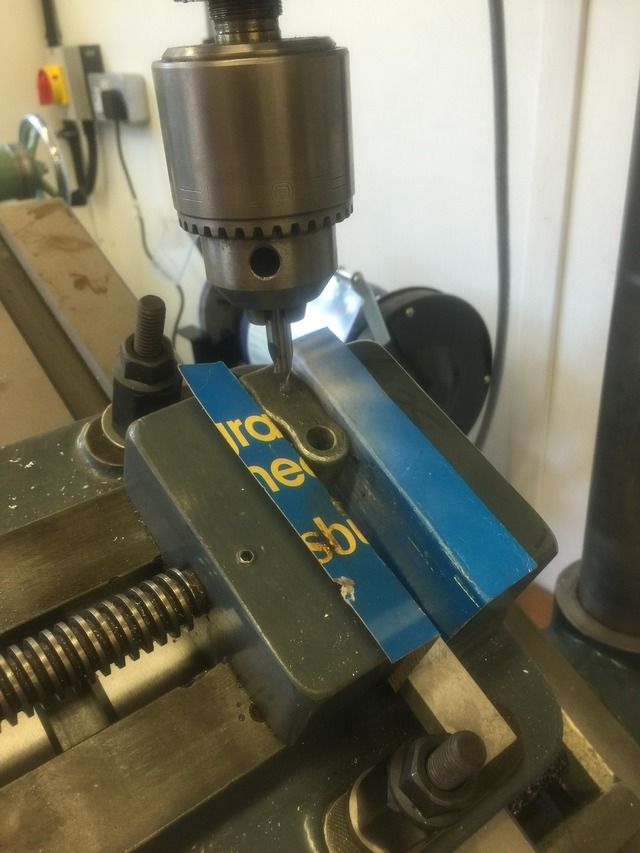

Huzzah! The AC fittings and hoses have arrived already! A look of confusion greeted the courier delivery man whilst I was wondering what on earth I'd ordered/forgotten about. Great service!
http://img.photobucket.com/albums/v2...E25A1FD4E9.jpg
http://img.photobucket.com/albums/v2...4ECE86344B.jpg
So, tonights job will be to start looking into how, where and what to drill and cut. Robert was absolutely correct when he said that the hosing "these days" is of far smaller and lighter construction. By comparison the older suction hoses are massive, heavy and very rigid. Measuring it, 29.3mm OD vs 23.5mm OD.
Finally we may be getting somewhere with this blessed AC sub-project!!

A small photo of my modified exhaust. :)
http://forums.pelicanparts.com/uploa...1438191288.jpg
Spenny_b 07-29-2015 01:16 PM
Ah no!! Nightmare mate. I know the frustration...even getting (what should be) very minor and insignificant jobs finished can become very tedious and soul destroying. My family do keep reminding me that this project should be FUN....stop beating myself up, there is no deadline for completion...not really....it's all just self-imposed pressure. So I do try and listen, take heed and step away for a day or three, then resume.
Love the headers....ceramic coating looks very clean...for the time being! ;) Have you also coated the piston crowns and combustion chambers/valves?

Evening everyone....some great progress this evening on the AC project.
First job was to tidy-up the Denso blocks, so that they can be welded closed. Into the 4-jaw chuck on the lathe, and carefully bored out to a depth of 6mm and chamfer the edge.
http://img.photobucket.com/albums/v2...47A9021C91.jpg
Next job, turn some mild steel bungs, with a chamfer on the outside face. Together with the bore chamfer, a nice weld channel should ensure good weld penetration.
http://img.photobucket.com/albums/v2...D963A53211.jpg
http://img.photobucket.com/albums/v2...F9C45E4A1E.jpg
Some pics showing how the new AC fittings will interface to the blocks. Mounting the suction (larger) hose fitting onto the back of the block was almost an option, apart from it would have to be cut so tight to the radius of the bend in order to avoid the mounting bolt for the pump, it didn't look quite as nice as the option I went for, which was a top entry on the block. As you can see in the pics below, doing it this way means that the two hoses now neatly sit above each other.
http://img.photobucket.com/albums/v2...710C2B6150.jpg
Suction fitting was then cut at the correct angle, then time to mount the X-Y bed and vice onto the pillar drill. The table of the drill was then rotated so that I could drill the new hole on top of the block at the same angle as the hose fitting....
http://img.photobucket.com/albums/v2...8988F40E37.jpg
http://img.photobucket.com/albums/v2...B802B5913B.jpg
...all turned out very nice, with a final cut to 13mm ID, matching the ID of the fitting.
http://img.photobucket.com/albums/v2...88E2317AA4.jpg
Next job was to drill the side entry hole into the block for the pressure line. Easy job, and I've retained the flange on the hose fitting, so that there's more metal to weld with.
http://img.photobucket.com/albums/v2...34A40845ED.jpg
Final positioning of the two hoses....
http://img.photobucket.com/albums/v2...6F274EDEF5.jpg
Next task was to start routing the hoses around the back of the engine. No pics of this yet, but the ally "Z" pipes have been repositioned and screwed onto the chassis lines. Against these, the ferrules were fitted to the end of the hoses in order to see where they're going to sit, relative to the hose retaining clamp on the rear firewall. Ally pipes then marked, rubber hoses clamped into position in said firewall clamp, and then cut to length at the pump end.
I may look into making a bracket that mounts off of the back of the power steering pump. Onto this, with a 90º return, I'll see if the hoses are flexible enough to pull down and be retained using a giant P-Clip. I'm not convinced it's actually needed - there's nothing that the hoses will rub against, and it's unlikely they'll move very much over that short length...it's just a tidyness (OCD) thing....
Plan for the weekend is to get the AC fittings over to Pete for welding and leak testing, then they can go to the plating shop for a quick dip.
