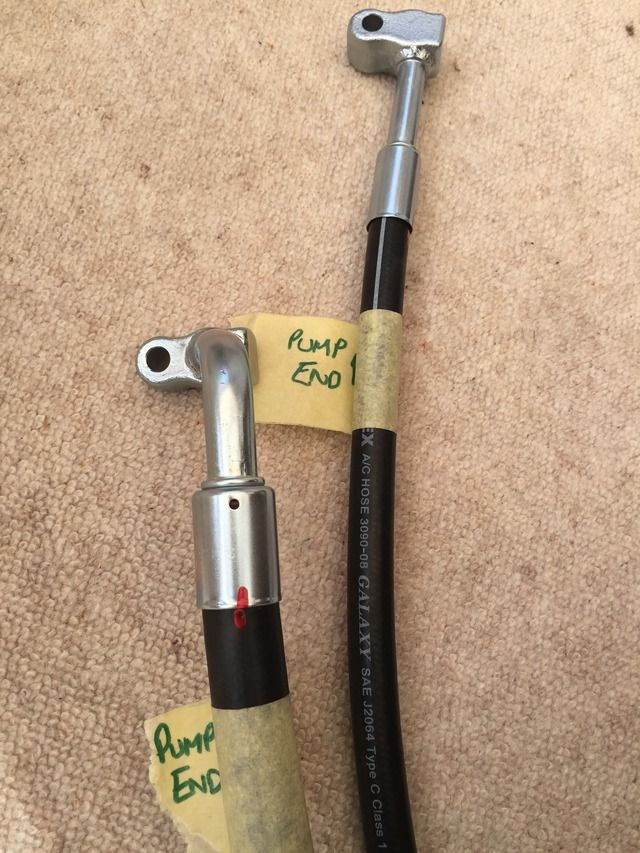

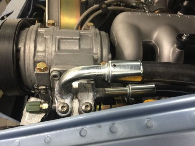

Mid-week(ish) update....

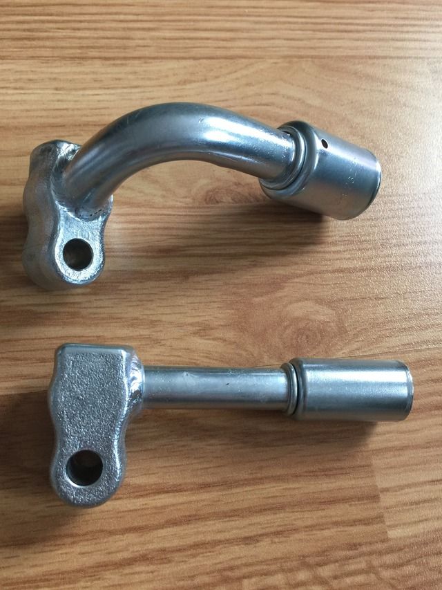

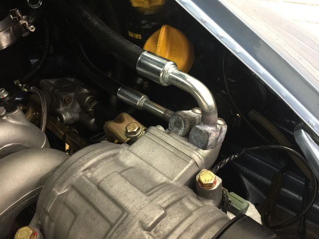

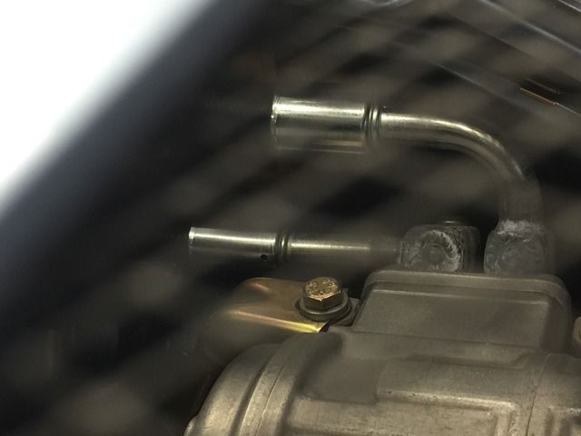

The AC fittings are now welded, collected on Saturday and leak tested. A fine job of welding, very neat indeed.
http://img.photobucket.com/albums/v2...566EBC6B2E.jpg
Some time spent filing the backs, where the bungs have been welded in, and radiusing the edges has made them look a lot more presentable.
http://img.photobucket.com/albums/v2...559BEB226F.jpg
Offering them up onto the pump, then running the hoses into the ferrules, and I reckon that's a really neat piece of routing...
http://img.photobucket.com/albums/v2...C9F698E36E.jpg
Doesn't interfere with anything, and more importantly, it clears all of the engine lid structure. In retrospect, this wouldn't have been the case had I bought the adapters shown a few months ago, then used SAE threaded couplings on a 90º elbow.
http://img.photobucket.com/albums/v2...11ACF1468E.jpg

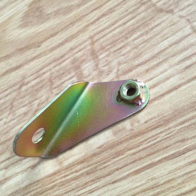

The new bracket that mounts on the back of the power steering pump to fasten the AC hose retaining clip onto...now mounted onto the pump and ready to go.
http://img.photobucket.com/albums/v2...13F559745F.jpg

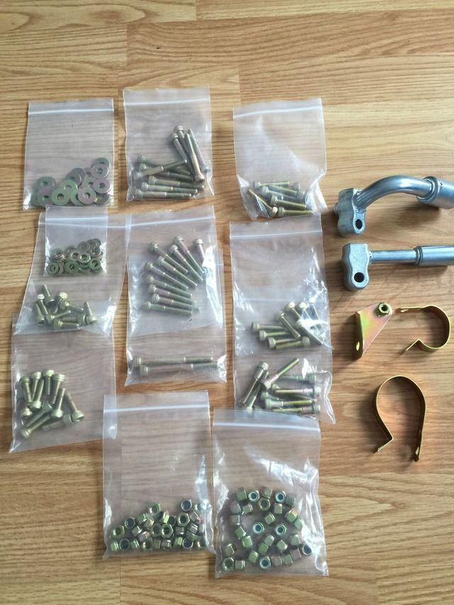

This evening, time to sate my OCD and swap over the BZP fittings for the newly coloured capheads and washers. Nice easy job, albeit some things are now really tight to get to.
http://img.photobucket.com/albums/v2...77F3789A55.jpg
http://img.photobucket.com/albums/v2...7015AB1BD8.jpg

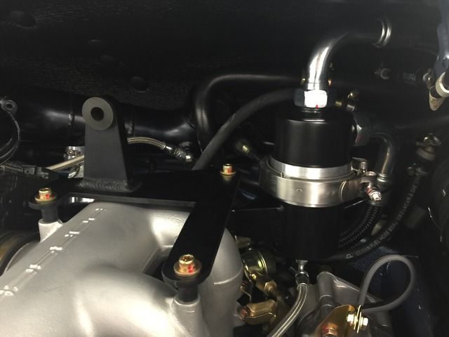

The oil-air separator tank is now fully connected to the 2x M30 breather hoses, and the oil tank breather now tightened onto the inlet to the separator tank. The outlet hose isn't yet connected to the silicon T hose on the inlet, see yesterdays comment about keeping that area free until the AC lines are back.

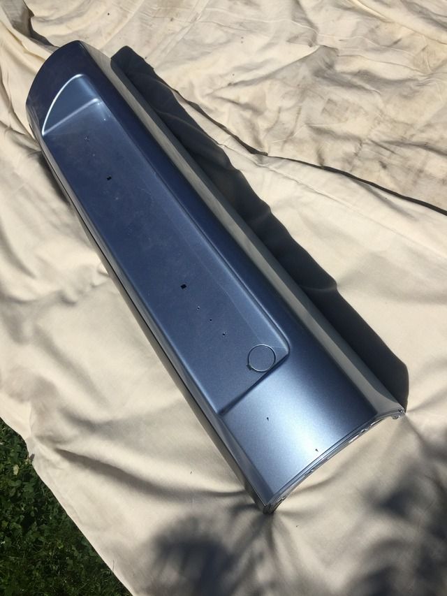

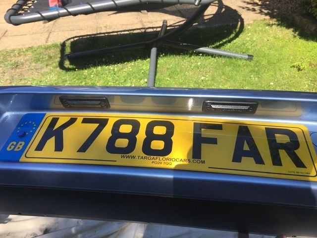

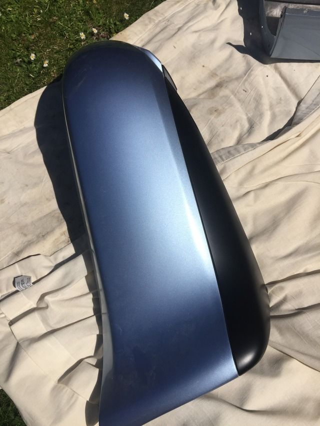

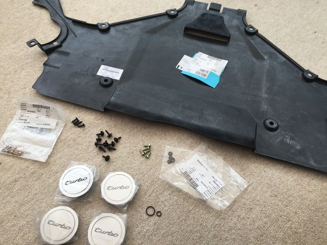

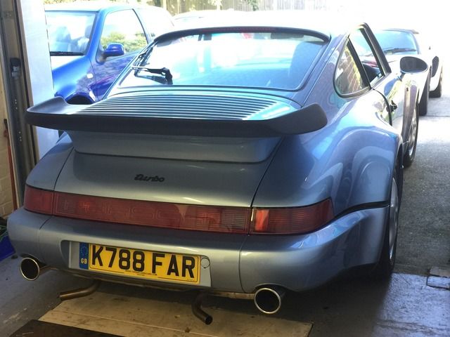

Good progress this weekend. I went up to my pal Shauns workplace to collect the rear bumper and headlamp rims, then spent the rest of yesterday working in the back garden, building it all back up again in the glorious summer sun. Surprising how long a job this is, bearing in mind that the structural part was already done....but getting the correct fit on the rivets, positioning of all the parts and brackets, etc really does take some time.
'Scuse the dust...
http://img.photobucket.com/albums/v2...5705C17E66.jpg
http://img.photobucket.com/albums/v2...D2E34B8DFF.jpg
http://img.photobucket.com/albums/v2...5E41E95578.jpg
The three elements assembled, this time without the over-complicated daft-arse M5 fixings at the top of the shell (the one's that always rust together and can't be undone without grinding....which then melts the plastic if not done very carefully (slowly).
http://img.photobucket.com/albums/v2...AD9ED9888C.jpg
Rear numberplate lamps installed, along with it's identity!
http://img.photobucket.com/albums/v2...74DF9C5360.jpg
There's a strengthening strip that runs along the bottom of the shell; this was then riveted on, then the shell married to the beam with more rivets on the top-side.

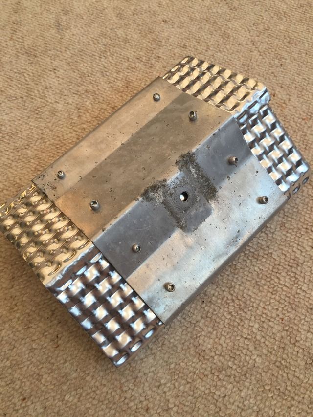

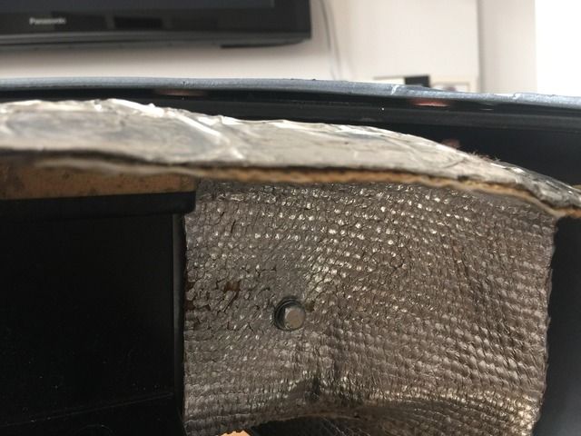

The factory "heatshield" for the turbo was a job I've been meaning to get around to for a while. Using new bracketry and clips (there's a pair of brackets that hold the bottom of the outer bumper shell to the structural beam. Onto the LH bracket is mounted the rudimentary bent piece of aluminium), I had just enough of an off-cut of the proper heatshielding material I used a few months ago, to insulate the engine from the turbo/silencer. This time it's a fair bit larger L>R and still plenty of clearance around the GT35R....
http://img.photobucket.com/albums/v2...865C3AC31B.jpg
http://img.photobucket.com/albums/v2...4A8FE55A8F.jpg

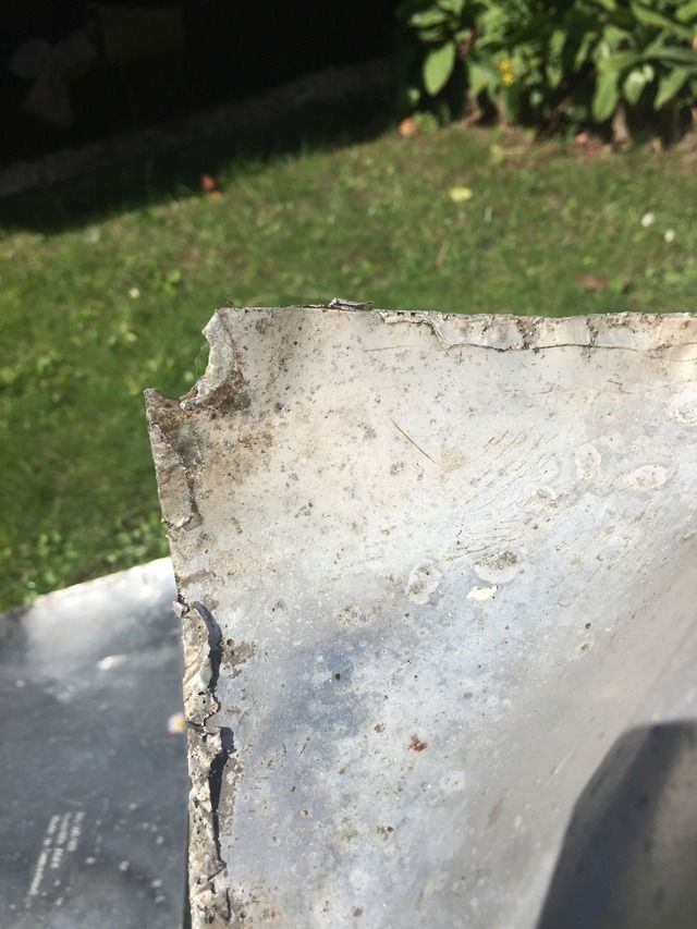

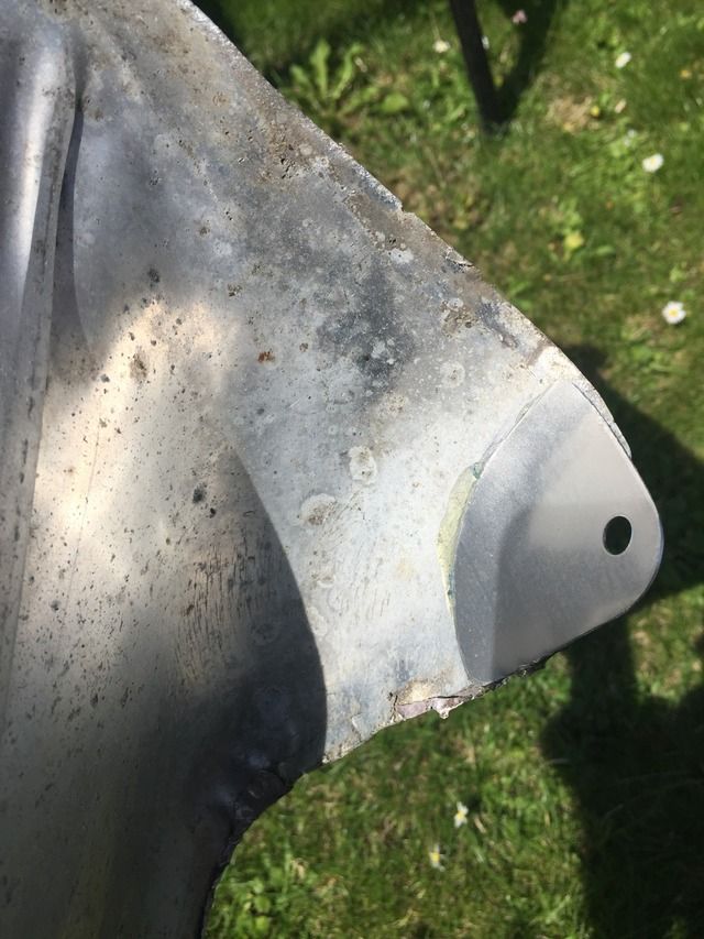

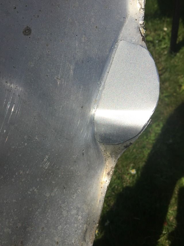

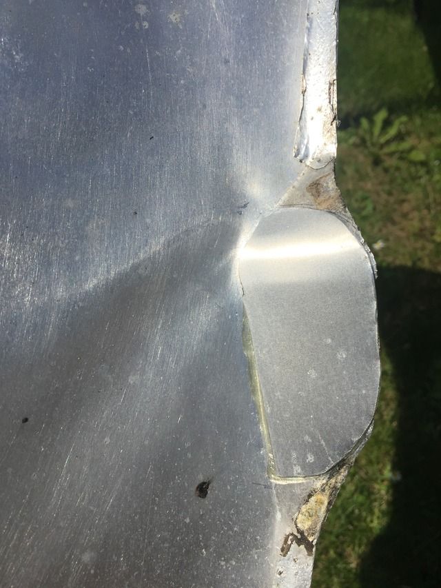

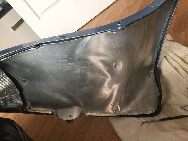

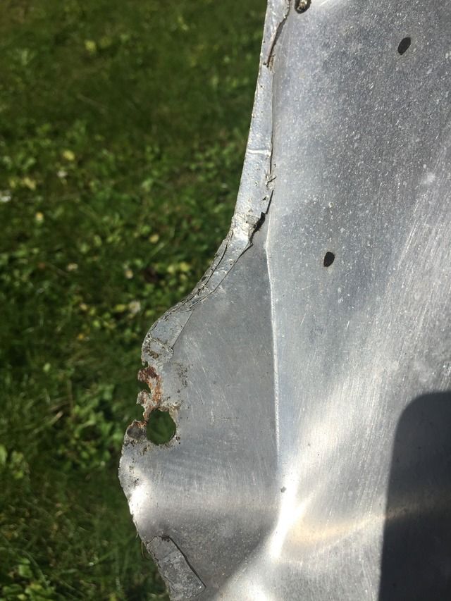

Todays job was to repair the LH and RH flanking heatshields that install either side of the beam and main heat reflector. 18yrs of use have taken their toll on the thin ally mounting holes, where they're now extremely brittle or non-existent.
http://img.photobucket.com/albums/v2...328FF98A45.jpg
http://img.photobucket.com/albums/v2...CDB2B84151.jpg
http://img.photobucket.com/albums/v2...92EC4EF50F.jpg
...so, some digging around in the offcuts bin, and I found a nice thin gauge section of ally to then make some repair sections with (and yes, if I wasn't now trying to control costs, I'd be buying new, but you just know these are going to be damn expensive)...
http://img.photobucket.com/albums/v2...017D729C15.jpg
http://img.photobucket.com/albums/v2...BB2608A84F.jpg
http://img.photobucket.com/albums/v2...0741B6F50F.jpg
While the epoxy was setting on the heatshields, time to install the reinforcement ribs that run on the underside of the top edge.
http://img.photobucket.com/albums/v2...08922F7483.jpg
When I was sorting out the fixings, I saw the fibre washers and thought it was a bodged installation at some point in the cars life, as there's no mention of these parts in the PET. However, when reassembling, it's pretty obvious that they are required to avoid distorting the plastic when riveting the strips in place.
http://img.photobucket.com/albums/v2...B6ABECFE30.jpg

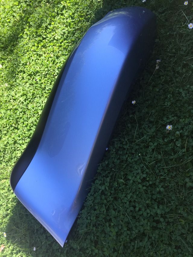

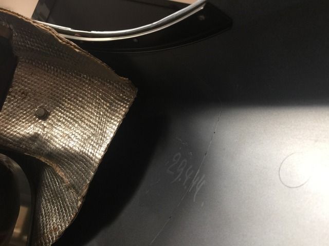

A quick install of the shields to mark hole positions, then time to fit them permanently with another couple of rivets along the top edge....
http://img.photobucket.com/albums/v2...B92DF12669.jpg
http://img.photobucket.com/albums/v2...8A7F93553D.jpg
At this point, I confess to getting a little antsy about the colour match to the bodywork! A lot of work to undo if it's not correct. Finally, time to enlist the help of my mate Ian, carefully carrying it through the house, workshop and garage....not the time to be tripping over the (far too untidy) skunkwerks.
And it's on!! NOW I feel like I've got my 964 back! And the colourmatch is perfect (knew it would be ;) ) Exhaust pipes aren't aligned yet, but one thing I did notice is that one pipe sticks out further than the other. I know why - it's to do with the angle of mounting of the turbo unit, which in turn has thrown the angle of the silencer relative to the back of the engine - perhaps only 1-2º, but over the length of those tailpipes, it's now about 10-15mm different in protrusion. Thankfully, they're both really easy to remove, so I'll have a final measure, then get Pete to wave his magic TIG wand over it.
http://img.photobucket.com/albums/v2...C8D5764FC7.jpg
http://img.photobucket.com/albums/v2...3B2D0F852A.jpg

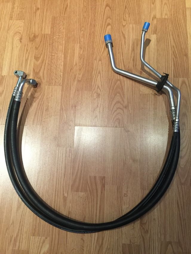

Spenny_b 08-11-2015 03:37 PM
Evening folks, another major item is now officially off of the To-Do list!

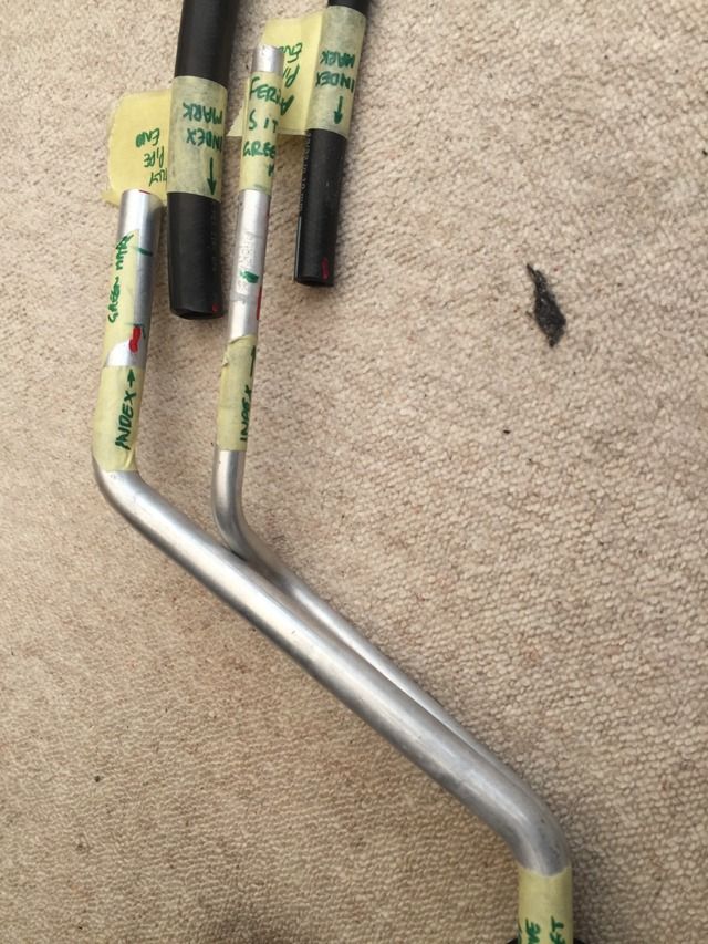

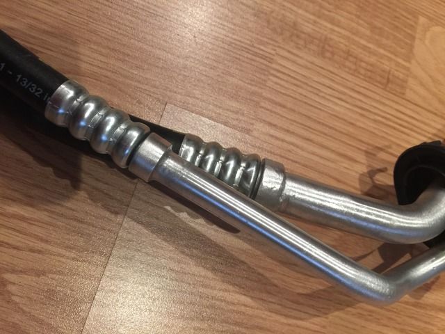

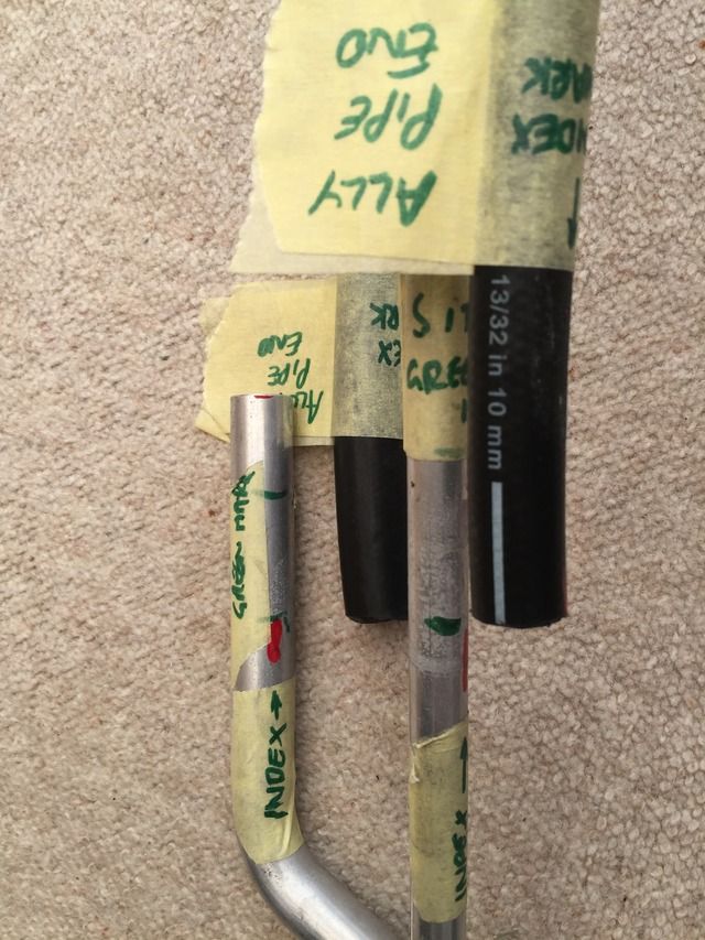

The AC lines arrived back from Burgaflex up in the north of England. I confess to being pleasantly surprised when Robert emailed me at 7.30 yesterday evening, letting me know that they had been assembled and shipped that day on an overnight courier.
http://img.photobucket.com/albums/v2...CB8DE7F9DD.jpg
The connections onto the "Z" pipes; looks to be some welded on swage fittings, very neat job...
http://img.photobucket.com/albums/v2...528350A0BB.jpg
I've been in London all day today, and have got a very early start tomorrow, with a chunk of work to get done between now and then....so....only a very quick play in the garage this evening, but enough time to get them installed.
http://img.photobucket.com/albums/v2...C4C15ACCD5.jpg
They're absolutely spot-on....no twisting on the hoses, no persuading of anything, they just fitted straight in, as planned. The hoses are now fixed to the rear bulkhead, routed behind all the engine breathers and over the PS pump, through the new retaining clip/bracket and onto the pump.
http://img.photobucket.com/albums/v2...6AC69ED350.jpg
It all looks so damn simple in hindsight, but it really is one of those jobs that's been niggling me for a couple of years, things like how to route the pipes, will it foul anything else?, can I source the connections?, can I find somebody in the UK to actually make them?, what if "this?, what if "that"? And of course, you have to work sequentially on this, it's no good going at it like a bull in a china shop, everything else has to be in place and finalised before committing to an idea.
And now it's done. Finished. Once the fire extinguisher lines are run, the intake system can then go back on and the intercooler installed. That's then the engine bay finished.

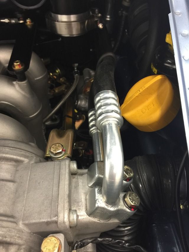

Pat RUFBTR 08-13-2015 11:54 AM
You work great well Spencer, I adore!!!

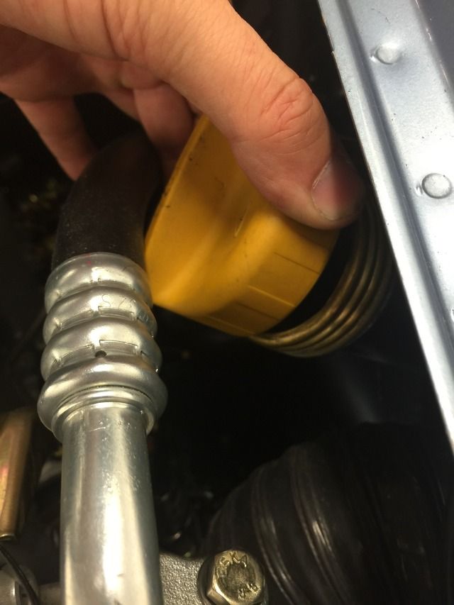

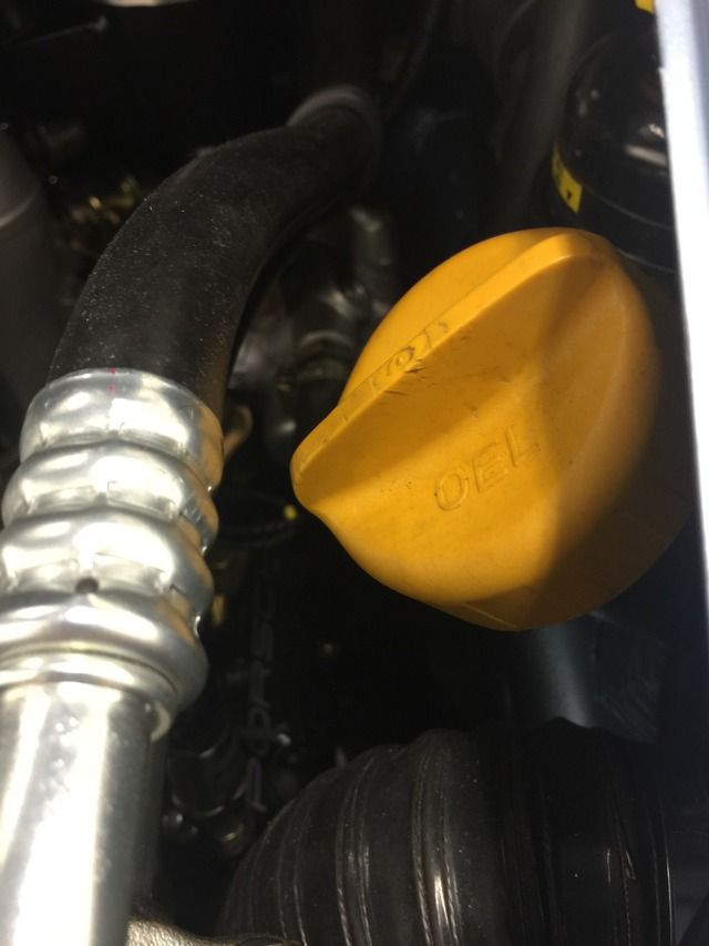

I have a question, you is hampered(bothered) by the tube to open the cork of yellow oil?

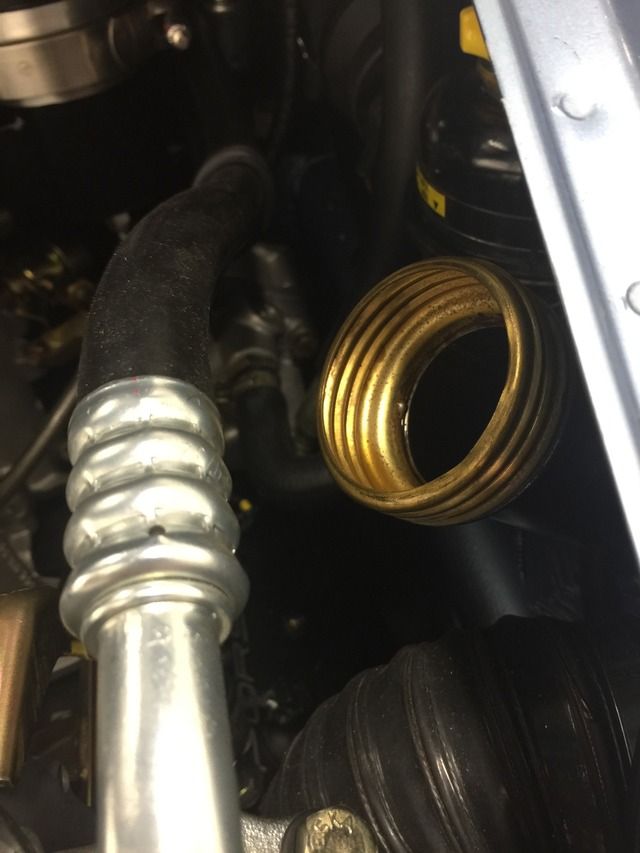

Spenny_b 08-14-2015 04:30 AM
Originally Posted by 304065 (Post 8750818)
This is one of those things that will make the cognoscenti go "What?" when they look in the engine compartment. It looks so perfect, so Factory, like it came that way, but in fact represents one heck of a lot of thinking, planning, and execution.
Making the difficult look easy. . . the hallmark of true professionals.
Carry on!
As ever John, you're too generous with your very kind comments (and thanks also Fred)....I'm merely an enthusiastic, OCD-suffering tinkerer. I don't consider anyone to be a professional engine builder unless they can talk fluently about things like parts interoperability and being able to offer thoughts and opinions on how to go about putting together a specification to meet a certain objective. And be able to back that up with a through explanation on the underlying principles of that recommendation, rather than a blatant duplicate of others proven recipes.
I do, however, consider myself a professional spend-thrift!! Friends and colleagues are now starting to ask how much I'm in this project for....and frankly it's more than I bought my first house for....just for this project, not including the car itself. That gets a little embarrassing to be honest, it's only us crazy few that understand the financial and emotional commitment to "the cause".
Spenny_b 08-14-2015 04:45 AM
I knew somebody would ask me this!! I ought to have known it'd be you Pat!! :D ;)
Yeah, it's not a problem at all - most certainly something I was careful to consider when re-making the Denso connections. It's very comfortable in terms of being able to remove the filler cap and then getting a funnel into the neck of the filler tube....
http://img.photobucket.com/albums/v2...57348C7D0B.jpg
http://img.photobucket.com/albums/v2...781FCF408B.jpg
http://img.photobucket.com/albums/v2...2B3F7CE5CC.jpg

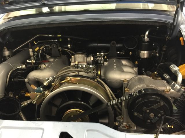

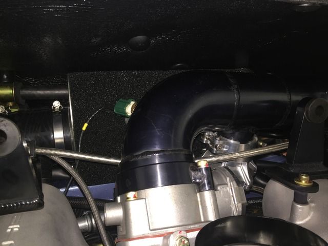

A quick lunchtime update....

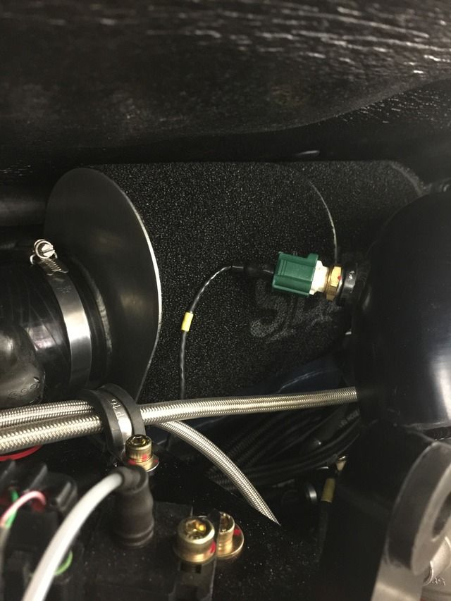

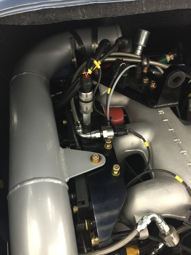

The AC lines are now in, and I had the cunning idea to secure them to one of the 3 studs on the rear firewall using the same tether ties that the wiring loom is secured with around the engine bay (the ones that push onto the threaded studs and have holes along their length to determine their fit). Up until now, 3 x plastic buttons to secure the sound pad was a tad excessive, so this was a great way to get them tight to the bulkhead and clear from the air filter.
The filter was then sprayed with the dust retention oil and thoroughly worked into the foam cells. The only way to squeeze this into the back of the engine bay is to undo the pressure take-off line that runs to the sender for the OBC boost gauge....easy enough, and allows the cold charge pipe to be swung out of the way.
Filter now installed and tightened into position.....everything fits like a glove, nothing fouls the filter so there should be no airflow restrictions. Can't quite believe it....with the new hoses that weren't originally planned for (the oil tank breather) and the AC lines now in place, nothing is in the way, and it all remains serviceable....quite chuffed with myself!
http://img.photobucket.com/albums/v2...24DE1178AC.jpg
http://img.photobucket.com/albums/v2...0F8456895B.jpg
The intercooler is now back in place, although final mounting cant be done until I receive some stainless P-clips to retain the oil and fuel pressure senders.
Engine bay is tantalisingly close to being finished....

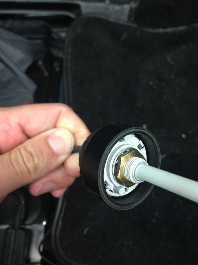

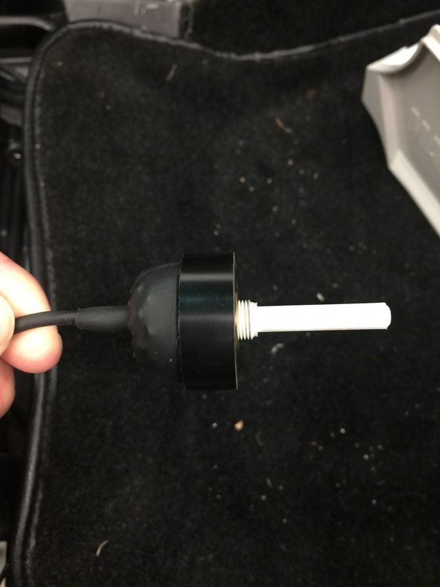

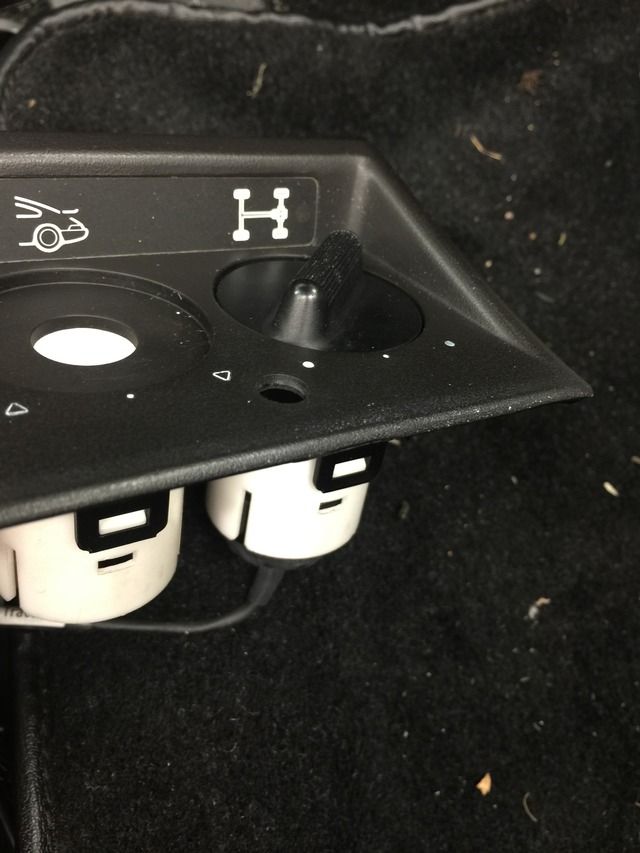

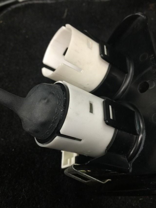

Have made good progress on the installation of the traction control and variable boost controls. If you remember, I'm re-purposing a Carrera 4 panel so that it looks bone-stock. I made a lot of the adapter rings up a good while ago, but with the Raychem boots on the back of the switches, the plan looked to be out of the window. I made some rings that were a snug fit over the OD of the rotary switches, and a snug fit on the ID of the white plastic tubes that are part of the C4 panel assembly, however, the heatshrink boots were glued over the OD of the switches. At this point I thought I was going to have to permanently bond the switches into the tubes; far from ideal. With some careful cutting (God the Raychem boots are hard!...no fear of anything penetrating them!), I've now exposed enough of the switch body. The plastic adapter rings are now bonded onto the switches....
http://img.photobucket.com/albums/v2...E41864CC17.jpg
http://img.photobucket.com/albums/v2...19F25EBAD2.jpg
....and are a perfect fit inside the tubes.....
http://img.photobucket.com/albums/v2...C38836F107.jpg
The spindles of the switches are the perfect length to mate into the adapters that the switch knobs fit onto, albeit I'm re-using one of the 3x holes that are usually loaded with a ballbearing and spring. An M5 tap and a grub screw will ensure that these spindle adapters are locked onto the flat of the spindle itself.
All that needs to be done is seat the switches to the correct depth and lock the spindle adapters, then orientate the switches in the plastic tubes, to make sure the knobs align to the legends on the panel. Easy!

Following that, on the same harness is the output from the ECU for a shift light (although I'm pretty sure I wont need/want this) and then signal feed from the Stack boost gauge, which we built into the engine loom for neatness. So, once that's connected I just need to route a +Ve and Gnd feed to the gauge itself, and it can be installed permanently.
Back onto the chassis, more parts which I ordered before going on holiday have arrived....completely unremarkable apart from the total price of >£270!
http://img.photobucket.com/albums/v2...2DC1BBA79C.jpg
Back when I was on motorbikes, there was a theory that said Japanese bike plastic was more expensive (gram for gram) than gold....I'm pretty sure German plastic and fasteners aren't far off either! Anyway, the correct gearbox cover is now here, no snapped tangs or mounting brackets.
Wheel centre trims - argghh - nothing is bloody easy on this car. They should be a slam-dunk easy part to order and fit, yes? Nope. The fronts snap into place fine but the rear ones won't seat correctly....clearly a different spigot dimension, as when I checked my German copy of the PET (rather than the US one), it has additional descriptions for "M402" and "M403"....16" and 17" Cup Wheels respectively. Although that then begs another question....they never fitted 16" Cups onto the Turbo, so why would there be a "Turbo" inscribed centre cap for a 16" wheel? God knows. Got grumpy last night and went and watched TV. I'll remove a rear wheel later and have a look from the inside.
A/C O-rings are also wrong, FFS. That's another job I cant quite cross off the list.
Before going on hols, I received a metre length of black single ply ducting hose, for the front bumper ducts. I'll take pics later, but again, was disappointed to find that instead of receiving the 85mm ID hose I ordered (yes, the same "hose prats" that have cocked up every order so far...), I got 80mm....not even the more common 83mm. Was about to maul somebody over the phone but thought I'd try it anyway, gently reshaping into an oval and pushing it over the duct outlet....lo-and-behold, I reckon I can make it work ;) Just need the rain to abate for a few hours one evening so I can pull the front PU off and try a few things.
