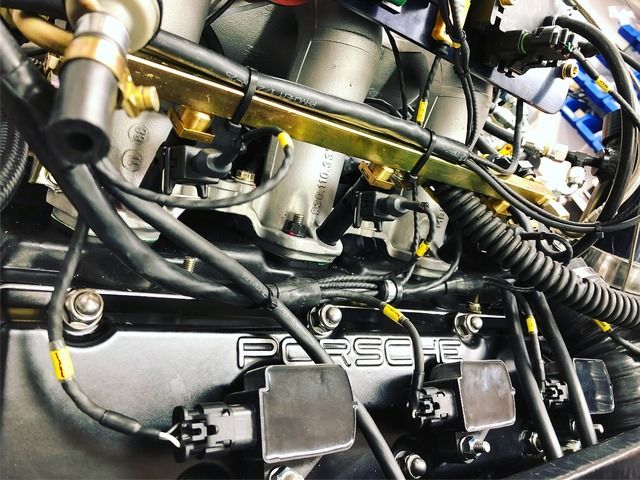

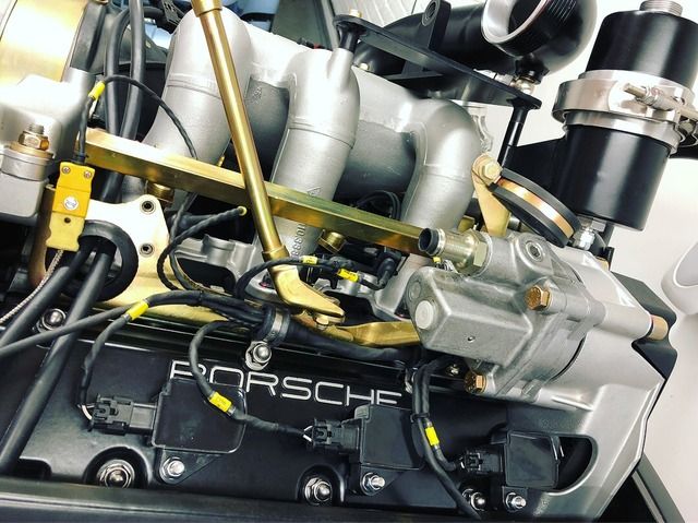

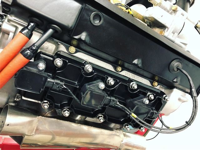

So, steady progress just crossing off those to-do list items. Monday was a great Day #1 of my vacation week, getting a lot of the stuff done that I can - other items needed me to have the anodised water parts back before I can sensibly tackle them. Thankfully a phonecall into the plating shop and I was on my way over to collect them on Tuesday.
Off the top of my head, Mondays work:
  • Spark plug indexing spacers are now all done.
  • Valve covers now on with the Wrightwood gaskets and some very smart (IMO) domed nyloc M8 nuts. I know it's not factory original but seeing road grime on the exposed threads irritates me somewhat.
  • Coil-on-Plugs are now installed - unbelievably solid on the posts that I've made that mount it to the valve covers. Very pleased with that.
  • The new radiator support arms and water pump support assy is also now mounted.
  • The water expansion tank is now permanently installed; the F/F isolating rubber mount I was waiting for arrived as hoped.
  • Turbo oil drain tank is now back on
  • New sleeving on the scavenge hose that pulls the oil from the tank; just a smaller diameter, looks neater.
Valve covers on, radiator pump supports in place, CoP's installed:

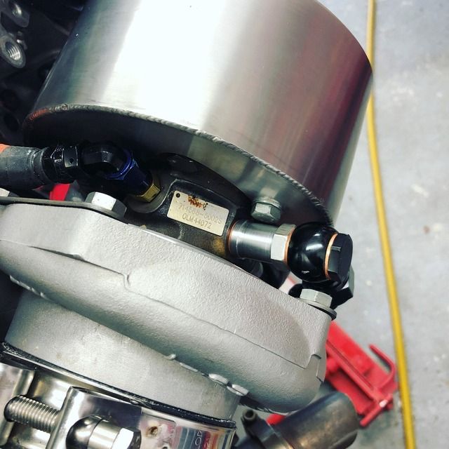

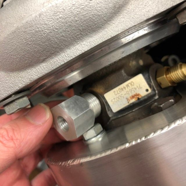

Wednesday day was just a frustrating day in the workshop. As mentioned, I got the anodised parts back, all's well with the quality...
http://img.photobucket.com/albums/v2...d/IMG_2463.jpg
But then it was time to re-assemble everything and it should be "job-done" right? Nope. The engine goblins have been playing, and what I took a lot of time to make sure fitted before stripping it down, now doesn't re-assemble correctly. I've been struggling with clearance of water cooling fittings on the turbo versus the turbine shroud hex bolt fasteners, versus the -10 oil drain fitting; I can absolutely see why hard lines are used for this rather than hosing.
After much scratching of head, and switching around of the -8AN straight/135º connections, I've arrived at the answer.....I need to make a 25-30mm stand-off for one of the banjo's.
The rear banjo is fine - which is good, because space behind the turbo is really tight to the turbo mounting flange. This hose now has a straight fitting to drop it straight down, missing the oil drain line.
The oil feed line can (I think) stay as it is, albeit it's an absolute sod to install the 90º -4 fitting onto.
The oil drain line now needs to be re-made. It's quite a lot too short now that the CHRA has been rotated. I may play with this again, but I am debating the merits of keeping the CHRA with a 20º upward angle. The Garrett whitepaper says that there are benefits to be had with natural syphoning of water through the housing, even without the engine running (and water not being pumped)...however, I'm sure this is intended for cars that are plumbing a turbo into an existing, large capacity and mechanically pumped water circuit. With my setup, I'm not sure that water could be drawn through a static electric water pump. I'm pretty sure that we can achieve the same outcome and keep the pump operating post-shutdown using ECU control.
Anyway, the parts that are re-assembled - to be fair, it's most of it - does look very nice in my opinion; I'd like to think it's more towards a factory look and not a thrown together "DIY" lash-up!
http://img.photobucket.com/albums/v2...d/IMG_2469.jpg
http://img.photobucket.com/albums/v2...d/IMG_2468.jpg
So, this spacer. Well, this is needed for the front water fitting. I'm going to have to make this myself, probably out of ally hex stock. M14x1.5 male thread at one end, and M14x1.5 female thread at the other. Approx 30mm long, with a waisted diameter at it's base, so that it can clear the wretched hex setscrew head....a bit like this one, which I happened to find in one of my parts trays (but is too short to rework/repurpose):

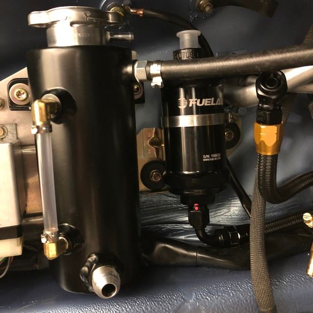

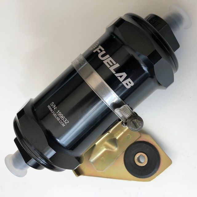

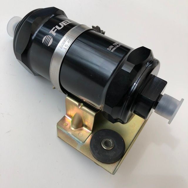

In other news, I've taken this opportunity to install a deluxe fuel filter while the engine is out. I need to switch some fittings on the fuel hoses from metric to JIC, not a major job. The Fuelab 10um filter unit should also arrived yesterday. I thought I'd need to fabricate a new bracket, as it looked a fair bit smaller in diameter to the stock unit, but actually it fits beautifully with a thin piece of rubber glued to the bracket to prevent slipping and scratching. An hour or so switching over the fittings, and it's now in place looking rather smart....
http://img.photobucket.com/albums/v2...d/IMG_2483.jpg
http://img.photobucket.com/albums/v2...d/IMG_2480.jpg
http://img.photobucket.com/albums/v2...d/IMG_2482.jpg
Really am just waiting for the tap and die to arrive, to make that spacer. Weather is too wet to roll the car outdoors and fit the ECU harness through the interior. I suppose it's a good sign that I'm now at a bit of a loss as to what job to do next! Silencer and flywheel/clutch are jobs for when the engine is off of the stand....

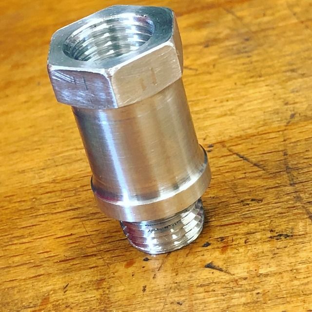

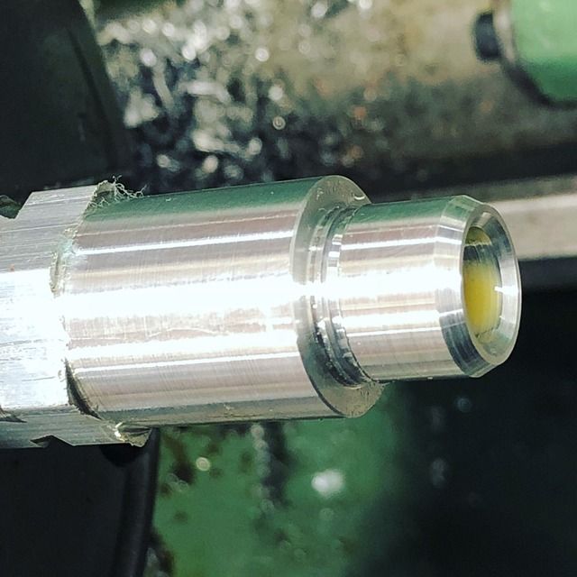

I also started making the new front water port spacer....
http://img.photobucket.com/albums/v2...d/IMG_2492.jpg
http://img.photobucket.com/albums/v2...d/IMG_2491.jpg
An undercut to allow the die to not leave a shallow thread at the end, and also keeping a shoulder for the copper washer to locate onto. Hoping the tap and die arrive in tomorrows post, then I can finish this little job, and get the water system completely finished.

This mornings work was more positive; the M14 taps and die arrived (only for me to get the tailstock die holder out...and find an M14x1.5 die already in there! Doh. Of course, I was making ally blanking plugs a few months ago, but unusually, I hadn't stripped it after use and replaced it in my taps and dies drawer. That'll teach me).
The spacer for the turbo coolant port is now finished; not the tidiest piece of work I've done, but functions fantastically, nice and strong, and clears everything it needs to.

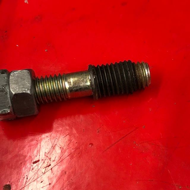

....however when re-fitting the exhaust headers, three nuts from finishing it, the stud on #5 stripped. I thought it was strange that when undoing the headers, the stud came out rather than the nut coming off. All of the studs were new and Loctite'd with red 263 threadlock, after we drilled out the snapped studs a few months ago. There was one stud that was a little problematic; in trying to clean the thread it kept snagging, locking the tap. I guess it removed just a little too much thread material and it's now ripped.
http://img.photobucket.com/albums/v2...d/IMG_2540.jpg
http://img.photobucket.com/albums/v2...d/IMG_2539.jpg
So, time to remove the headers AGAIN, and fix it with another Helicoil. I took the opportunity to also Helicoil one of the studs on #4, which had also unscrewed. The thread in the head was looking "less than optimal". I then also noticed (!!) that #2 needed attention; this was a stud which was snapped when I bought the car, and was "fixed" using a Timesert as one of the first jobs I asked a specialist to do. Clearly it hadn't been installed as well as it should've been, as the Timesert has unwound itself when trying to undo the nut; the crush nut clearly offering more resistance than the Timesert locking feature.
http://img.photobucket.com/albums/v2...d/IMG_2543.jpg
So, a third Helicoil required. All very easy to do with the engine out....a pig to do in-situ, so thankful I found the issues now.

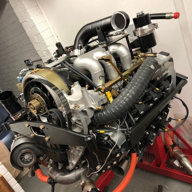

Finally last night I was able to refit the heatshielding that sits behind the exhaust silencer, and then the front tinware apron. The shield needed a little reworking, as I'm now using the TK turbine shield on the turbo, and now looks neater with that rework.
Looking good, I think we're now ready to install the engine into the chassis in a few weeks time. Pics of the new ECU mounting tray over the weekend....
