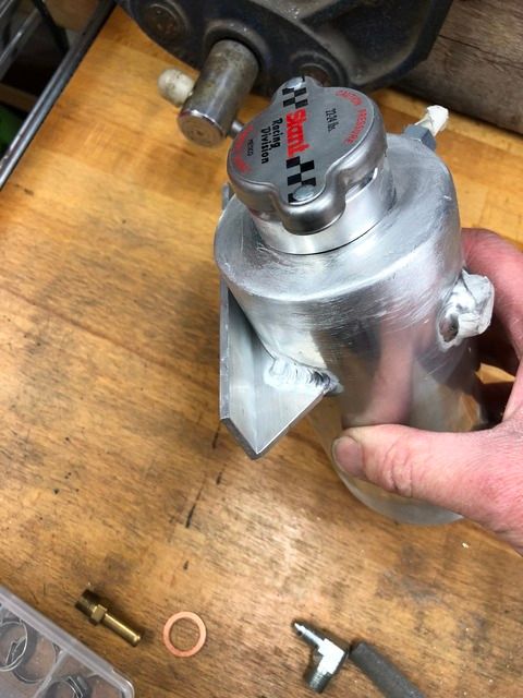

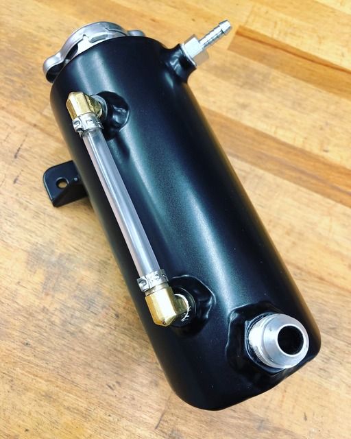

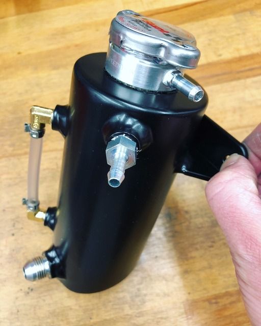

So, I got the expansion tank prepped for powder-coating by filing down the welds on the lid and the base. Lewis deliberately welded them "generously" with this intention in mind.
http://img.photobucket.com/albums/v2...d/IMG_2280.jpg
http://img.photobucket.com/albums/v2...d/IMG_2281.jpg

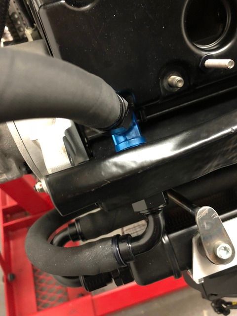

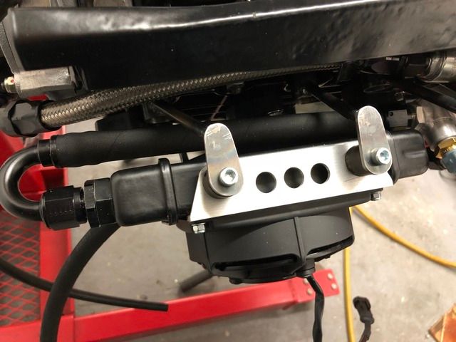

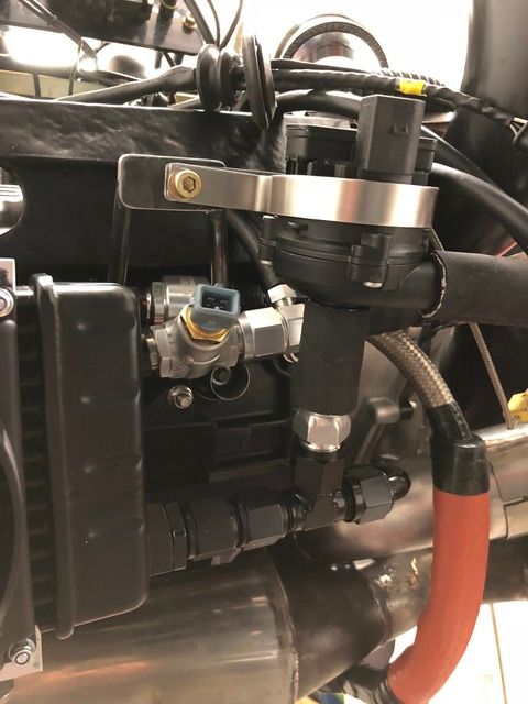

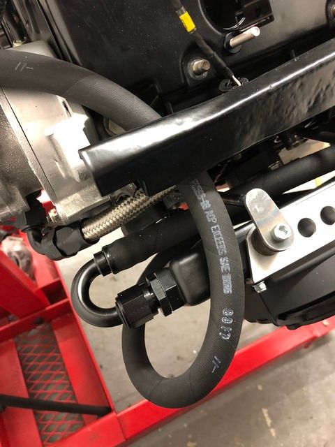

Next job, start plumbing the hoses for the water system. Much as the Aeroquip push-on fittings are impressive with their "simplicity", they're an absolute sod to assemble. Coincidentally my best mate phoned earlier, and we both remembered assembling these in years-gone-by on various race cars....we both agree on them being a tough job. The hoses are double layered with a cotton centre, then a tape outer to reinforce the hose. It makes for a very tough hose that won't expand under pressure, but it also means that getting it over the barbs of the fitting gives you a good workout. The primary application is for oil rather than water, so it's way OTT for this application. There's a shock.
http://img.photobucket.com/albums/v2...d/IMG_2277.jpg

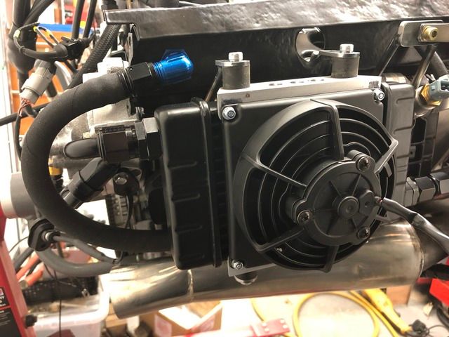

Pleased with how the water return line sits neatly behind the radiator...
http://img.photobucket.com/albums/v2...d/IMG_2275.jpg

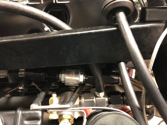

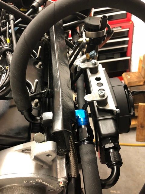

...and also how the bleed hose and sensor housing sit, with the bleed hose using an existing hose in the tinware. I'll need to re-route one of the wastegate hoses, however....
http://img.photobucket.com/albums/v2...d/IMG_2278.jpg
http://img.photobucket.com/albums/v2...d/IMG_2276.jpg

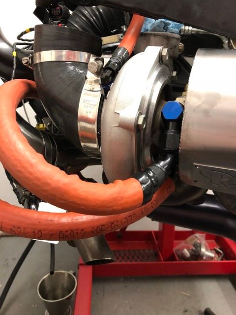

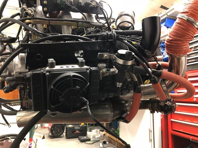

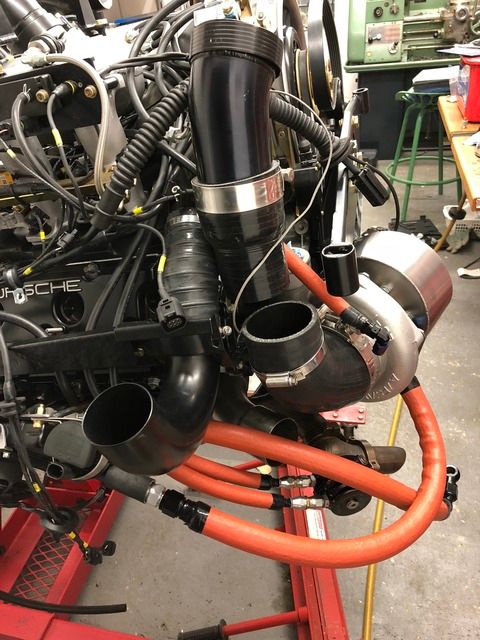

Some more Aeroquip fire retardent sleeving is on the hoses that run to the turbo and near the exhaust system. Top tip, for tight fitting sleeve like this, use an airline between the hose and the sleeve to inflate the sleeve; some quick bursts allows it to shuffle forward a few cm at a time, works a treat and certainly easier than wrestling it on normally.
http://img.photobucket.com/albums/v2...d/IMG_2273.jpg
http://img.photobucket.com/albums/v2...d/IMG_2274.jpg

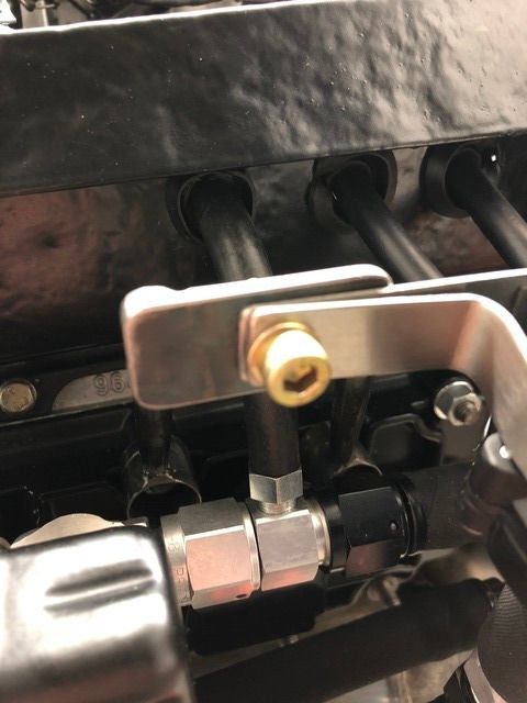

Not so much today, but it enables me to route the feed from the expansion tank into the water circuit a lot neater than the above pic, where the hose was looped around. Looked a bit shonky in my opinion, and needed a bigger hole (waiting for another Q-Max cutter to arrive) and a grommet (likewise). Instead I went ahead with my idea from the other evening....
http://img.photobucket.com/albums/v2...d/IMG_2289.jpg
http://img.photobucket.com/albums/v2...d/IMG_2290.jpg
Of course, it'll need re-plating in black, but the existing hole is PERFECTLY sized. If I'd have tried mounting the 90º elbow the other way around and using a 90º fitting on the outside, then it would allow more clearance for removing the valve cover. I may well reverse it over the weekend and remake the hose. But in principle, this looks a whole lot neater I think.
http://img.photobucket.com/albums/v2...d/IMG_2292.jpg
http://img.photobucket.com/albums/v2...d/IMG_2294.jpg
The hose you see above will then go to the tank outlet, once I've determined the length (by using The Force) ;) )

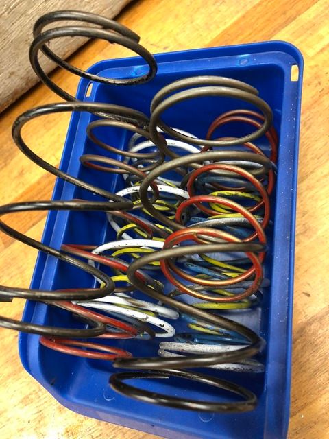

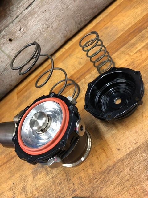

I removed both wastegates, so that I could switch the springs over for the lightest ones that came with the kit.
http://img.photobucket.com/albums/v2...d/IMG_2334.jpg
http://img.photobucket.com/albums/v2...d/IMG_2333.jpg
Installed previously were a pair of black springs (0.6 bar). Because we're now controlling both the opening and closing of the wastegates using air pressure (versus using just the spring pressure to control valve closure). In effect, all we need the spring for is to stop any valve fluttering, so the green 0.3 bar springs are now fitted. Wastegates back on, ready to go.

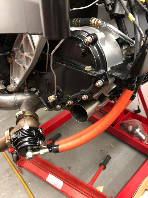

I took this opportunity to re-work the Aeroquip heat proof sleeving; I'd previously fitted a size that was too big, on the basis that I didn't want to strip off all the -4AN fittings to allow it to slide over. But it niggled me that it was overly fat, especially now that the water hoses are now running in the same area. Using the inflation trick, these hoses now have the tighter sleeving on, looking a lot better.
http://img.photobucket.com/albums/v2...d/IMG_2335.jpg
http://img.photobucket.com/albums/v2...d/IMG_2338.jpg

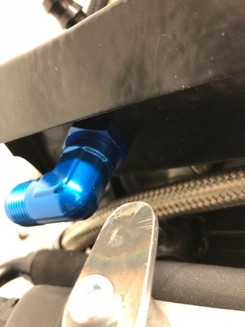

The 90º -8AN elbow for the header tank feed has now been switched around, as mentioned the other day. A lot better now, the fitting clearing the valve cover nicely.
http://img.photobucket.com/albums/v2...d/IMG_2341.jpg
Some fettling of the hot return hose so that I could punch another hole in the tinware, and allow the 1/4" bleed hose to feed through....
http://img.photobucket.com/albums/v2...d/IMG_2339.jpg

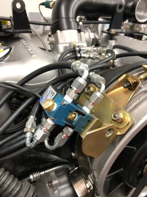

All of the wastegate control hoses are now finished; a few hoses needed making from scratch after adding the second boost control valve.
http://img.photobucket.com/albums/v2...d/IMG_2340.jpg

:D Haha, thanks! It's getting a bit busy with the hosing in that neck of the woods. This is looking more like an exercise in plumbing than it is in engine building.

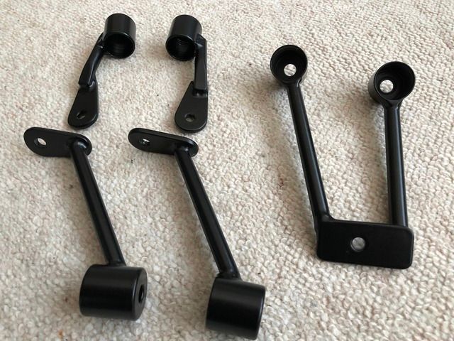

On the other hand, the powder coating shop were super quick, turning it around within 2 days. The radiator and pump support brackets....
http://img.photobucket.com/albums/v2...d/IMG_2365.jpg

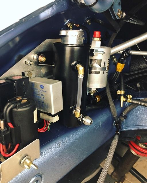

And the expansion tank, now cleaned up and with the fittings assembled...
http://img.photobucket.com/albums/v2...d/IMG_2425.jpg
http://img.photobucket.com/albums/v2...d/IMG_2424.jpg
....and quickly installed into the engine bay. I need to take it back out, as there was a backplate fitting that's interfering with the tank. Behind the backplate are 3x rubber vibration mounts, Male/Female; they screw onto studs that are set into the bodywork (female side of the rubber mount) then the male stud passes through the aluminium backplate and is fastened with a nyloc. The length of this stud and nut protrudes too far, and hits the back of the tank, so I've made 2x ally spacers for the top mountings and have ordered a female/female rubber mount, so that I can use a caphead screw to fasten the backplate. The mount isn't here yet, so that'll be a 5min job on Monday.
http://img.photobucket.com/albums/v2...d/IMG_2423.jpg

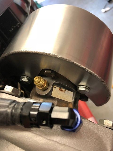

Some fine-tuning of the turbo heat shield was also quickly done today, in order to help me rotate the CHRA. Unfortunately, Garrett have spaced the turbine fixing bolts so that they interfere with either the banjo fittings for the water cooling ports, or if you index it to clear them, then it fouls the oil feed restrictor we need to run. Not a problem, just cut out the centre mounting hole for the shield, keeping the front and rear fixings.
http://img.photobucket.com/albums/v2...d/IMG_2375.jpg
