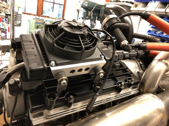

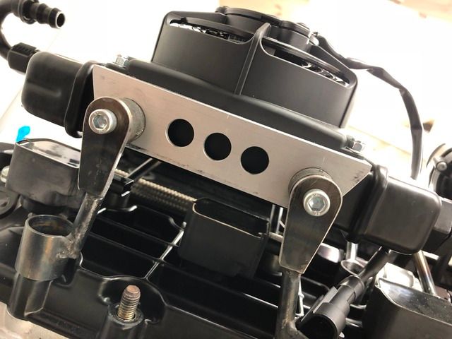

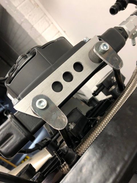

Mostly lathe work this evening, making 4x "things" (at a loss as to what to call them...) that mount onto the studs of the exhaust valve cover, onto which I'll weld the framework to hold the water radiator.
The plan is to (probably) use just 1 pillar/tube on the top mounting, with a pair of struts coming from it and across onto the 2x top mounts on the radiator. Depending on how rigid that turns out to be, I'll either repeat and mirror for the lower mounts, or if I want something stronger to take the weight, then I'll use a pair of mounts, with a strut from each.
Here you can see my thinking, with one of the "things" onto a top stud. So long as the furthest point of the 180º hose joint doesn't protrude past the back of the scavenge pump, I reckon it'll be fine when installed. If anyone knows better, please shout now before I weld anything....This hose is the hot side inlet to the radiator, with a bleed hose returning back up through the tinware to the expansion header tank. This bleed junction, is *just about* the highest point in the circuit and also the furthest point from where the header tank feeds into the loop.
http://img.photobucket.com/albums/v2...d/IMG_2180.jpg
http://img.photobucket.com/albums/v2...d/IMG_2182.jpg

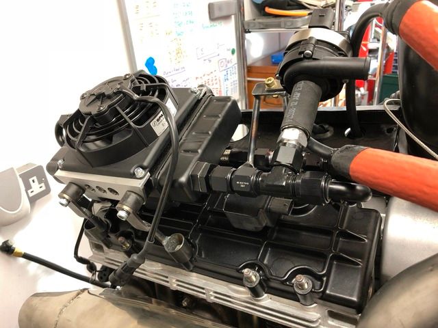

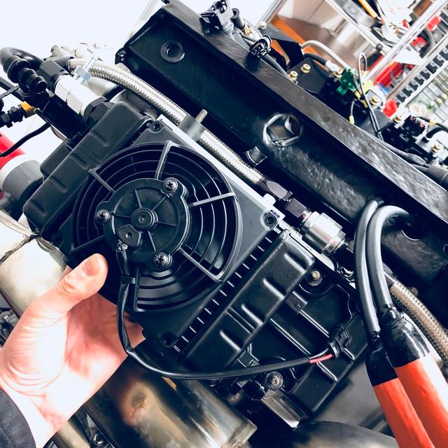

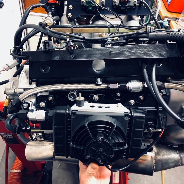

The 4" fan will mount on the outermost side, pulling air through the radiator, which is more efficient than blowing air into it.
http://img.photobucket.com/albums/v2...d/IMG_2184.jpg

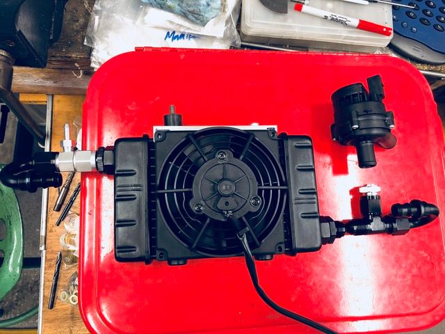

A quick layout of what-fits-where, I'm just waiting for the -8 Female-Female coupling joint to hook up the T and another 180º fitting onto what will be the radiator outlet. The pump will mount alongside pulling water up and out across to the turbo. The 180º fitting will be where the header tank feeds into the system, again coming through from the top side of the engine via the tinware.
Finally, it's another case of "you wouldn't believe how long it took me to make a bracket"....
http://img.photobucket.com/albums/v2...d/IMG_2185.jpg
One of the fan mounting brackets, absolutely spot-on dimensionally. Hoping #2 won't take as long, now I can take dimensions from the first one. Four clinch studs pressed in from the underside will be used to mount the fan. Need something with a very shallow head to avoid contact with the radiator core. These will be pressed in once the brackets have been anodised. Rubber bobbins are in the post; I'm using the type with a female thread on one side rather than the one shown above with two male threads.

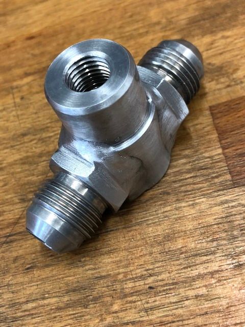

A few jobs to now do; I need to make a -8 Male-Male union with a 1/8" NPT thread inbetween, so I can install a water temp sender. I have 2x weld on -8 fittings, I just need to make the centre section, with a large enough diameter to accommodate the 20mm (or so) depth of the sender, without impeding water flow.
I also need to make two -8 > 3/4" pipe fittings, to interface the pump to the rest of the water circuit. A couple of pretty easy jobs for one evening this week.

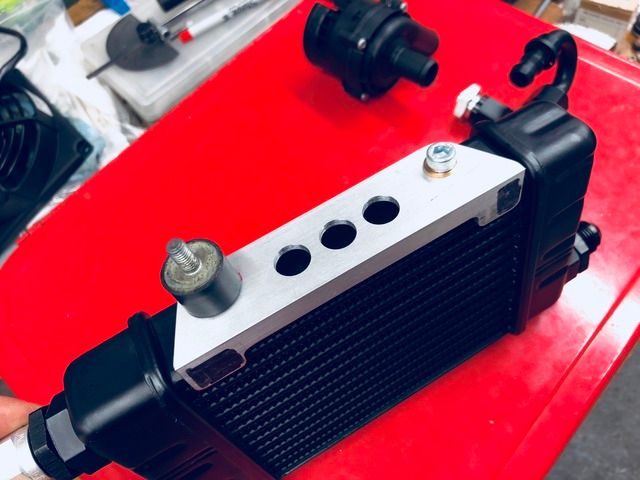

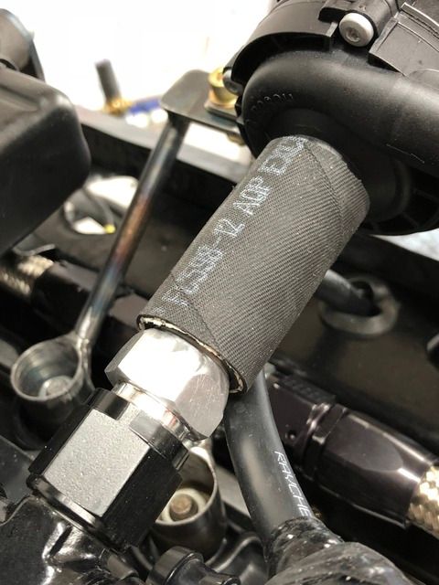

Plenty of progress over the last month, albeit sporadic whilst waiting for parts to arrive and having spare time to do it.
Following on from the previous update...
  • The rubber mounts arrived and are perfect for this application, allowing the radiator to fitted and removed with all brackets remaining in place (this will make more sense later...)
  • The female-female -8 adapter finally arrived; it needed to be ordered form Australia of all places.
  • The second fan mount bracket is now made, just some minor fettling work to finish it (me being pedantic)
  • Clinch studs are pressed into the brackets, to get the fan mounted. I'll need to remove them when everything goes for anodising.

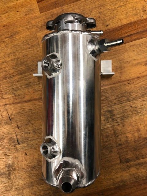

  • Lots of fabricating; push-on hose to -8 adapters, the water temp sensor housing and the expansion/header tank; more on that later too.

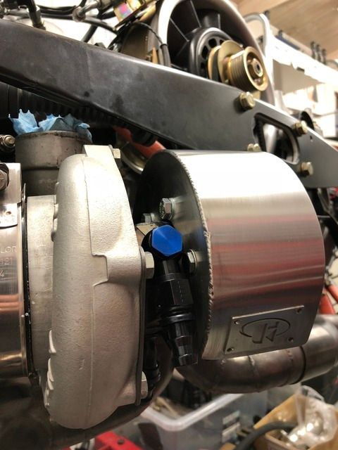

  • One of Chris's TK turbo shrouds is now in place.
  • Five or six modifications are now complete on the chassis side of the wiring harness for the ECU.

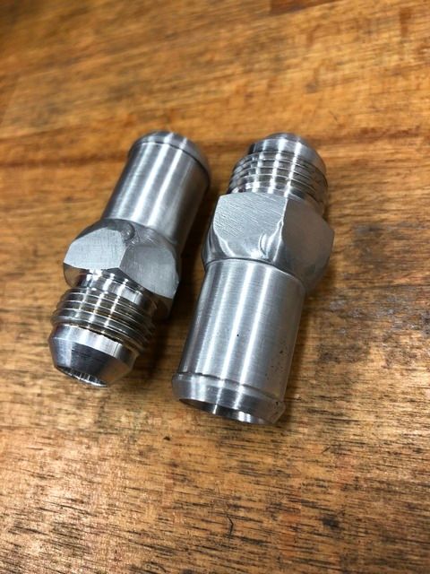

So...a few evenings and weekends spent making the individual components needed for interfacing the Bosch water pump (push-on hose fittings) into the rest of the system, of course using -8 AN fittings. In addition, all the parts needed for making the expansion tank were completed just in time for me to get across to my pals for them to weld.
The 2x adapters.....
http://img.photobucket.com/albums/v2...d/IMG_2246.jpg

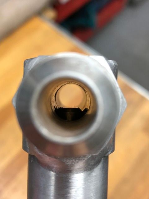

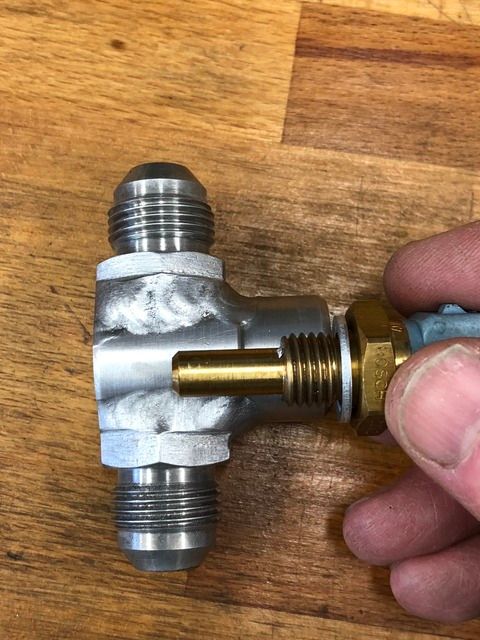

The water temp sensor housing....
http://img.photobucket.com/albums/v2...d/IMG_2238.jpg
http://img.photobucket.com/albums/v2...d/IMG_2240.jpg
http://img.photobucket.com/albums/v2...d/IMG_2241.jpg
This Bosch sensor of course needs to be spaced out of the way in this application, with the probe tip being about 20mm long I need to get it in a position that water can flow up around it, but for it not to obstruct the water flow in the small bore of -8 fittings. It uses an M12 thread, but the tapping drill for the M12 still didn't (in my opinion) allow enough fluid flow around the sensor, so I taper bored the ID of the bottom of this housing to open it up; worked a treat. The lower section of this piece was then milled flat to allow the pair of -8 fittings to be welded on.
I've now tidied up the welding to a degree, but I'm not going to go overboard for fear of compromising the joints water-tightness. All these fittings will be anodised once I've finished trial fitting everything.

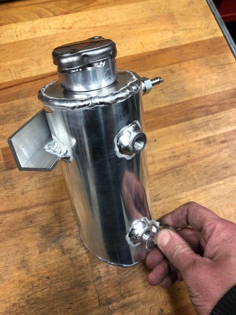

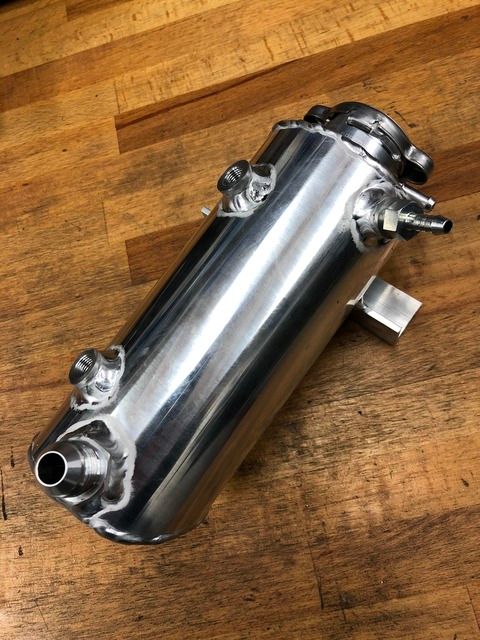

The expansion tank.....
http://img.photobucket.com/albums/v2...d/IMG_2250.jpg
http://img.photobucket.com/albums/v2...d/IMG_2251.jpg
http://img.photobucket.com/albums/v2...d/IMG_2253.jpg
This has an angled base, to clear the large wiring harness which runs underneath it along the chassis rail to the engine bay fuse box and relay assembly. I've added a pair of 1/8" NPT lugs so that I can install a sight gauge with a pair of 90º fittings. I need to order these on Monday, along with a 45º or 90º -8 fitting for the tank outlet. Tonights job is to smooth out the welds on the base and the top of the tank (like I did for the oil breather tank), in readiness for it being powder coated next week. The mounting bracket will re-use two M6 fittings that were originally used for the old CIS fuel system, latterly used for my old ignition amplifier mountings.

Finally, the TurboKraft turbine cover is now installed and tidies up the turbo no-end. Looks very smart. Because of the fittings I'm using to flow water into the CHRA (-8 banjo), I had to skinny-down the hex bolt adjacent to the water port, so that now clears by a gnats todger.
http://img.photobucket.com/albums/v2...d/IMG_2249.jpg

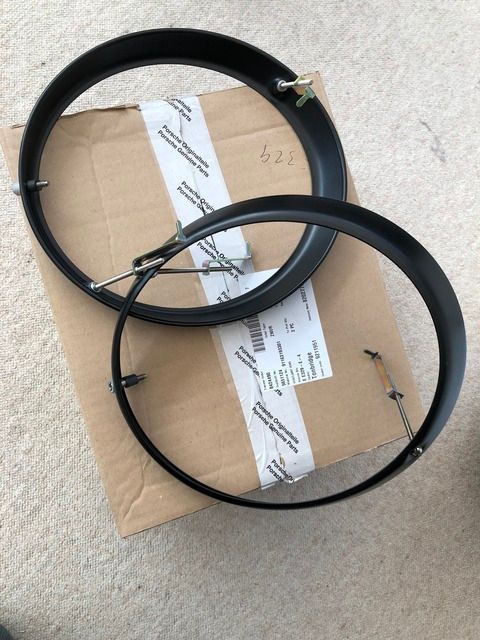

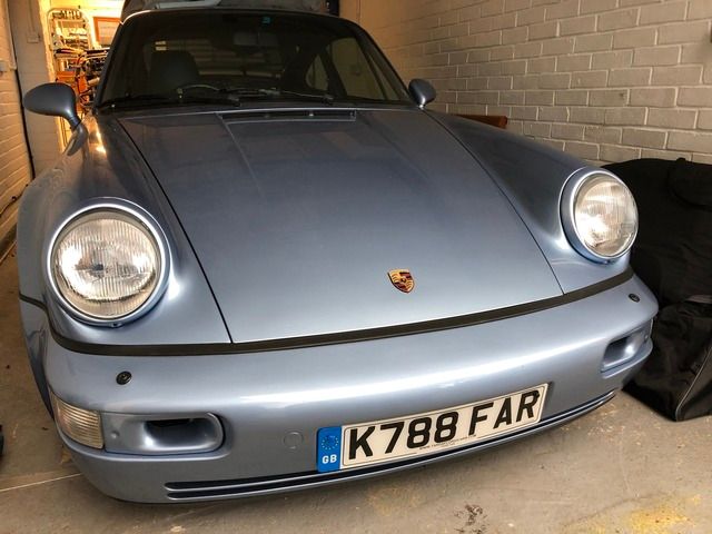

I almost forgot, I've FINALLY got the headlamps back together again!!
I was struggling to get the painted trim rings sitting nicely over the black "technical" rim which holds and aligns the lamp unit. I couldn't work out why, even after stripping the black powdercoating back off, it wasn't going over. I'd assumed to start with that the powdercoat finish was marginally too thick but upon closer inspection, it looks as though some distortion has taken place when they were being prepped for coating. My suspicion is that they were incinerated to get the old black painted finish removed; when I looked closely at the shallow lip that wraps over the glass, it had distorted enough to make a difference.
So, two choices....persevere with gently manipulating it back into a shape that works, then send it off for painting or black electroplating. Plating would mean that I would need to spend a decent amount of time removing the bead-blasted finish and polishing it, with a risk of distorting it again.
Or....use the best tool in the toolbox; that lovely piece of plastic, approx 2"x3" and cough up the reddies to Porsche for a new pair. £185 the pair!!! They did come with new lamp adjustment screws, and new trim ring screws which I wasn't expecting....but still, that's a fair chunk of wedge for two metal rings, stamped out in the thousands in a factory somewhere.
http://img.photobucket.com/albums/v2...d/IMG_2194.jpg
Next job was to then repair the tabs in the headlight bowls, where the M5 thread had "pulled". Helicoils and a Dremel to shorten them, then a nice coat of paint to recoat where it had cracked and flaked off....if it's worth doing, then it's worth doing right....
An hour spent rebuilding the pair of lamp units with the retainer spring clips, and they fit like a dream...albeit with reassuring persuasion from the heel of my hand...the "percussion method" (you hit it). She's got her eyes back! It's been 4-5 years since I've seen the car with the trim rings on, last time it was driving it was with the black rims....
http://img.photobucket.com/albums/v2...d/IMG_2209.jpg
