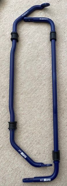

A quick couple of photos of the new H&R anti-rollbars in their resplendent mauve (?!?)....

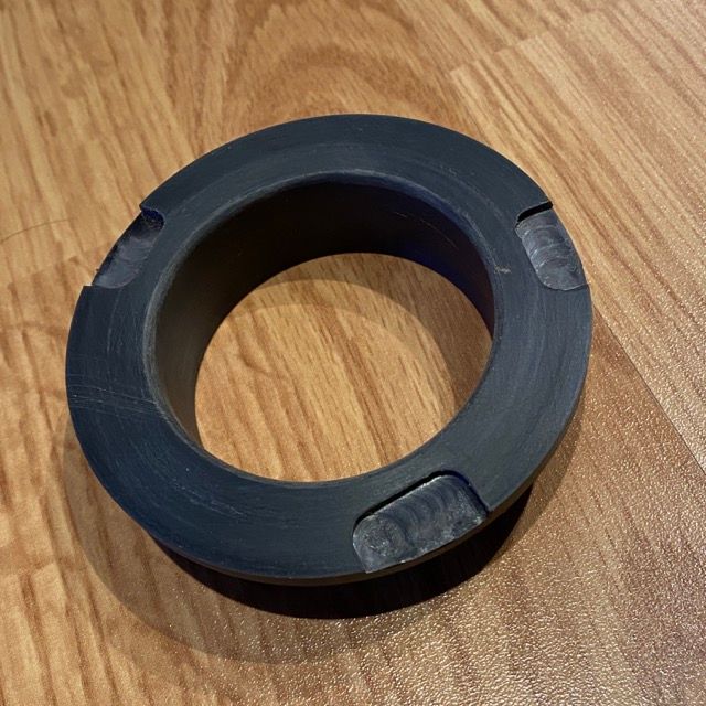

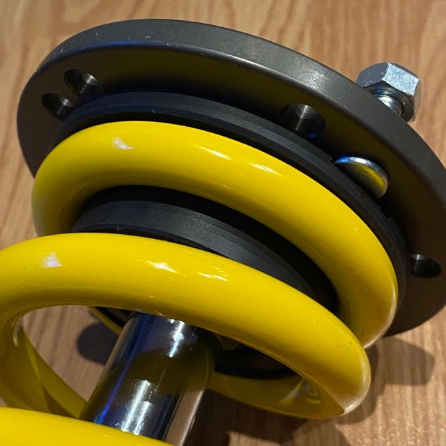

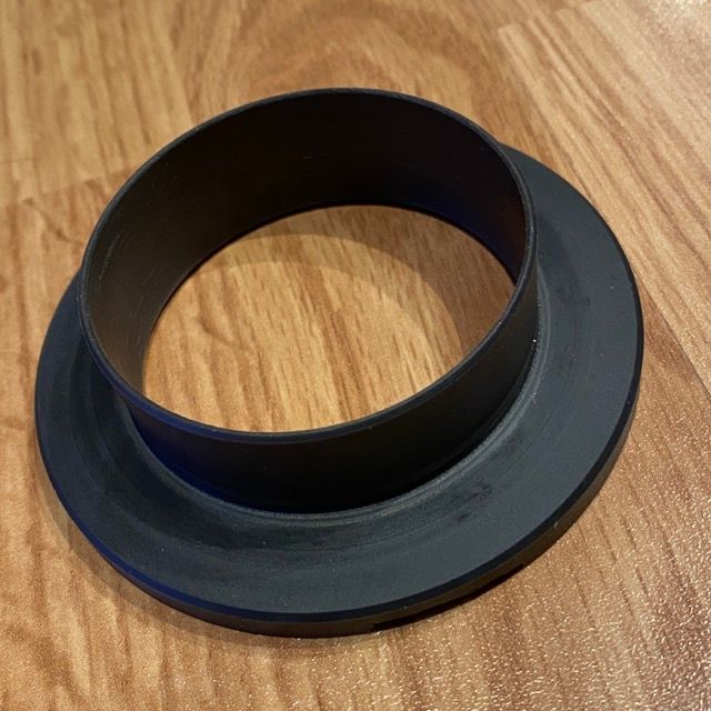

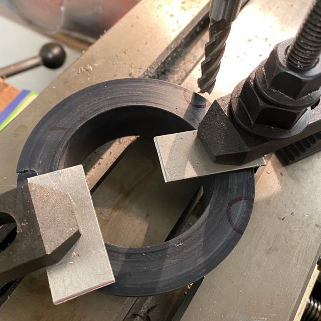

My bar of Nylatron, 102mm diameter, arrived the other day which is what I needed to make the seating rings for the rear dampers.

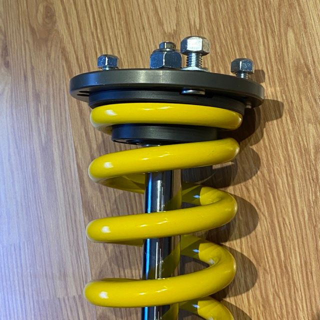

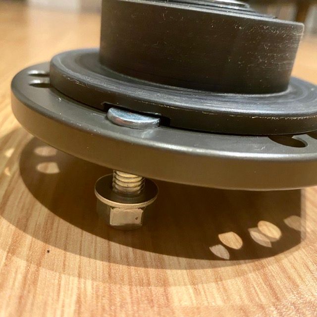

Quick recap - installing the dampers and springs onto the Elephant Racing monoball top mounts means that you don't use the purple ally perch, as supplied by KW...
https://img.photobucket.com/albums/v...G_9204%202.jpg
...I guess these interface nicely into the stock top mounts.
However, substituting the OE mounts for the ER ones, this is what you get...
https://img.photobucket.com/albums/v...n/IMG_9196.jpg
https://img.photobucket.com/albums/v...n/IMG_9195.jpg
As you can see, the studs which are installed are pressed in but sit proud of the mount body. I don't know why they don't counterbore them and install flush, but there you go. I was told that what you see in the above photo is how they're supposed to be, and that it would be fine. I wasn't happy with only 3 points of contact for the spring, and a loose fit of the spring over the bearing housing. Steel against aluminium also niggled me, the lovely anodised finish eventually being damaged.
So, time to correct both of those annoyances and do a proper job. The Nylatron I ordered this time was some that had MoS2 (molybdenum disulphide) added to it which apparently makes it stiffer, harder and dimensionally more stable than standard Nylatron. As it happens, it was the only option available for that diameter, in the (short) length I needed, at a reasonable price and in a couple of days. But, it's nowhere near as nice to turn as the regular Nylatron. Regular material chips nicely and easily gives a lovely surface finish; this material doesn't chip, in some regards it's very plastic so it tangles around the tool and onto the work itself....but then (unlike normal nylon) it's very tough to get off and untangle. Once you get a feel for how to cut the material you can get a decent surface finish, but it's not as forgiving as regular Nylatron.
Anyway, onto what I've now made.....
https://img.photobucket.com/albums/v...n/IMG_9198.jpg
Today I also realised that I have a very limited selection of milling cutters - in fact, just one end mill and it's not the same, or larger, diameter that I needed to mill the escutcheons to clear the stud bases. So, I had to instead machine a square-ish section from each location. Nothing critical dimensionally, so long as the recesses are deep enough...
https://img.photobucket.com/albums/v...n/IMG_9194.jpg
https://img.photobucket.com/albums/v...n/IMG_9197.jpg
Each one of these sleeves is a spot-on fit onto the top mounts...
https://img.photobucket.com/albums/v...n/IMG_9205.jpg
...the spring is now sitting on a full 360º surface contact base, and is held concentrically a lot tighter to the mount....
https://img.photobucket.com/albums/v...n/IMG_9201.jpg
https://img.photobucket.com/albums/v...n/IMG_9202.jpg

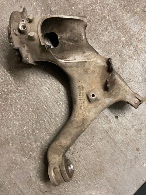

Best tool in the garage? The flipping long 3/4" drive breaker bar! That's been invaluable, along with the Snap On torque multiplier I bought a few years ago. The rear arm is almost ready to come off; the driveshaft is now out, the brakes came off the other evening along with the hub. The outboard chassis fixing of the rear arm was exceptionally tight and definitely a single-hex 18mm socket only. The inboard spring plate pivot bolt was also a challenge, not really because of how tight it was, just the sheer lack of space between it and the transmission casing. The left hand side looks a lot easier, far more space. I bought a shallow set of hex keys to do this, and although the size I needed had only a 3/8" sq drive, with the breaker bar and a trolley jack handle on it, it did come undone. How I torque it back up, I don't yet know.

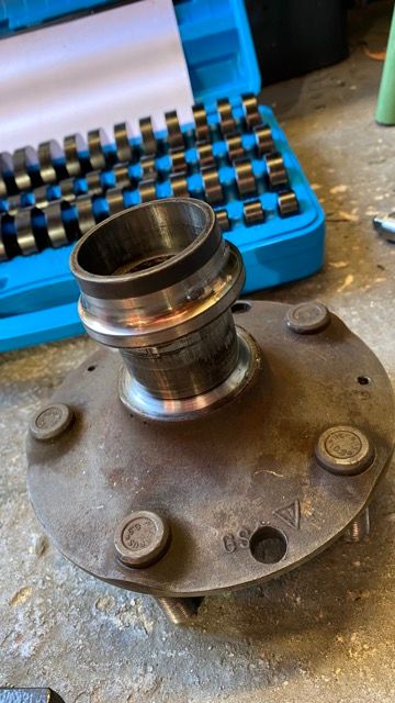

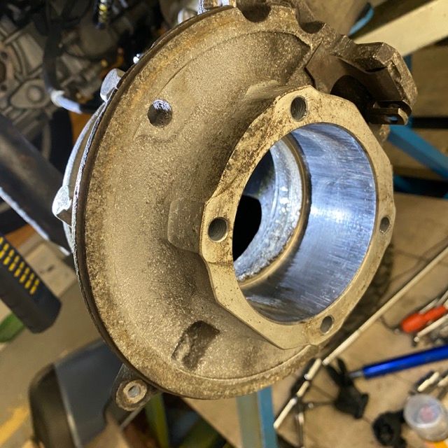

When removing the hub, the wheel bearing came apart, leaving the outer race on the shaft of the hub. From what I've read, it seems it does in most cases. It confirmed my decision to replace all the wheel bearings regardless (although I think they may have been done by a PO, evidence of copper slip rather than Alu Slip, not factory). The grease inside the bearing is very hard and wax-like, although there were no signs of imminent failure.
https://img.photobucket.com/albums/v...n/IMG_9256.jpg
My policy of buying lots of tools (mostly because I love buying tools...) has paid off, with a bearing removal tool that I must've bought a long time ago and never used, coming into play to remove the outer case of the bearing from the hub.

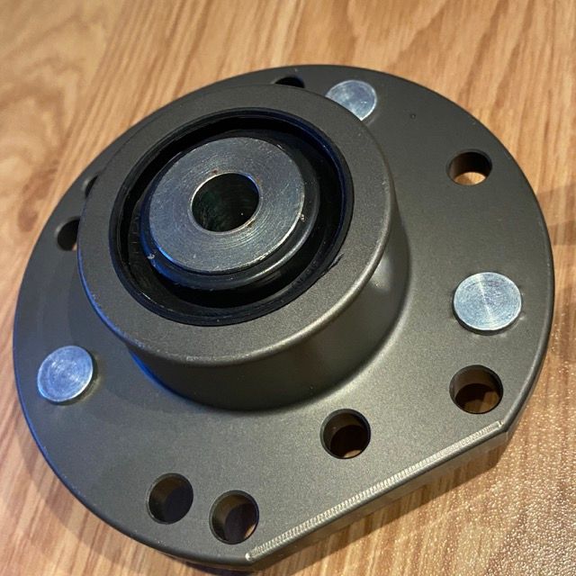

Sorry for the delay spencer .
I only just realized when I saw this thread again today .
I just snapped some pics of the fronts , but it looks like you made your own solution now ?
They have a small spacer (4-5mm) between the top hat and the monoball .
No sticktion there whatsoever .
If you need more , let me know .

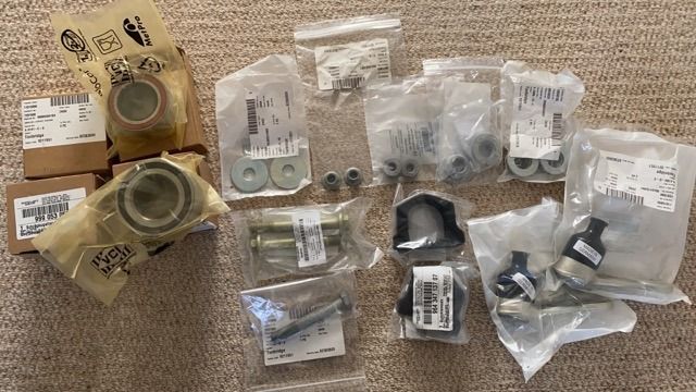

First off, most of the shopping list I ordered from Porsche Tonbridge have actually arrived....and at this point I need to say a couple of big "thank you's"....
Firstly to Chris (TK); I mentioned to him in a WA message that I didn't think I had quite got my parts ordered in time, as Tonbridge called me on Tuesday morning to say that they had taken the decision to close the dealership to the public - so near and yet so far. Without me even asking him, he proactively put a call in to his local OPC to investigate price and availability in case Plan B would be to order them in the US and then ship over with the Elephant Racing parts. What a great guy.
Secondly, thanks to Dan at OPC Tonbridge, who was fielding all the phonecalls that were diverted to him working from home. He had a sneaky suspicion that my parts would be arriving with the skeleton staff still in the dealership, but would go in on Thursday to make sure. He then called me back with a plan of action; everyone would be given a 20min time slot to arrive, park up and he would then walk the orders out and leave them by the car, thus not transgressing any social distancing rules. My slot was lunchtime yesterday - usefully - so I dashed over and collected per the plan. Top marks to Tonbridge for not taking the easy option and doing everything they can to help us enthusiasts keep working.
https://img.photobucket.com/albums/v...1694BDAEC9.jpg
Most of the parts have arrived, but there were some which needed to come from Germany, in addition to only one of the trailing arm bolts being shipped from Reading across to Tonbridge. Strange, but nevermind...these are now being ordered by Chris and will come over in a week or so.

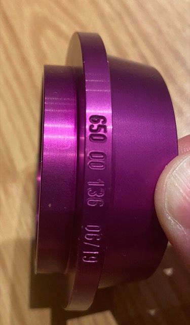

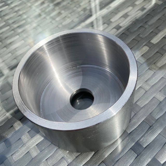

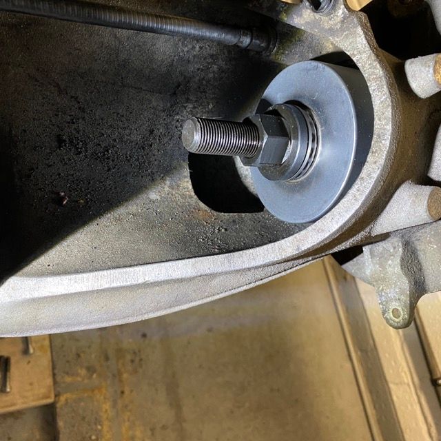

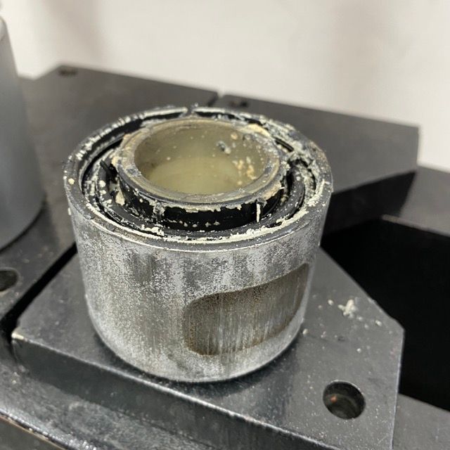

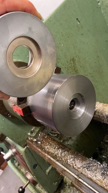

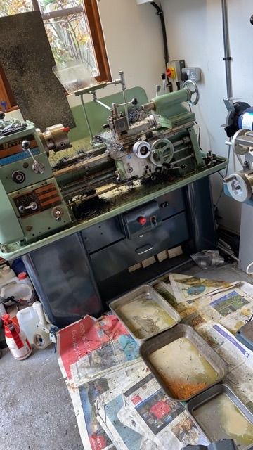

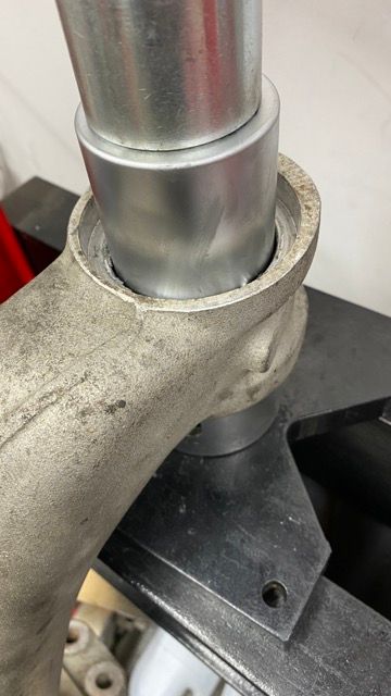

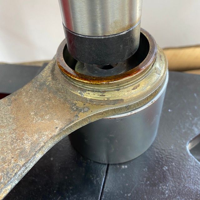

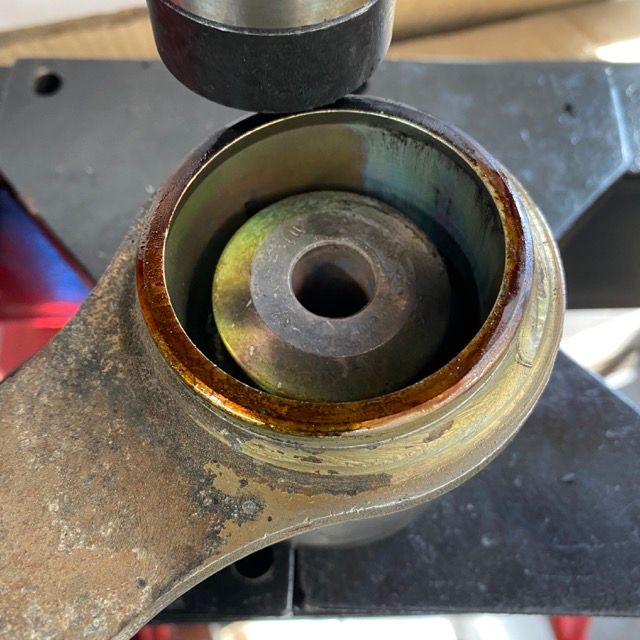

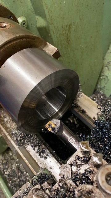

In other news, the new bearing and seal press kits I bought a few weeks ago are lovely bits of kit - however, the largest sleeve in bearing kit isn't large enough to "receive" the rear wheel bearing. A 76mm OD sleeve is used to push out from the inboard side, but it needs a sleeve of 89mm ID (min) for the bearing to pull into.

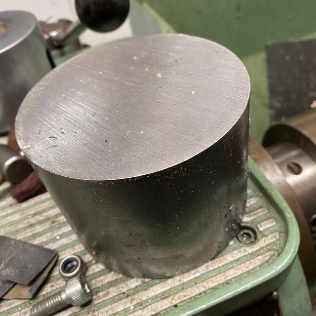

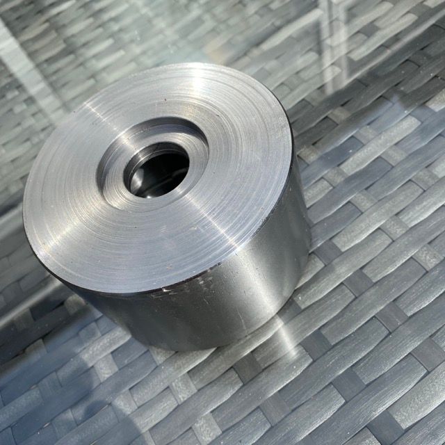

So, time to order some steel - thankfully this come through and wasn't thwarted by the lockdown.
https://img.photobucket.com/albums/v...n/IMG_9291.jpg
Of course, most of this will end us as swarf, but I wanted a 1-piece tool to match the rest of the set rather than use a tube and a stepped top-hat that engages into it. Mind you, it would've saved a LOT of work had I taken the easy option!
https://img.photobucket.com/albums/v...1A7C298773.jpg
No kidding, this has taken two full evenings and Saturday morning to make! Being 4" in diameter, I could only hold it using the external reverse jaws on the 3-jaw chuck, which have about half the gripping surface of the regular jaws - care needed.
https://img.photobucket.com/albums/v...9A72740347.jpg
https://img.photobucket.com/albums/v...5D9A5DB35B.jpg
This limited me to making small cuts to bore out the middle, starting with 1mm cuts on the inner bore, and slowing down to 0.8, 0.6 and then 0.4mm cuts as I reached the faster surface speed of the outside edge....it took forever going from 15mm to 90mm! In the process, the coolant suds were being sprayed everywhere, so some ad-hoc measures to prevent my workshop from flooding...
https://img.photobucket.com/albums/v...CE753EE50B.jpg
And eventually ended up with the finished article, perhaps not the finest looking piece, but bang on dimensionally and perfectly functional....
https://img.photobucket.com/albums/v...n/IMG_9328.jpg
https://img.photobucket.com/albums/v...n/IMG_9327.jpg

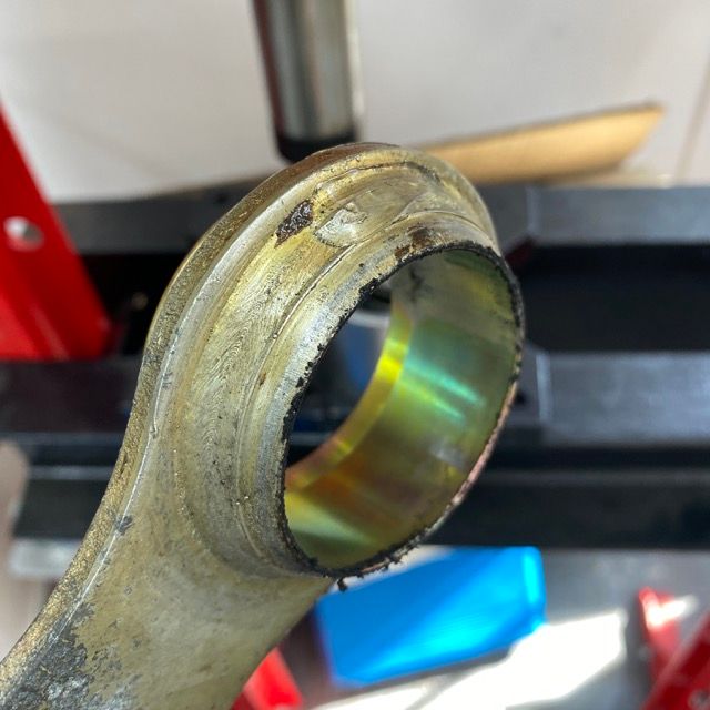

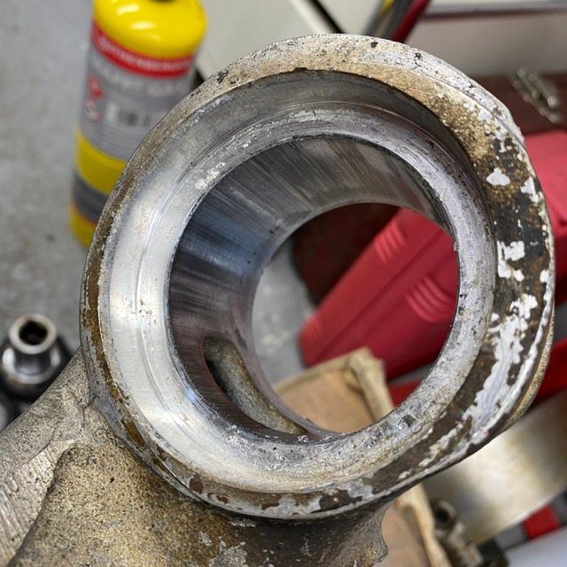

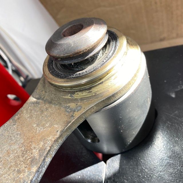

Immediately put to use, and the right rear bearing is out!....
https://img.photobucket.com/albums/v...n/IMG_9330.jpg
https://img.photobucket.com/albums/v...n/IMG_9331.jpg
https://img.photobucket.com/albums/v...n/IMG_9332.jpg

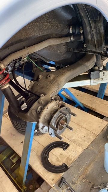

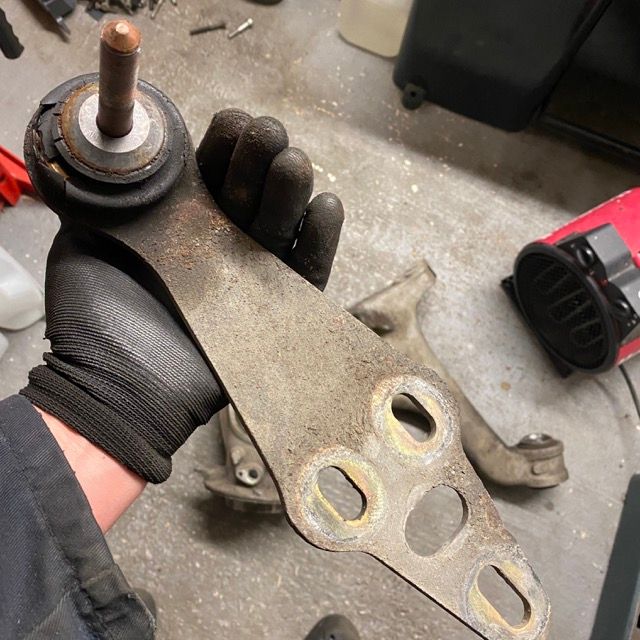

Spenny_b 03-28-2020 05:04 PM

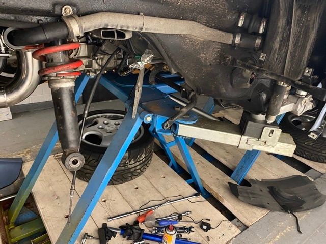

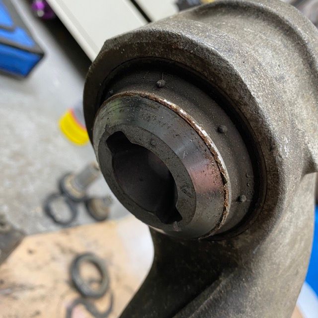

So, after a well-deserved lunchbreak and a mug of tea, this afternoon was spent clearing up the workshop, ridding the lathe of armfuls of razor sharp swarf and giving it a good old wipe down - it's been shamefully long since doing this, my old college machining tutors would be having a blue fit (before any of the apprentices went home each afternoon, every lathe, mill, drill and workbench had to be immaculate, every tool back into the Stores and in inspection done).

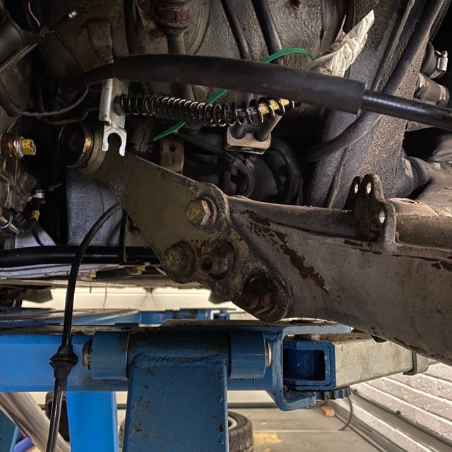

Then onto more of the fun stuff, the mission being to get that RHS trailing arm off the chassis.
Job 1 - Remove the handbrake cable. First attempt using molegrips didn't show any signs of working, at least, not without mullering the ferrule in the process. Attempt two was to again try one of the parallel punches through the aperture where the cable runs through, but this time using a decently weighted ball pein hammer rather than a rubber faced mallet. Success!! That sharp metal contact obviously dislodged it enough to get it out....my Step 3 would've been to cut it and replace, so I'm glad it didn't come to that.
Job 2 - Make copious notes and take photos of the current toe and camber settings. At the very least, I know they work to some extent, and will act as a starting point upon rebuilding.
https://img.photobucket.com/albums/v...n/IMG_9339.jpg

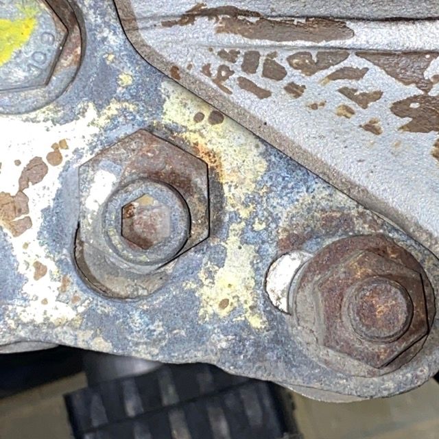

Job 3 - Loosen the fixings on the spring plate, and prepare to remove the whole arm.
Again, the 3/4" sq. drive breaker bar came in so handy, and within minutes the fixings were broken free. The air impact wrench did the hard work of removing them the rest of the way, and before I knew it, the trailing arm was off.
https://img.photobucket.com/albums/v...n/IMG_9340.jpg
https://img.photobucket.com/albums/v...n/IMG_9341.jpg

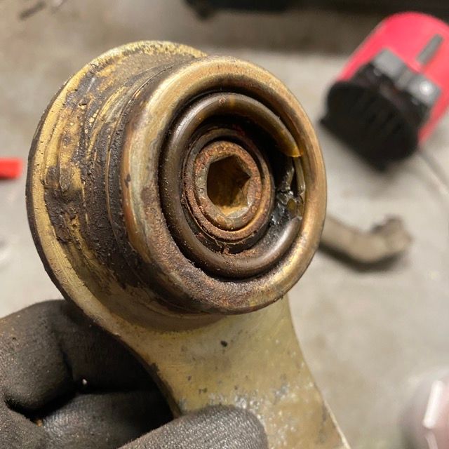

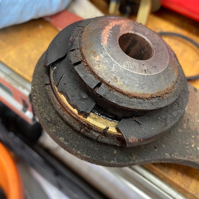

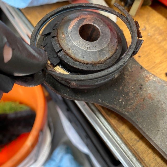

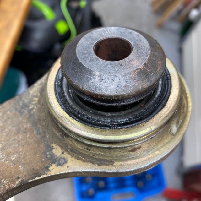

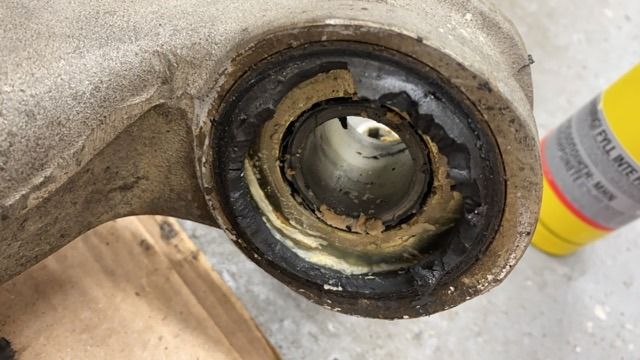

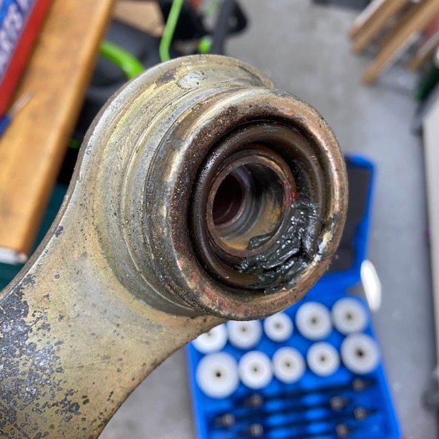

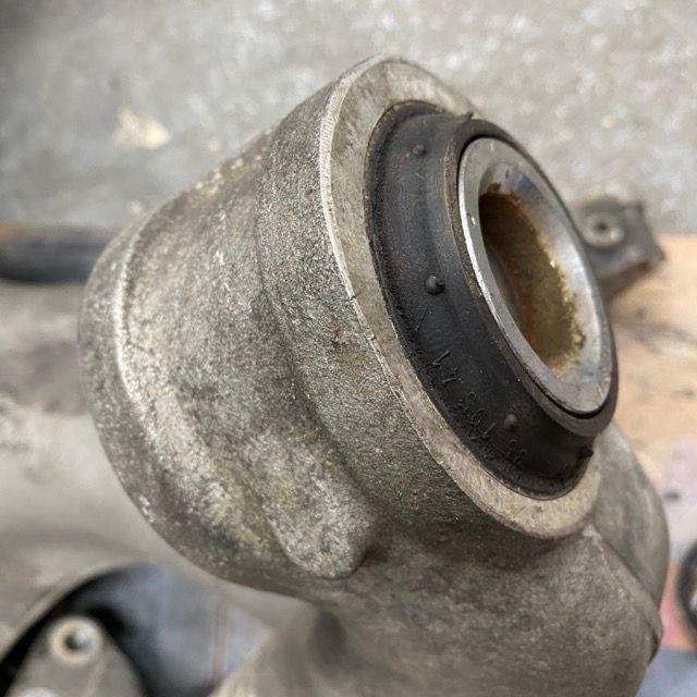

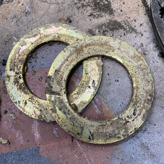

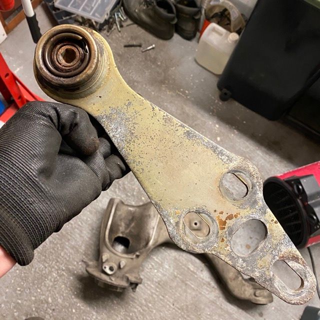

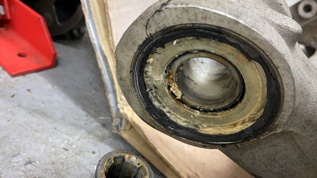

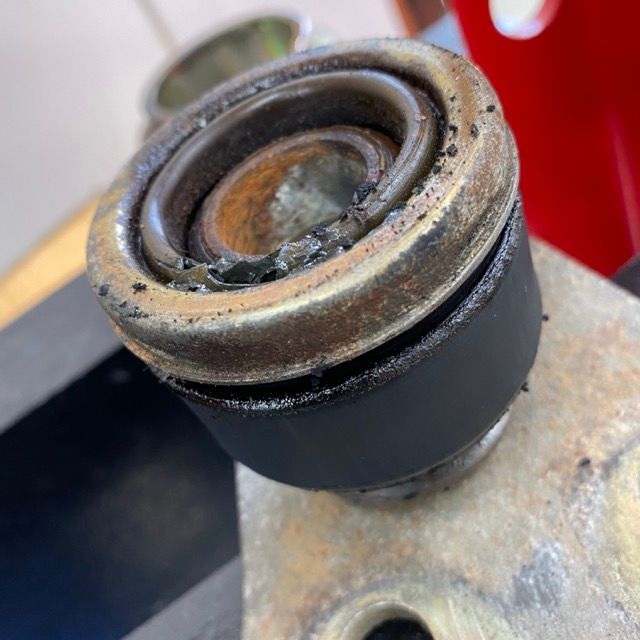

Clearly the suspension has been apart before in a previous life, as the M14 bolts for the front pivot and the spring bar are both coated in copper slip grease, which I'm sure the factory didn't use.
The spring plate bushes have seen better days, with the usual problem of the seals deteriorating to the point of crumbling....
https://img.photobucket.com/albums/v...n/IMG_9342.jpg
https://img.photobucket.com/albums/v...n/IMG_9343.jpg
https://img.photobucket.com/albums/v...n/IMG_9344.jpg
https://img.photobucket.com/albums/v...n/IMG_9345.jpg
So, one corner done. The other rear assembly is coming off tomorrow, then its time to get into the engine bay, remove the intercooler and undo the fixings for the damper top mounts.

A quick projectette in the workshop over lockdown-lunch, 20mins away from a laptop!
Thought I'd have a look and see what's involved with removing the bush from the spring plate that came off the other day. Well, one thing led to another, and before I knew it, it was out. Dead. Simple.
Step 1 - remove the 2 x wire spring hoops which retain the rubber seal on the non-tapered side of the plate. Using a pick, these came off very easily, and pulled the boot off with it.
https://img.photobucket.com/albums/v...n/IMG_9372.jpg
https://img.photobucket.com/albums/v...n/IMG_9373.jpg
https://img.photobucket.com/albums/v...n/IMG_9375.jpg
Step 2 - remove a lot of the grease that's still inside the joint. I gave the area a wire brush clean while I was at it, just because.
https://img.photobucket.com/albums/v...n/IMG_9376.jpg
https://img.photobucket.com/albums/v...n/IMG_9377.jpg
Step 3 - Find a suitable bearing removal sleeve to sit the plate into, while pressing it out on the hydraulic press. 78mm ID is the one you need. New bearing removal kit proving very useful straight away, can't beat having the right tools.
https://img.photobucket.com/albums/v...n/IMG_9378.jpg
Step 4 - Per the instructions from Elephant Racing, use a gas torch to heat up the rubber lining, non tapered side. When it starts smoking and the garage stinks like a pikey caravan site, you know it's getting warm enough. New MAPP gas torch worked a treat - again, wish I'd bought one years ago. Now use the hydraulic press to push on the metal "mushroom" centre part of the bush, the whole assembly then slides out beautifully, taking the rubber with it.
https://img.photobucket.com/albums/v...n/IMG_9379.jpg
https://img.photobucket.com/albums/v...n/IMG_9380.jpg
Step 5 - Ta da. Ready for wire brushing and re-plating. Hopefully the insertion of the new ER monoball will be as straightforward.
https://img.photobucket.com/albums/v...n/IMG_9381.jpg
FOR SALE - 1 x LIGHTLY USED SPRING PLATE BUSH - £0 ONO
https://img.photobucket.com/albums/v...n/IMG_9382.jpg

Spenny_b 04-01-2020 03:42 PM
Evening folks,
More lockdown progress to report. Yesterday evening the second trailing arm came off. Yet again the handbrake was an absolute pain, but with some localised MAPP heat to the housing on the arm, then a parallel punch, it relented. Next, I took some notes and photo's of the settings on the spring plate, then time to undo the big-stuff and remove the arm.
The spring plate was stripped down within minutes, then onto tackling the outboard chassis pivot bush. It's a big old bugger, and a few stages are required to partially disassemble it before removing the core.
The bush as it's installed from the factory....
https://img.photobucket.com/albums/v...n/IMG_9396.jpg
https://img.photobucket.com/albums/v...n/IMG_9395.jpg
First job is to again heat the rubber; the Elephant Racing instructions don't mention this, suggesting that the inners should just punch out. Hmm, it felt bloody tight to me, even after heating (but perhaps not enough heat). I gave it plenty of heat - outdoors so not to inhale the burning rubber - and then levered the shallower of the two pivots out. It's asymmetric, and on the second arm I did try levering the bigger pivot out first - it didn't work, purely because one half sits inside the other, like a telescopic sleeve.
https://img.photobucket.com/albums/v...n/IMG_9390.jpg
Remove the shorter, smaller half first. Then, the longer, larger headed one can be driven out from behind. Using lots of heat makes the rubber more brittle, and thus easier to rip when removing.
https://img.photobucket.com/albums/v...B6A86F041D.jpg
Trim some of the torn rubber back, so that you have better access for the next part...
https://img.photobucket.com/albums/v...A4A71F057F.jpg
...which is to use a screwdriver to lever out the jumbo washers/flanges....
https://img.photobucket.com/albums/v...n/IMG_9391.jpg
And now you need to remove the full diameter collar from each side, which retains the central core. Again, this is where I think my method is easier than that suggested by ER. They say to use a Dremel to cut a slit into this collar. I tried this, but the diameter of the cutting blade, despite being small, is still a bit big to get in there with. Perhaps if I'd have used a more accute angle I may have been more successful...BUT....you don't need to do this at all.
The collars are aluminium. All you need to do is use a woodworking chisel, narrow (mine is about 5mm wide) and sharp. If you carefully sit the chisel tip into the ridge between the collar and the trailing arm and gently tap towards the centre of the bush, you'll easily deform the collar. Do this a few more times....
https://img.photobucket.com/albums/v...n/IMG_9397.jpg
And then grab a pair of pliers and pull it out. No need to cut a slit, that only adds risk to damaging the arm.
Once they are both removed, I set it up on the hydraulic press; I think from memory it was a 78mm sleeve on the underside, and a 52mm sleeve on top.
https://img.photobucket.com/albums/v...n/IMG_9389.jpg
This bit is dead easy, barely any pressure required to push it out, and this is what you end up with...
https://img.photobucket.com/albums/v...n/IMG_9393.jpg
https://img.photobucket.com/albums/v...n/IMG_9394.jpg
Needless to say, the second arm took a total of 15mins to do! Next job is to clean them. I was really hoping to get all the ally parts vapour blasted to look like factory new, then coat them in clear Dinitrol to protect. But....with the lockdown, and quite rightly the Police getting more strict on people flouting the rules and travelling unnecessarily, it's not the responsible thing to do, for me to drive 50 miles each way to drop them off with the guy who does it, and then collect a few days later. So, I'll be applying liberal amounts of elbow grease to scrub them clean. Anyway, they'd only stay sparkly clean for about 5 minutes when the car gets driven.
