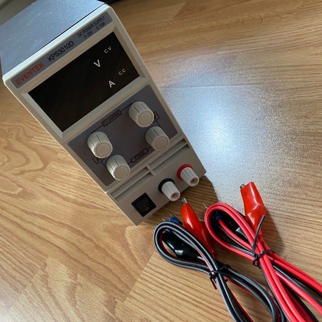

Minor update - the electroplating kit and my power supply have arrived. I've got sod-all food in the house, but I do have chemicals. Wait, that came out wrong...
Power supply looks fine; it got about 270 reviews at >4.5* on Amazon, about the most reviewed PSU of this type and price range, so that's the one I went with, although preferred the look of another lesser reviewed model. However it's not about the looks, it's just got to do a very simple job. This supply is also going to be use useful for other non plating functions; testing circuit boards and other such things I can't think of right now.

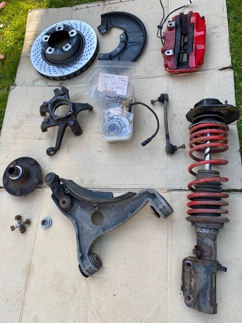

Font suspension teardown time....
Making a start with the calipers, disc and backing plate removed. Scabby looking, can't wait to get this cleaned!

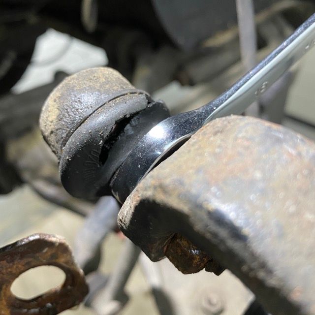

The ARB drop link has seen it's best days...
https://img.photobucket.com/albums/v...n/IMG_9407.jpg

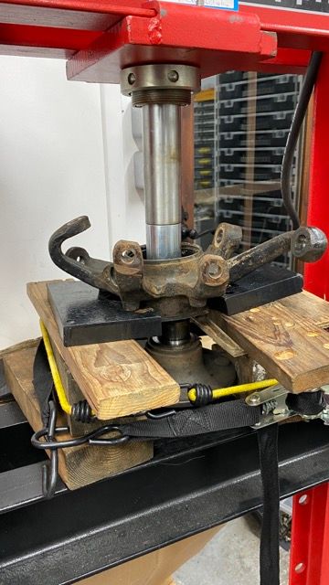

What is a little more Heath Robinson was the rig I needed to construct in the hydraulic press, to remove the hub from the upright. It didn't help that all-of-a-sudden the hand pump on the press decided not to deliver much in the way of piston movement. It worked well enough at gone midnight last night, so I could finish the job. This morning, a quick check revealed that the oil level in the pump had got too low, so I guess I was just pumping air. Thankfully I have a bottle and a half of hydraulic oil stashed in my cupboards, so fingers cross that's fixed it for todays activities.

Right, final update for the weekend - I'm bloody knackered, lots of energy being exerted to get that final corner broken down....but I've got there. Almost.
The suspension itself came off without any drama. Much the same as the RHS except obviously I knew a few tricks this time.
(The RH corner components)

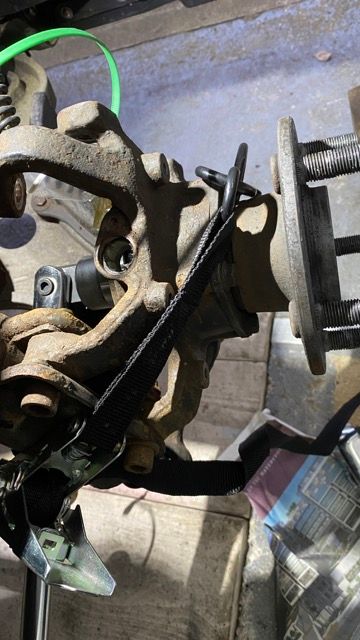

Moving onto other things, hub and bearing removal time from the LH upright. Not the prettiest setup - and another use case for the ratchet strap - but it just about worked...
https://img.photobucket.com/albums/v...n/IMG_9429.jpg

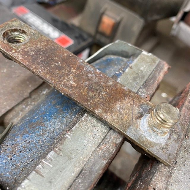

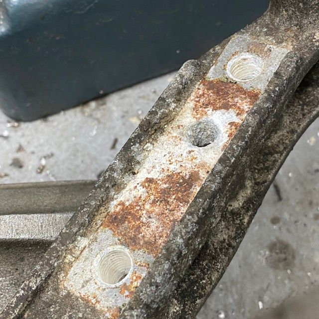

Undoing the lateral brace was easy, but check out the galvanic corrosion that's underneath where the M10 double nut plate sits (these are the rear-most fittings for the longitudinal braces). Unbelievable, and as part of my prep work to get them vapour blasted I literally had to chisel this corrosion off, it must've been 3mm thick in places.
https://img.photobucket.com/albums/v...n/IMG_9466.jpg
The double captive nut plate, from the RHS with remains of that sheared M10 bolt...
https://img.photobucket.com/albums/v...n/IMG_9463.jpg
And then after some heat (loving that MAPP gas torch, used it so many times so far) and the old-trusty stud removal tool from the engine rebuild days...
https://img.photobucket.com/albums/v...n/IMG_9464.jpg
If you look carefully at the nut that doesn't have the stud in it, you'll see the recess in the plate; on the seized bolt, this recess was full of chalky corrosion right the way up onto the bolt itself. No wonder it snapped. Before attempting removal I carefully chiselled and picked it away. Under normal circumstances, for about £5 per plate, I'd replace them....but Porsche GB haven't changed their policy on shipping parts to their dealerships (as of Tuesday this week), so no chance of getting replacements. "Make do and mend" is the theme here.

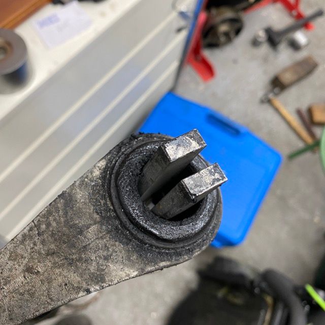

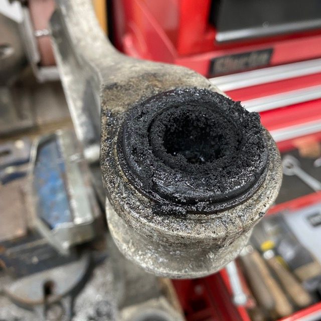

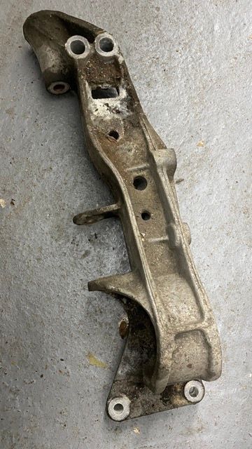

Onto the front lower control arms, and the continuing job of stripping them down. Again, this has taken far longer than the rear trailing arms, these things are in there TIGHT. The front-most bush is the hardest without a doubt. It's big, and in my case - guess what - corroded in to the arm. After heating the rubber to remove the steel cores, I tried using the press, with bush removal tools, but even maxing out the hydraulics at 12 tonnes load, it wasn't moving - and frankly that's just a little scary knowing that everything is under that much tension. On one of them, the MAPP gas did suddenly allow it to break free by 5mm, but then no more. I certainly didn't want to keep applying this level of heat either.
So, nothing for it but to use the hacksaw method to carefully cut the outer sleeve and release the tension. Even then, it was still an absolute pig to remove, but eventually I got them out.

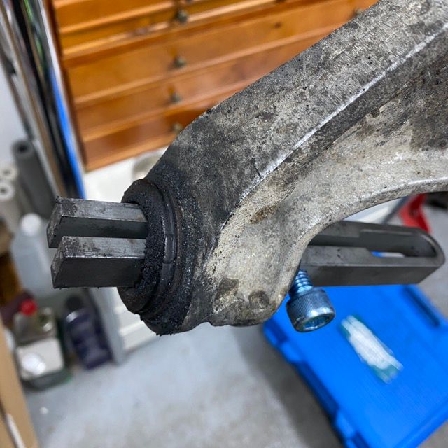

Next job, the rear-most split bushes. The first job is absolutely to remove the steel cores with heat. Then, you need to use a 1" hole saw to open up the I.D. This create a lot of friction with the saw, so liberal use of GT85 spray lubricant (smells great) gives the drill an easier time.
https://img.photobucket.com/albums/v...n/IMG_9448.jpg
Now, at this point, do I try the hacksaw method again or wait until the parcel from TurboKraft arrives, with the Elephant Racing split bush removal tool? Hmmm....I'd heard mixed reports on this tool - I think Rob Goughery in his build thread, broke his on the first attempt. I ordered it "just in case" really.
And then - again I think the Rebuild Gods are on my side - I got an email saying my delivery was due tomorrow instead of more than a week later! This is a turn-up for the books - both Chris and I are still in disbelief. We assumed that FedEx would just sit on it until the original stated delivery date of Thursday 16th. Decision made - I hang on and try the proper tool.
https://img.photobucket.com/albums/v...G_9451%202.jpg
Oh my God, am I glad that I did. Following Elephant Racings instructions and pre-heating the control arm locally to the bush, then using the tool, each half of the bush flew out. Literally.
https://img.photobucket.com/albums/v...n/IMG_9449.jpg
https://img.photobucket.com/albums/v...n/IMG_9450.jpg
I did try to rig it up in the press, but holding it without a proper jig was nigh-on impossible (too deep to use a bearing cup underneath), so it was time to use the "percussion method" (hit it with a big hammer). And after all that, you end up with...
https://img.photobucket.com/albums/v...n/IMG_9447.jpg
Check out that corrosion on the front bush.
That Elephant Racing split bush tool is ABSOLUTELY worth the money. No, it's not cheap but it most certainly did the trick. It's surprisingly meaty in build, and after multiple whacks with the hammer, not a sign of damage to the ends, so clearly it's been nicely hardened. The trick is not to overtighten the allen bolt once the tangs engage into the gap between each bush half. It only needs to be just over finger tight to prevent the tangs from jumping out under load. Excessively tight and you'll probably score the I.D. of the control arm.

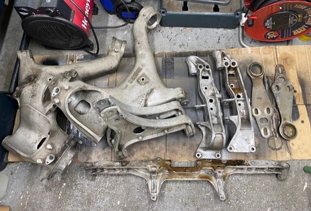

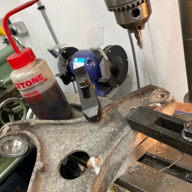

Final instalment for this evening, the lower control arms. Again.
In the photo in post#1266 a few days ago, you can see that the lower control arm has what's described as a rubber "air duct" bolted to the rear leg. It's held on by 2x M6 bolts, with nuts rather than tapped holes in the arm.
Another "FAIL" from Porsche on this one. No lubricant, and they're absolutely seized in. The heads snap straight off, no sign of movement, all four. After trying with another smaller stud removal tool (I REALLY wish I had a smaller version of the one photographed above), the only option was to drill them out.
https://img.photobucket.com/albums/v...n/IMG_9465.jpg
Some careful mounting on the pillar drill base, then some careful lining-up of the centre, and I decided to drill each stud from the top and again from the underside. I did try drilling one of them all the way through but it screwed up, the drill got deflected and it came out wonky underneath. Annoying nut not a big drama, I did get it out, oversized the hole to 8mm, then made a sleeve in the lathe with a 6mm hole in it. Loctite retainer then used to install into the arm. It went to prove that I clearly hadn't spent enough time getting the arm perpendicular to the drill (it is a very odd shape to try and hold, with gentle tapering on the edges).
Now we're on the homeward stretch - they just needs to be degreased in the cleaning tank to get them ready for vapour blasting....
https://img.photobucket.com/albums/v...n/IMG_9469.jpg
Even after this clean, they're already looking a lot better. Note that a lot of the factory Dinitrol is still in place, in all it's horrid brown glory. These all get collected tomorrow, and you never know, I may get them back over the 4-day Easter break we have. In the meantime, the steering rack needs to be removed (it's still hanging onto the splines of the column, but is now drained of its fluid).

I have that zink plating kit and the same power supply.
It takes some trial and error and very clean parts.
The resultats so far have been mixed.
A few practical things.
Get a lot of large plasic cans to store the solutions.
Get some rectangular tubs to do the plating in. Distance between the parts and the anodes are important.
Get heater elements to warm the solutions, I use 500w electric heaters thats used in the coolant on cars.

Hi safe,
Thanks for the advice, duly noted. Because we're in lockdown, I'll have to order the large rectangular tubs from Amazon and wait a few days (Prime is no longer a next day service over here, understandably). I have one very large plastic tray which I use for cleaning parts in, probably too shallow at approx 6" deep. Are you thinking the sort of tubs you use for storage, the kind that are 1ft x 2ft x 1.5ft deep?
I did get a heater element in the kit plus an aeriator to agitate the solution. The vendors also emailed me a spreadsheet with a surface area estimator for nuts and bolts - it should give me an approximate starting point for setting the current.
In my second order I also bought the electroplating book they sell, more comprehensive than the pamphlet which comes with the kit but I'm yet to grab a coffee and sit down to read it. Perhaps that's a job for this long weekend, unwind a little in the sun (my back garden, before anyone accuses me of not sticking to the Government rules) and read what it has to say.
