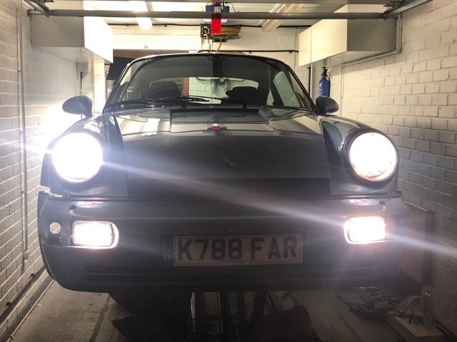

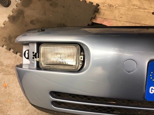

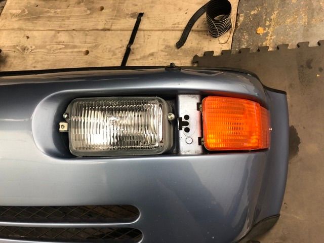

Before I get on to writing up the suspension project, just a quick update on the cosmetic work; I was so pleased with the refitting of the indicators a few weeks ago that I thought I'd also investigate switching out the "brake ducts" as well. They're not genuine Porsche 964RS items, and I hate anything fake, plus they're not actually doing that much. They certainly aren't feeding air to the calipers. The RHS dust is feeding the end of the oil cooler matrix; bearing in mind that this is a road car, most of the engine temp heat build up is when stationary in traffic queues, in which case the ducts are doing absolutely nothing. If I do need more cooling to the oil cooler, then I already have an output form the Syvecs built into the chassis harness to take control of the cooling fan. I'll simply remove the stock fan control harness and let the ECU take charge. The LHS duct is probably more useful insomuch that it's vaguely pointing in the direction of the AC matrix!
So, out they must come. But to do so, the front bumper needs to come off; unlike proper RS ducts that fix from the front, these don't have a screw. Upon inspection they've merely been bonded in (kind of) with a dollop of Tiger Seal onto the spring clip! [shudder]. Thankfully none of the original mounting holes or tabs on the bumper moulding have been butchered.
A new set of fog lamps ordered and collected, I'm now just waiting for the in-fill pieces that sit either side of the lamps. These and the correct fixings are on order with my OPC, along with a pair of new side repeater indicators (I had 2 slightly different colours; no idea which is correct, so a nice new pair are on the way). I've also ordered a pair of under-bumper trim panels. Mine just don't fit into the bumper that well, perhaps the plastic tabs have been stretched. They've also taken a battering over the years with speed bumps so thought I'd get a new set to complete the front-end makeover.
https://img.photobucket.com/albums/v...F4E0234F81.jpg
https://img.photobucket.com/albums/v...s/IMG_8346.jpg
https://img.photobucket.com/albums/v...s/IMG_8345.jpg
Testing, testing....
https://img.photobucket.com/albums/v...s/IMG_8349.jpg
Hoping to get these by the end of the week, install and get the bumper back on along with a little "smile" correction on the front slats.

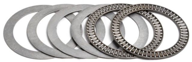

One thing I know that needs addressing is that the front struts need some kind of axial bearing plates in the assembly somewhere, to prevent spring wind-up when cornering.

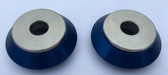

1) ER sell a bearing assembly that's 2.25" diameter, sitting between the top of the spring and the upper spring perch. It doesn't look to be sealed from ingress, simply a needle roller bearing plate, with hardened washers sandwiching it.
https://img.photobucket.com/albums/v...2000.00.38.jpg

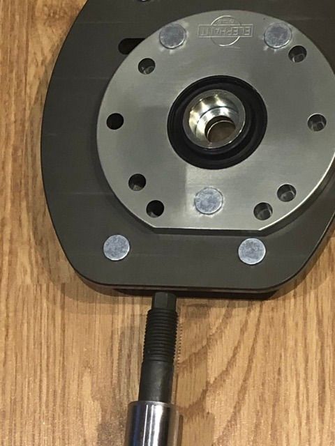

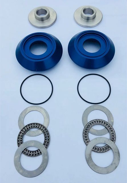

2) Rebel Racing make a very nice pair of replacement top perches, with a recess machined into the top face that sits up to underside of the monoball. In this recess sits a similar bearing/washer assembly, but smaller diameter (ID = rod diameter) and also weather sealed with a rubber o-ring. Nice setup and reasonably priced.
https://img.photobucket.com/albums/v...2000.02.13.jpg
https://img.photobucket.com/albums/v...2000.02.33.jpg
3) KW's own monoball top mounts have this axial bearing built into them, easy fit and forget solution, but would mean starting again and not using the ER top mounts (which are really nice)

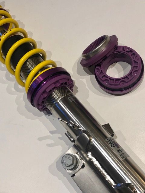

I decided to give the helpful chaps at KW's UK office a call today, who then suggested that they had a cunning plan; intended primarily for use on 996 GT3's (the coincidence is uncanny - those top perches I'm re-using are from my old 996 GT3) are a new spring height platform that has the bearing integrated into it, and again is sealed. Perfect!
https://img.photobucket.com/albums/v...20adjuster.png
Remove my stock spring platforms and refit with a pair of these. Problem solved. £58.50+VAT each and they're also in stock in Germany.

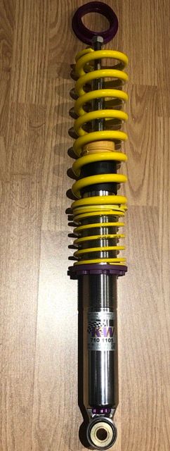

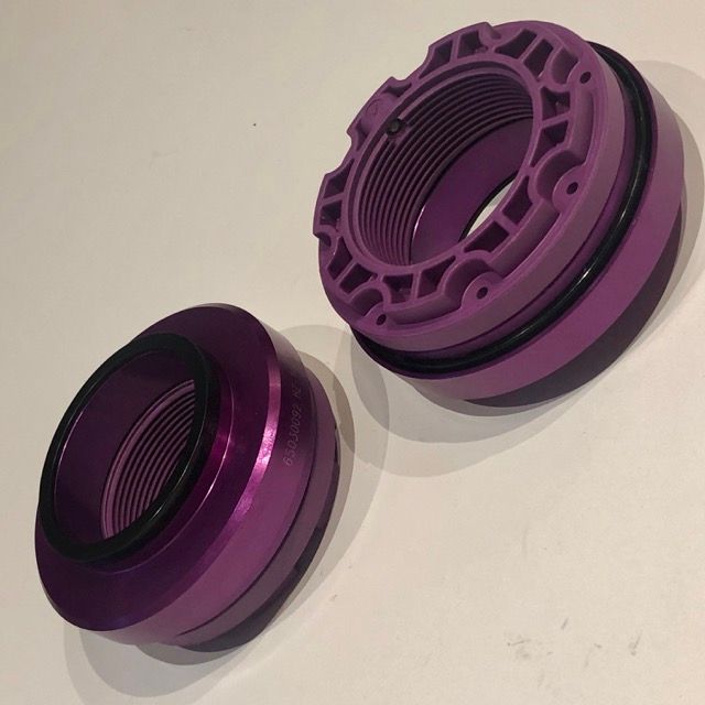

Firstly the rear damper.
The unit as it comes from KW, with the top "collar" for a stock installation.
https://img.photobucket.com/albums/v...n/IMG_8365.jpg
https://img.photobucket.com/albums/v...n/IMG_8366.jpg

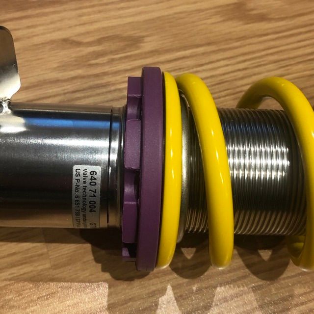

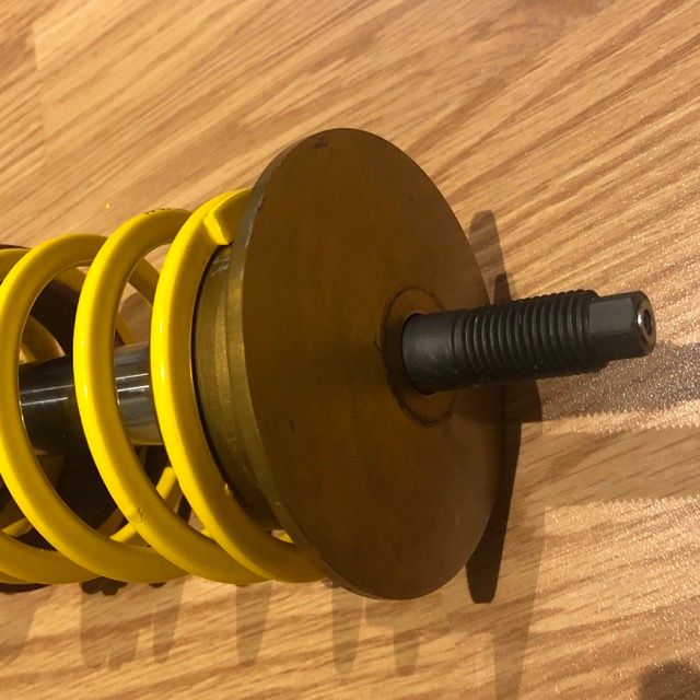

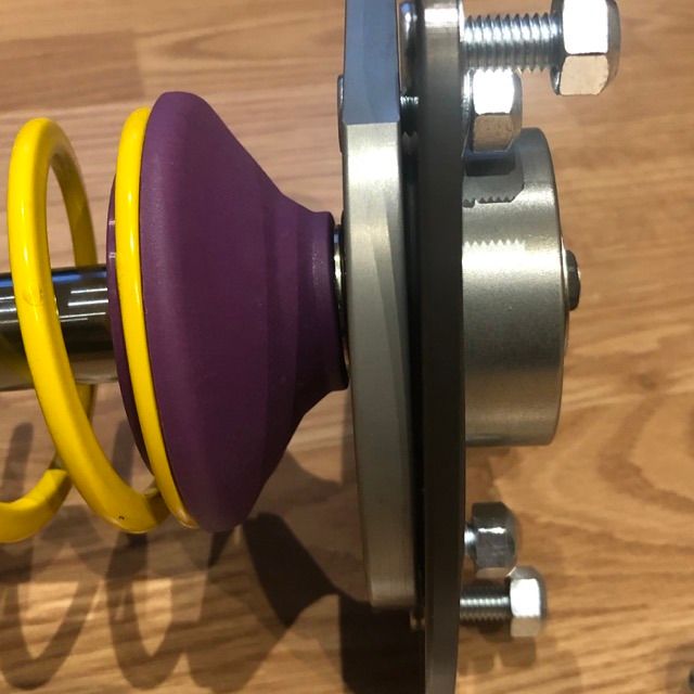

However, by not using these collars, the OD of the lower half of the top mount sits inside the spring; a little slack perhaps, and I'm not happy about the top of the spring sitting directly against the top mount for two reasons:
1) There's only 3x point contact areas, where the spring sits on the underside of the pressed in studs
2) The steel spring, unless retained a little tighter is likely to move and rotate in operation, and probably scratch the anodising on the mount, looking scruffy and compromising its weather protection. Somehow it just seems not-quite-right.
https://img.photobucket.com/albums/v...n/IMG_8368.jpg
https://img.photobucket.com/albums/v...n/IMG_8367.jpg
So my plan of action with the rear dampers is to make a nylon insulator that will sit between the spring and the mount. It will have 3x reliefs machined into the face that sits against the mount, to clear the stud faces, as well as a 10mm high diameter that will take up the slack and hold the spring concentric to the mount. Simple enough, I just need to order some suitable material.

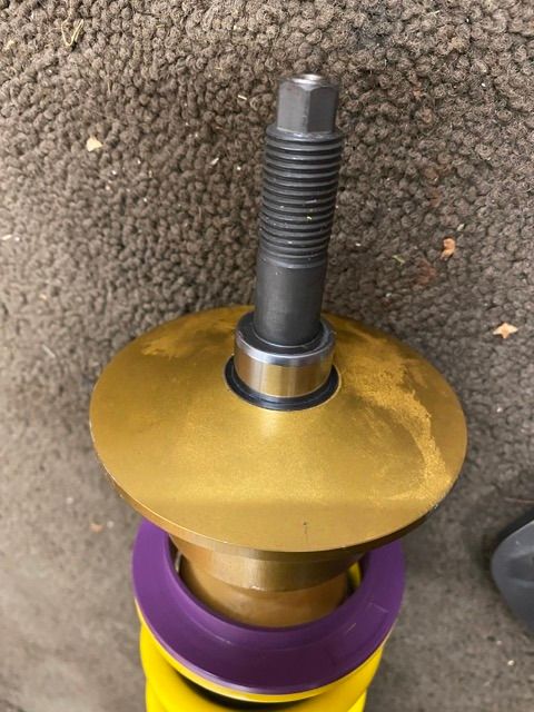

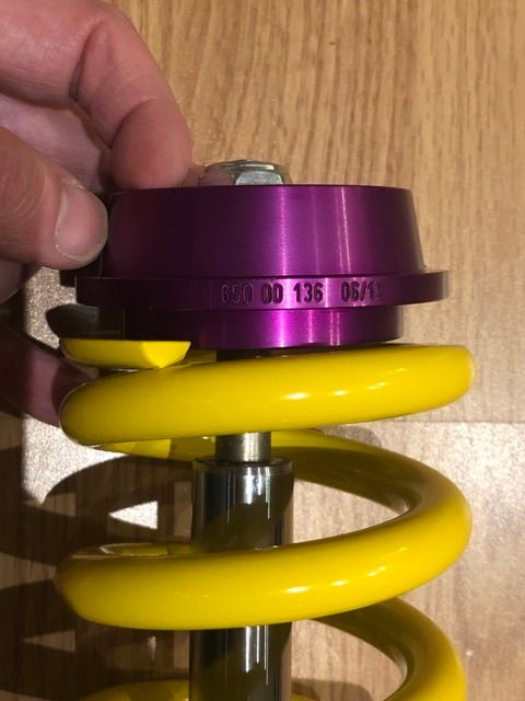

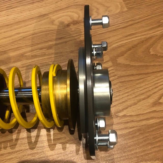

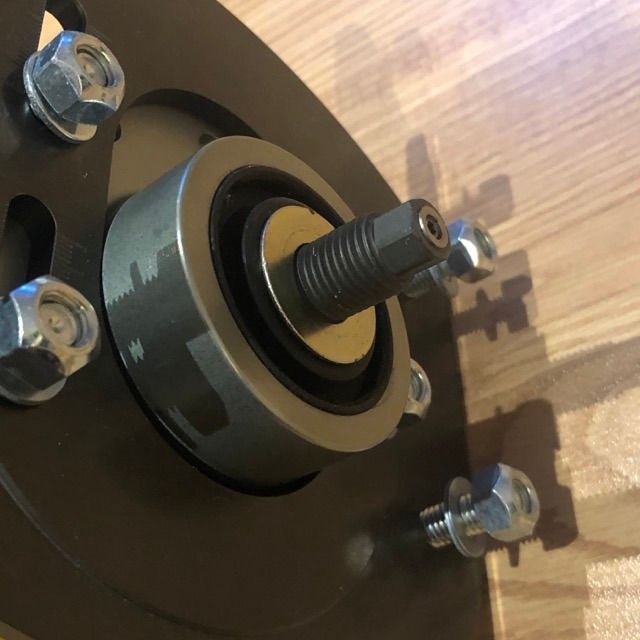

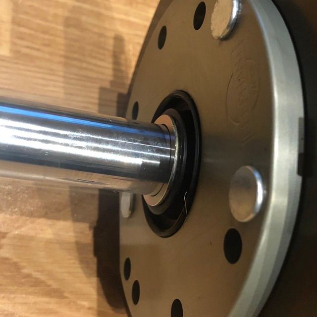

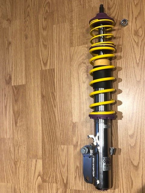

Now onto the front struts - this one's a little more involved.
https://img.photobucket.com/albums/v...n/IMG_8371.jpg
The top of the rod engages into the front monoball just fine; the diameters are correct (OD of the rod versus the ID of the recess in the mount bearing).
https://img.photobucket.com/albums/v...n/IMG_8373.jpg
https://img.photobucket.com/albums/v...n/IMG_8374.jpg
The thread protrusion, without a spring perch installed, is also fine....
https://img.photobucket.com/albums/v...n/IMG_8375.jpg
However, a few things need to be addressed:
1) There is no built-in axial rotation capability of the monoball bearing; this needs to be incorporated elsewhere in the strut assembly, to prevent the spring from winding up when steering.
2) A spring perch does need installing, to hold the spring central to the damper rod. (Oddly, the advice I received from ER a few months ago was contrary to this, saying it's not vital to do so!)
3) Using the stock perch which comes with the strut of course engages onto the step at the top of the rod....but that then prevents the rod sitting up into the recess of the mount, therefore not allowing the thread to protrude. Any perch has this problem; it seems you either fit a perch OR you have it engage correctly into the top mount; the two are mutually exclusive.
https://img.photobucket.com/albums/v...n/IMG_8376.jpg
https://img.photobucket.com/albums/v...n/IMG_8377.jpg

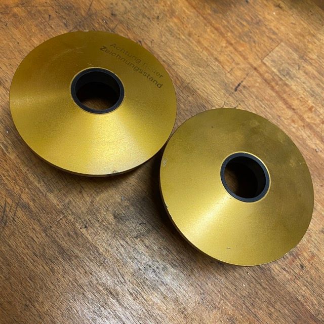

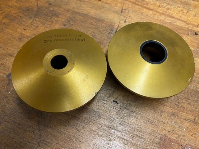

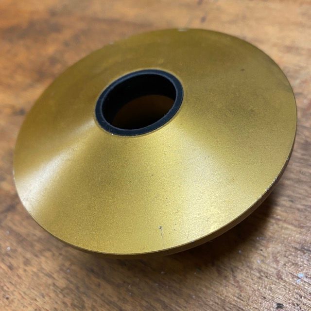

The plan, therefore, is to open the ID of the perch to allow it to slide down onto the larger diameter of the rod, allowing the rod to engage into the mount, as ER intended. However, by using the stock perch means that I'll lose a lot of height adjustment, it's a very tall conical perch.
So...the GT3 perches I mentioned yesterday. Of course, they're meant to install into a 2.25" spring but the added bonus is that they're quite a flat top, unlike the conical KW perches.
https://img.photobucket.com/albums/v...n/IMG_8378.jpg
They still only slide down as far as the step in the rod, same as KW's, but my plan is to bore the ID out to that of the damper rod. I may go slightly larger than this diameter, then make a plastic sleeve insert to make it a snug fit. This will ensure no metal-to-metal contact, not that I think it would be a problem but again it just seems "right" to me. Perhaps I'm over-thinking it, and aluminium/steel would be fine. It's not going to be travelling up and down but would be rotating with the steering.
To alleviate spring wind up, per yesterdays post, I'll be using KW's own lower spring height adjustment platform that has an integrated bearing system, which will replace the stock platforms...
https://img.photobucket.com/albums/v...n/IMG_8379.jpg
These have now been ordered and are about 3-5 days away.

Quick update - the rotating spring platforms arrived from Germany earlier today. Beautifully made, as to be expected from KW, and a very nice - but quite tight - rotational feel to them; they definitely feel very much weather sealed!
https://img.photobucket.com/albums/v...n/IMG_8389.jpg
And installed onto the struts....(stock platform next to it)
https://img.photobucket.com/albums/v...n/IMG_8390.jpg
Next job will be to modify the old GT3 perches, and make some nylon sleeves, plus make some insulator shims for the rear dampers.

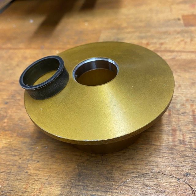

So...why the sudden frantic activity? Well, Dad and I have been working on the first phase of a house project, specifically decorating that requires a 360º scaffold construction around the property. Unfortunately, the easiest way to access the property is through the garage and workshop and of course, the car needs to be somewhere else whilst these guys do their thing and construct it. Because of the construction (I've had it built before, about 14yrs ago, when we decorated it last) I know that it needs to be built in front of the garage door, so of course, the car needs to find a new home for a few weeks until the work is done. Currently, the plan is locked in (thanks to Dads project management work) for early May once the dreadful weather we're having has hopefully gone.
Long story short, I'm on pain-of-death to screw this plan up by not having the car mobile in time. Either that or leave it until the scaffold has come back down again in June (probably), which then means not having the car on the road during the summer. And missing Le Mans. Again.
So, it's now underway although nothing has yet been removed from the car - just prep work this weekend.

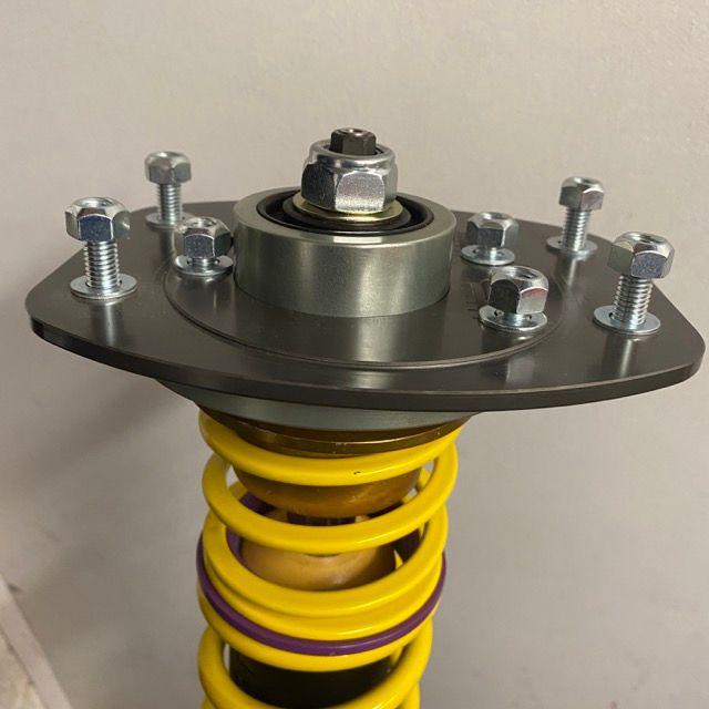

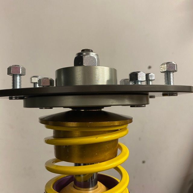

The machining work today was to resolve the previously described issue of KW front struts and Elephant top mounts to play nicely with each other. After the week I've just had, getting back on the lathe was exactly the therapy required - great satisfaction and fun modifying the GT3 spring retainers.
First job was to make the plastic sleeves, which came out really nice using a length of Nylatron. These slip over the larger diameter of the damper rod. Next job, open up the ID of the retainer, and machine a counterbore to receive the "top hat" sleeve. Again, chuffed that this was such a nice snug press fit, no need to bond them in place.
https://img.photobucket.com/albums/v...n/IMG_9159.jpg
https://img.photobucket.com/albums/v...n/IMG_9160.jpg
https://img.photobucket.com/albums/v...n/IMG_9162.jpg
https://img.photobucket.com/albums/v...n/IMG_9167.jpg
As you can see, they slip over the damper rod per the plan, and allow the top mount to drop onto the shoulder of the rod, exposing the full length of the thread through the top of the mount.
https://img.photobucket.com/albums/v...n/IMG_9164.jpg
The nut is only done up as far as the nylon insert - there's a good 6-7mm of thread left to tighten against....
https://img.photobucket.com/albums/v...n/IMG_9166.jpg
https://img.photobucket.com/albums/v...n/IMG_9165.jpg
I've maybe lost 10-15mm of spring height adjustment, but even so, I'm sure there'll be plenty, as I'm not dropping it as low as it'll go - UK roads, let's not forget. If it won't even get to the same height it is now, then I'll just get some shorter springs or forego the helper springs.
