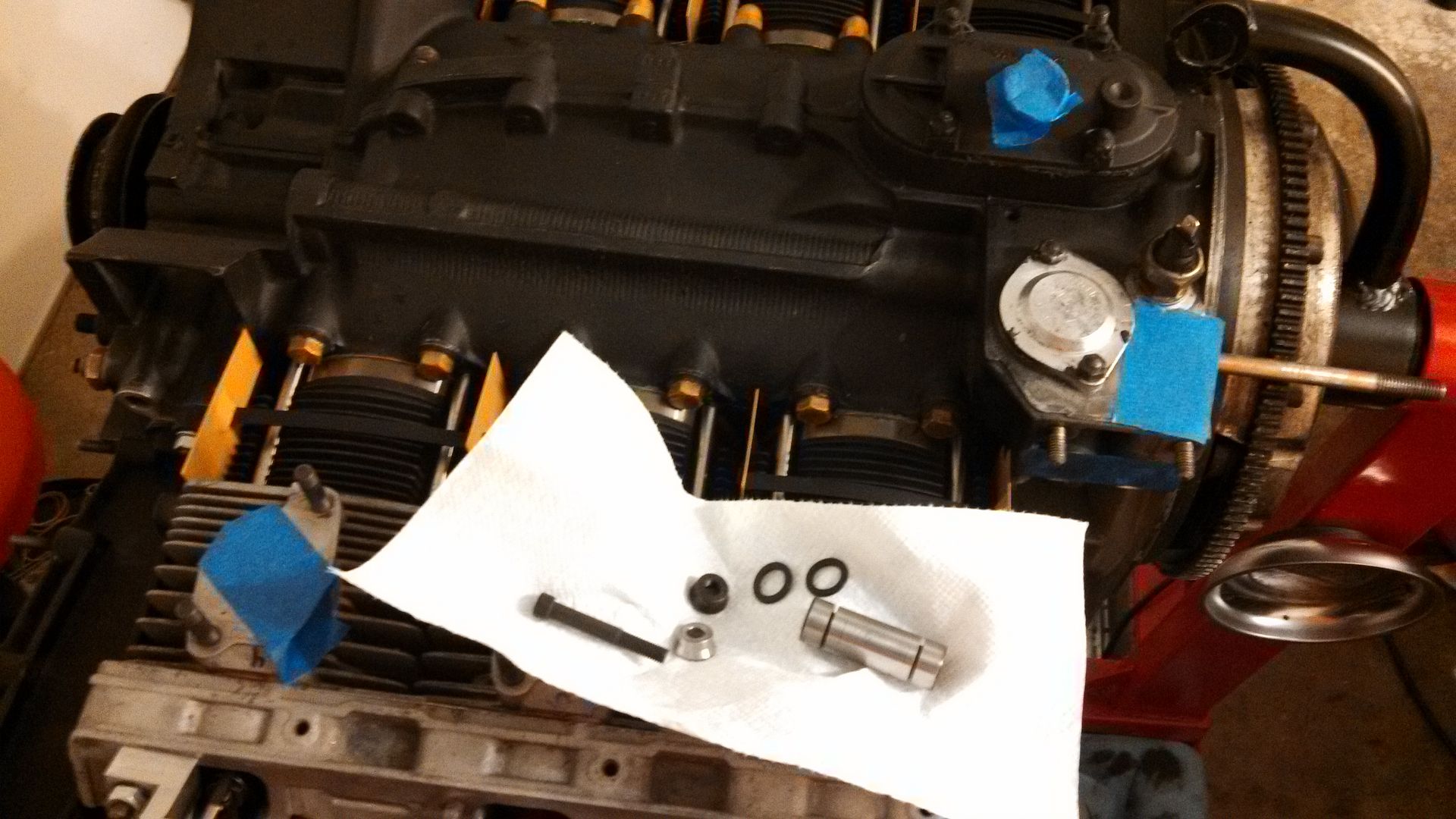

Going back a few steps now that a hectic week has passed. Here's how the rockers went in.
Clean up all the holes with WD40 and a clean papertowel.

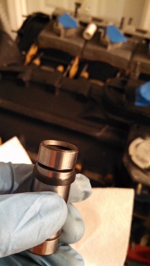

Parts for each rocker... new everything except shaft and adding in the seals that weren't there previously.

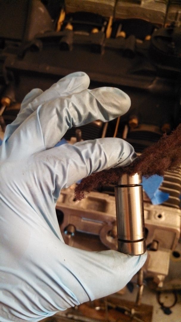

Clean the crud out of the ends with a scotchbrite pad and some brake parts cleaner:
Goal is spotless, clean taper and no debris... you will be surprised at the junk trapped in some of these:
Light lube/oil of the hardware to prevent galling during installation:
Installing the seals and being careful they don't flip inside out...
