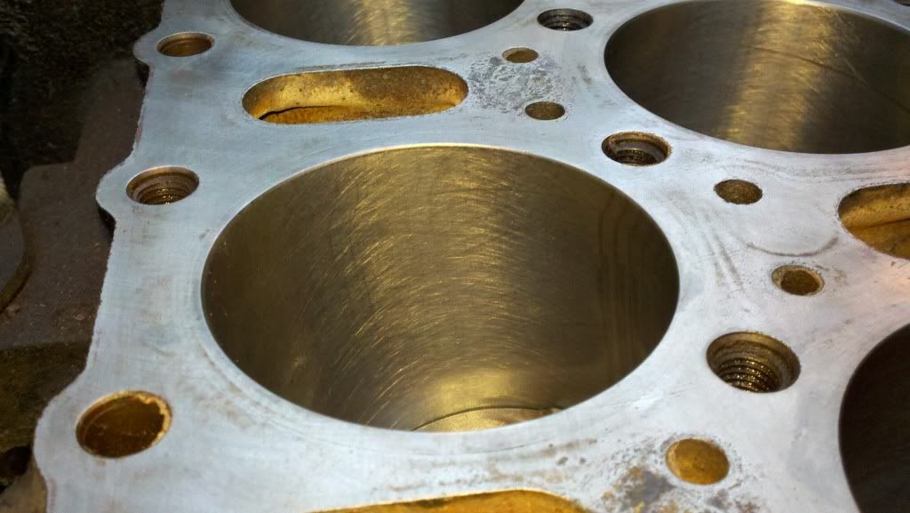

Henry - not to go backwards on a topic but have you ever run an engine that is out of OE spec for piston clearance on the loose end of bore in cast iron? I have, and currently do (not this engine) with an unnoticeable result. The engine produces serious HP with forced induction and consumes only a half quart more oil than a stock engine between changes. Rev is smooth and fast.
Ring gap (cheap rings, Grant brand) is also loose as the engine is due for an over bore by all measures except performance and reliability... which are the most important measures of all in my humble opinion.
Curious what your experience has been: Worn bore, fresh ball hone, new rings, rigorous break-in procedure, cast iron cylinder, synthetic oil after break-in, turbocharged over 20lbs manifold pressure or not if no turbo charged experience on such a creature.
Baseline street tune, ignition yet un-tuned for MBT:
Bore worn loose post-hone:

My personal take on the iron cylinders. They'll be fine. I have a good friend running a twin plug 2.5 long stroke small bore engine that dyno'd at 265hp @ 6xxx rpm. I've watched it run three maybe four seasons without rebuild and he runs 10-12 weekends a year.
I bought a 74 2.7 and plan to build it in the next year or so... Keep us up to date how the cylinders hold up. I may have missed it mentioned, but what pistons are you running?
Thomas
Taking into consideration that the factory ST 2.5 long stroke (70.4 X 87.6) made 270 with racing high butterfly MFI injection @ 8000 your friends engine defies reason. Where was the magic?
Without being too confrontational, I would be willing to bet money that the 265 hp 2.5 does not have cast iron cylinders. Perhaps Birals
BTW: 4 years , 12 club races a year times, 3 hours a weekend is less than 15K miles. 15K on a race engine that spins less than 7K should last a very long time.
Most racing 2.5 are built to turn 8K.

Henry
You are right - I got out a magnet and my 88mm EMPIs are Biral (steel sleeve, aluminum looking cast fins surrounding sleeve). I don't know just why I thought they were all cast iron. Maybe because they are a bit dirty, and I was thinking back 20 some years to when I last looked at them.
But Thomas and others so inclined really should stop personalizing things. We all are, or should be, able to distinguish hype from experience, or at least add our own personal yardsticks and grains of salt to what we read. Politeness encourages thoughtful responses, which are more useful to the rest of us. Very few actually know everything about everything, so there are always things for most to learn. Following discussions often leads to gaining some knowledge (how else would I have realized I was under a misapprehension about my EMPIs?) even if not central to the topic. It really is easy to disagree without being disagreeable. Being known as someone who won't put up with guff, and doesn't suffer fools lightly, is all fine in direct personal contexts. But it really is of no value here. If someone says only X is the way to go, it is easy to say "well, Y worked for me" without rolling around in the mud.
