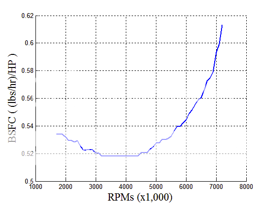

OK, I have done some calculations of fuel flow. I found a graph of BSFC for a 911 SC from this link:
The BSFC chart thread (post 'em if you got 'em) - Page 20 - Fuel Economy, Hypermiling, EcoModding News and Forum - EcoModder.com
which I reproduce here here:
[IMG] photo Fuel_Consumption_911_zps652b666f.jpg[/IMG]
I then converted the BSFC to lbs/hr/HP (Americans can think in metric units):
[IMG] photo BSFC_zpsb33a0ca0.png[/IMG]
I do not know the quality of the data, but it is the only BSFC curve I could find for 911s, but all BSFC curves I saw for other vehicles had similar shapes. This graph confirms Stan Weiss's BSFC = 0.52 for a moderately modified engine. However, above 4,000 RPMs, since BSFC rises, the engine is getting less efficient (takes more fuel flow to produce 1 HP)--and is approx 0.60 at 7,000 RPMs. Now, to figure out the demand on each fuel injector, I multiply BSFC by HP and divide by six cylinders, which yields this graph:

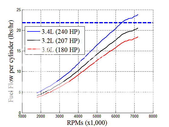

[IMG] photo Fuel_Flow_V2_zps8ff88a9a.png[/IMG]
So, the max fuel flow occurs at maximum RPM (not maximum torque and not max HP). I also used the BSFC plot to calculate the fuel flow for a theoretical stock 3.2L and a 3.4L with 240 BHP using the same BSFC curve. (Yes, the Carrera and SC have different fuel injection, but the BSFC shouldn't vary much). I also drew a horizontal line showing the limit of the fuel injectors (21.8 lbs/hr). Thus, a 240 HP 3.4L will probably start to lean-out above 6,300 RPMs. Does that check with 3.4L owners? but, back to my "crappy dyno run," since I was only producing approx 200 HP, my fuel injectors were probably not the problem.

I sit corrected... Teach me to reply from work without looking at my data....
