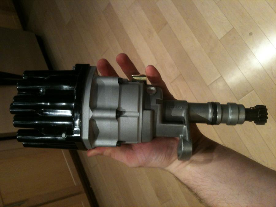

The easy part is drilling/tapping the head and putting the spark plug in (assuming you already have the engine apart).
The expensive part is the twin plug distributor. Many people go with a crank fire or other form of electronic ignition to avoid the distributor cost. You could also do a 964 distributor. Or pay for the correct looking 12 terminal cap type.

Do the twin plug. Keep the compression.

But how could you say no to this ...
