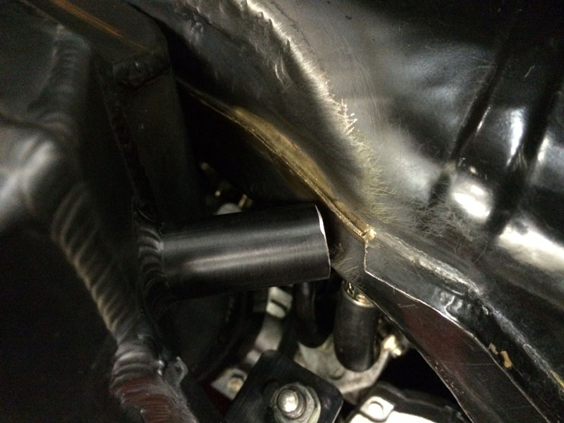

930/66 08-26-2014 05:32 AM
Installing Engine Cover / Brackets / Oil Return Pipe
Installing Engine Cover`s and Bracket`s:
http://forums.pelicanparts.com/uploa...1409059778.jpg
http://forums.pelicanparts.com/uploa...1409059809.jpg
http://forums.pelicanparts.com/uploa...1409059820.jpg
http://forums.pelicanparts.com/uploa...1409059871.jpg
http://forums.pelicanparts.com/uploa...1409059893.jpg
http://forums.pelicanparts.com/uploa...1409059916.jpg
Installing New Oil Return Pipe:
http://forums.pelicanparts.com/uploa...1409059934.jpg

930/66 08-27-2014 08:31 AM
Installation / Problem LLK
First i must say the Parts look good and the Customer Service from Chris is nice!
The Intercooler-Kit had 3 errors:
#1 conflict with the air filter box
#2 connection to supplementary air slide wrong
#3 Connection to the turbocharger intercooler welded wrong (can`t close my tailgate)
I have changed the air filter box and cut the connection for the auxiliary-air device
#3 make my Welder right. Chris send me the reimbursement for that, Thanks Again!
