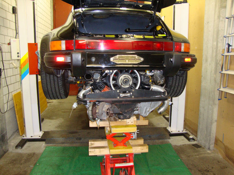

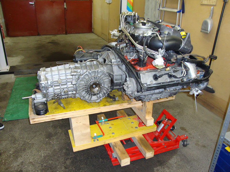

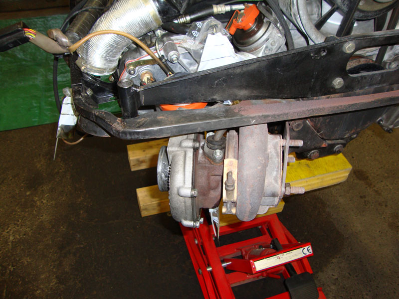

engine removal
Helpful Tool from a Friend:

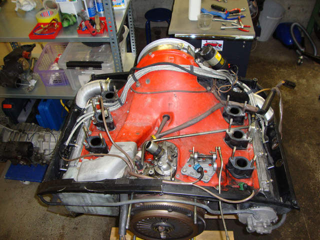

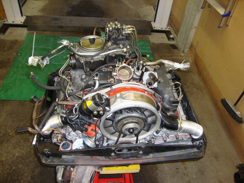

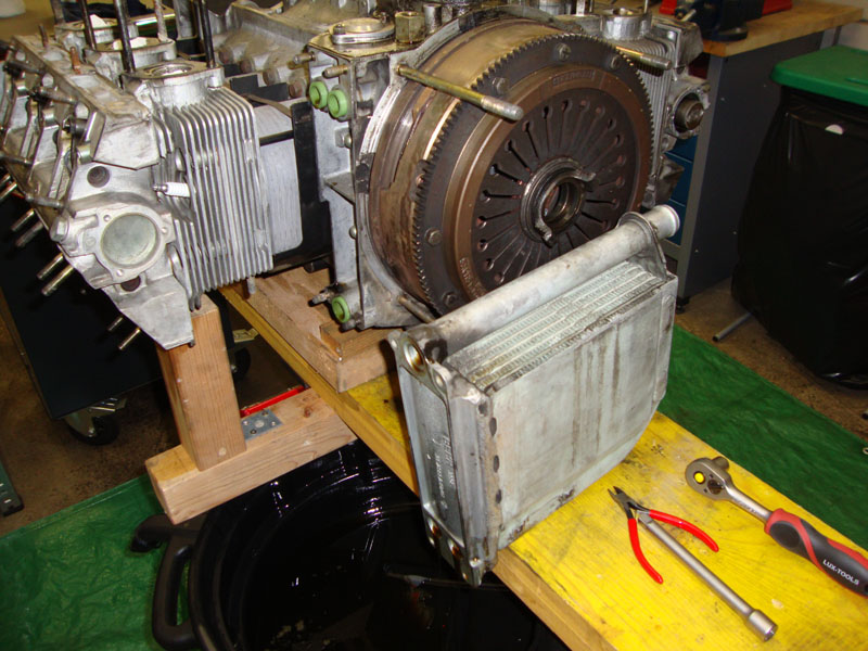

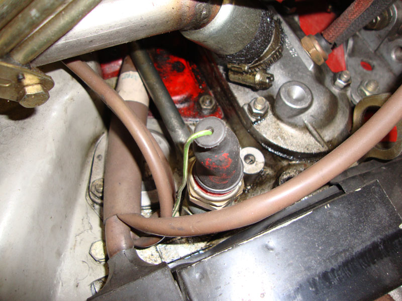

before I had the motor removed I always expand the heat exchangers, Intercooler and airfilter box.
generally ran the motor without problems with little oil leaks

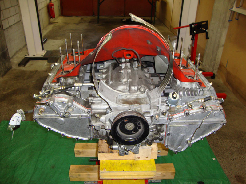

start with strip down the engine
87 930 3.4, BW EFR 7670, TK Long Neck IC, Fabspeed Headers, 964 NW`s, Ported Heads, Tial F46 (0.4Bar Spring), Turbosmart EBC, BL WUR with rpm switch /solenoid, SDS CPI Ignition, modified Muffler, and many other little mods
Old 07-08-2014, 09:05 AM
930/66's Avatar
Join Date: Sep 2011
Location: Switzerland
Posts: 307

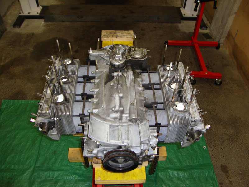

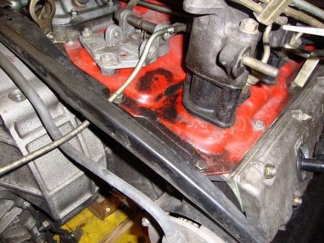

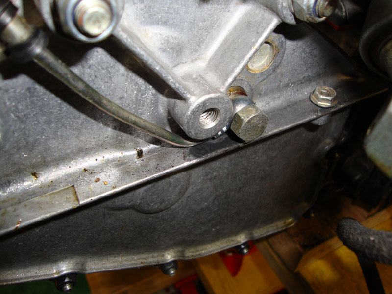

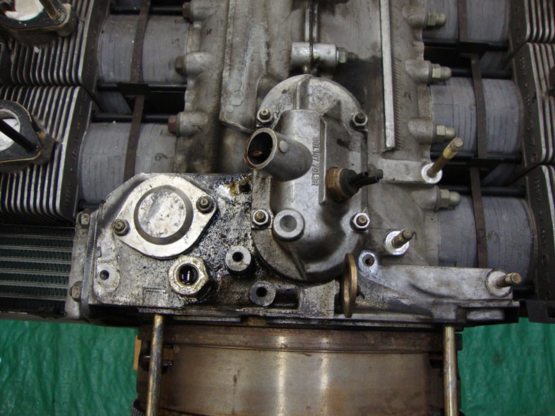

Strip down
Good old 3LDZ
another Oil leak left side

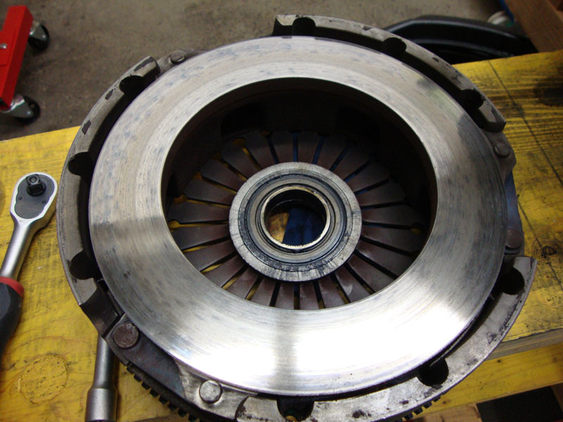

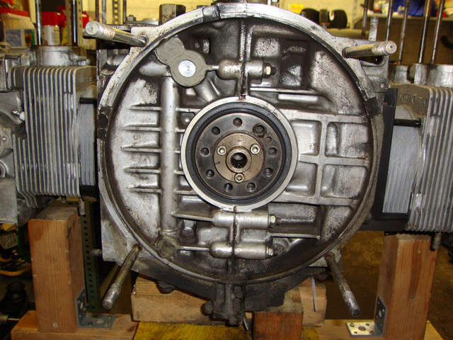

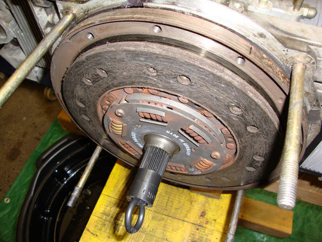

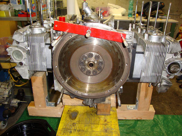

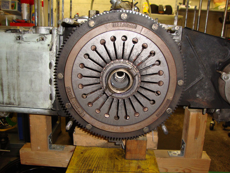

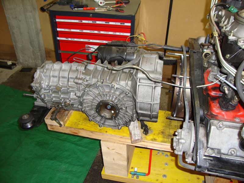

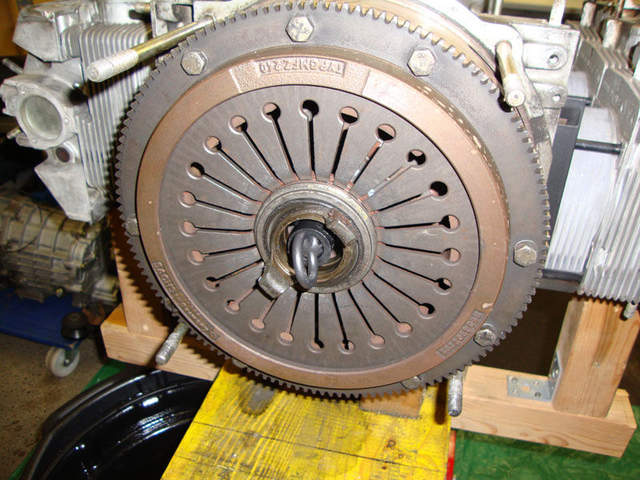

Clutch and Flyweel removing
last change of the Clutch is 45t Miles ago (with about 413 Pound Force on the Crank)

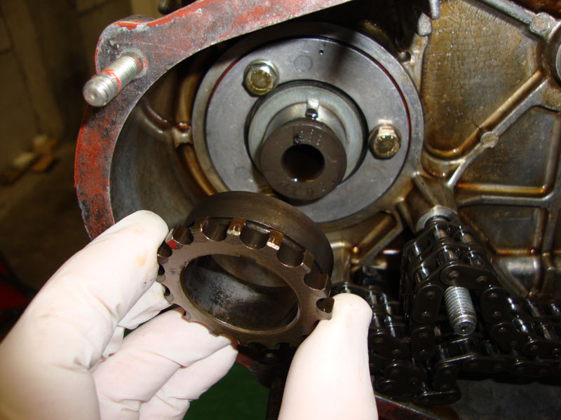

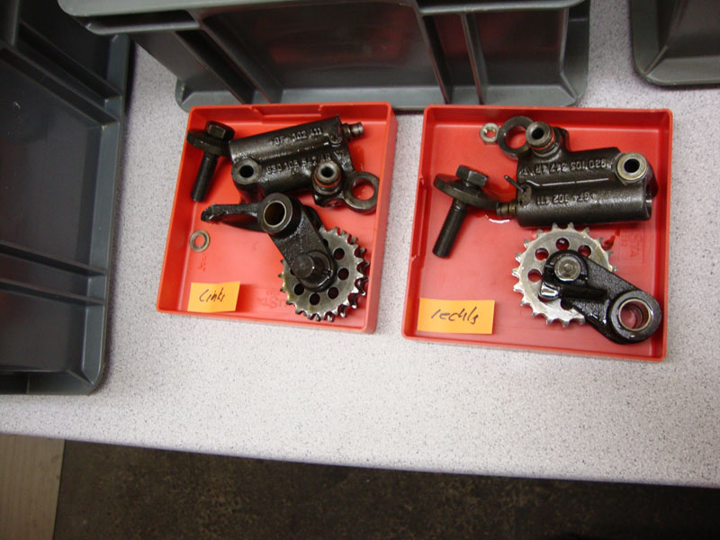

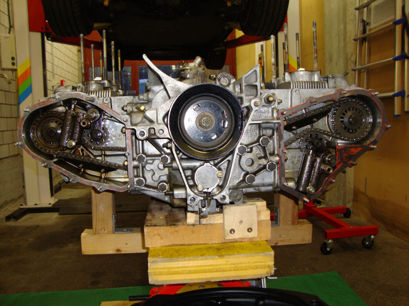

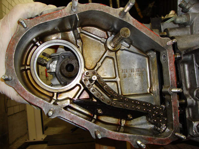

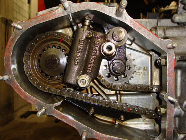

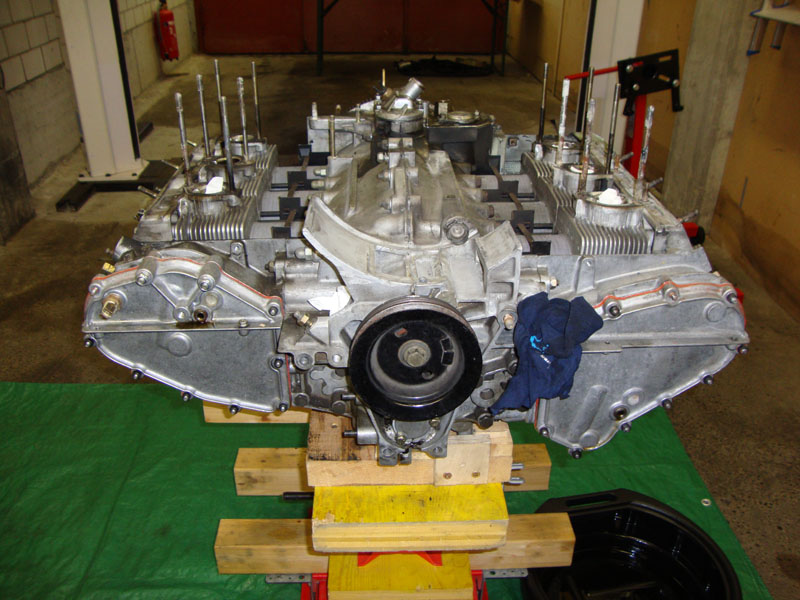

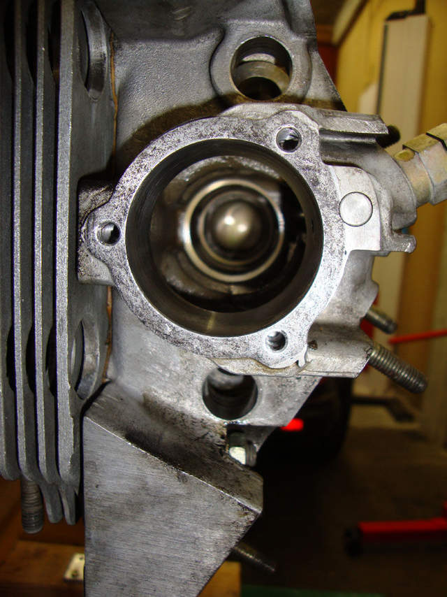

Tensioner, Camshaft sprocket, Chain Housing Removal
Chain Housing left Side
camshaft sprocket flange
endplate
left chain housing

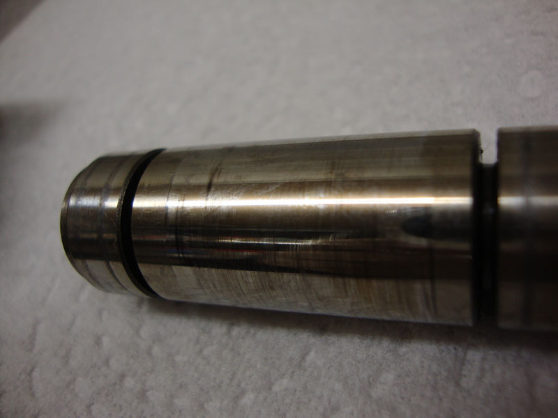

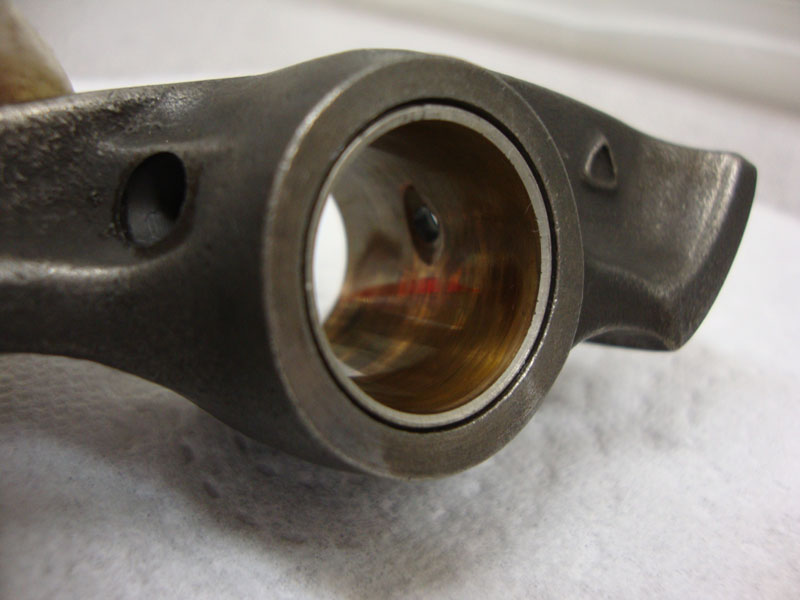

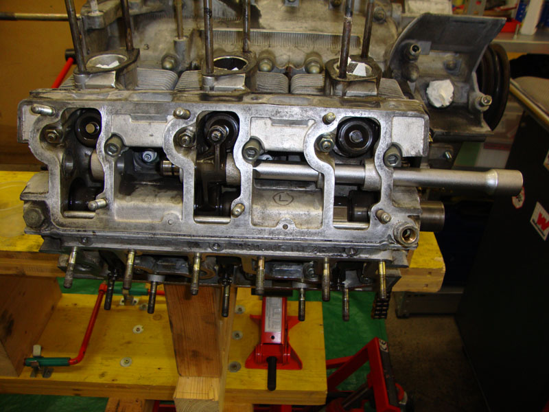

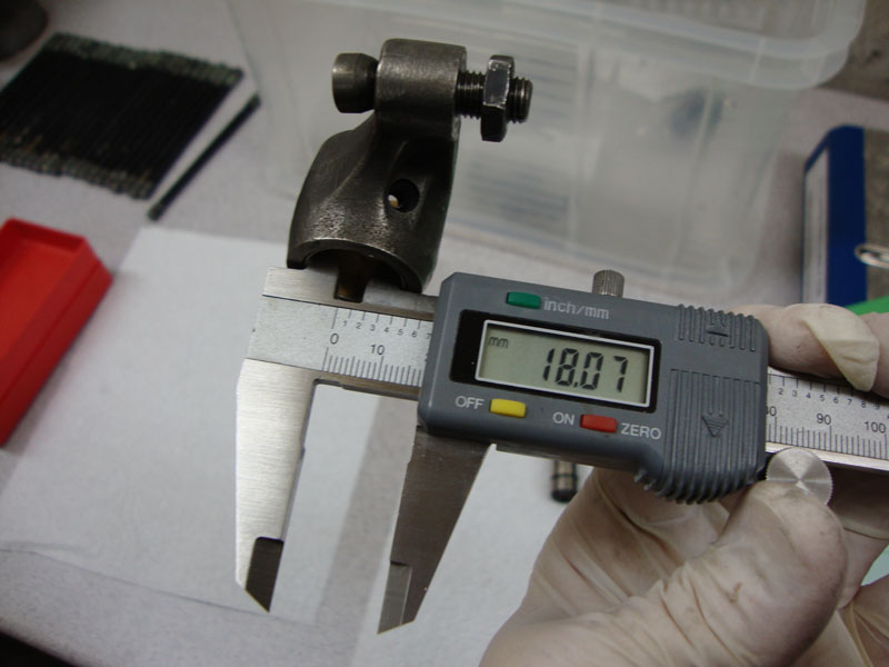

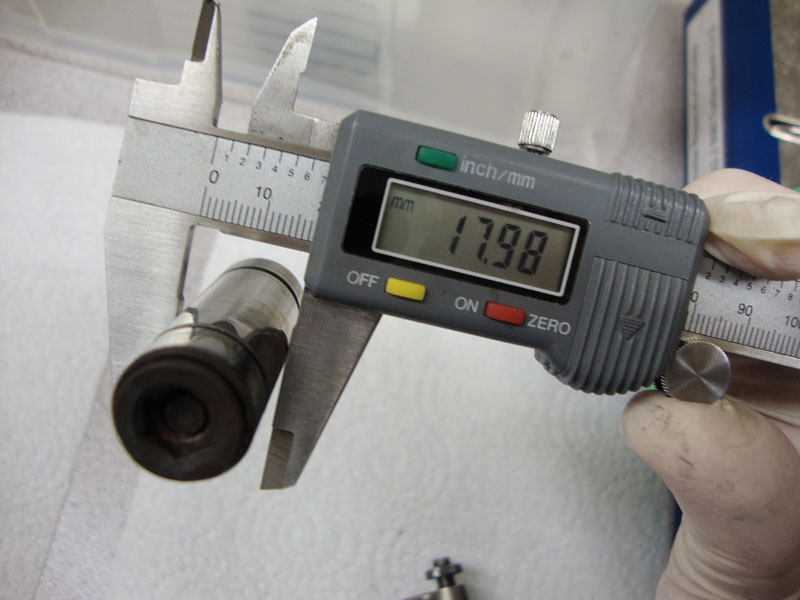

Rocker Arm, Camshaft Removal
remove all rocker arm and shaft components no oil leak at all
some wear
remove camshaft from housing

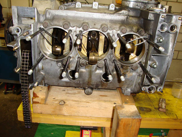

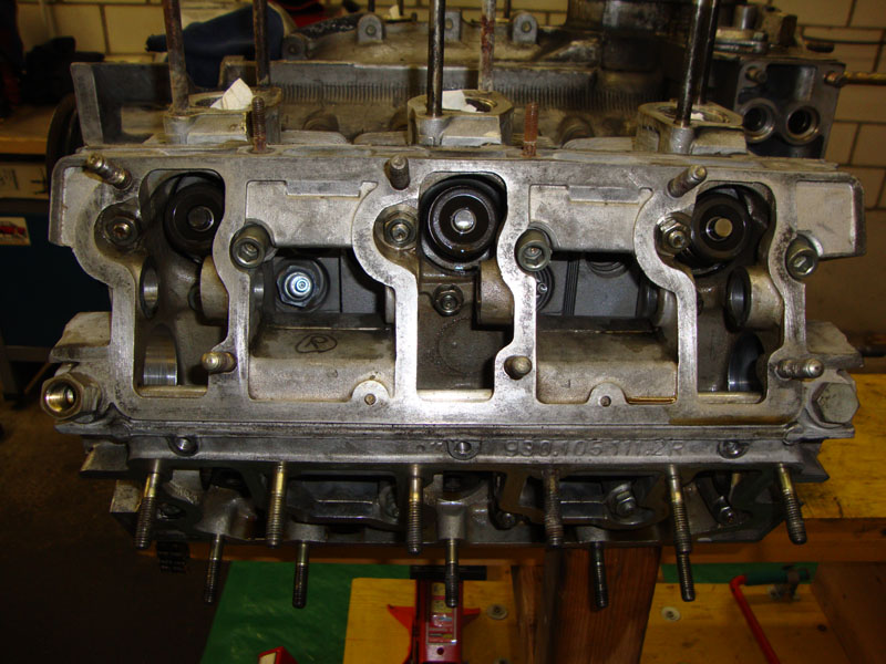

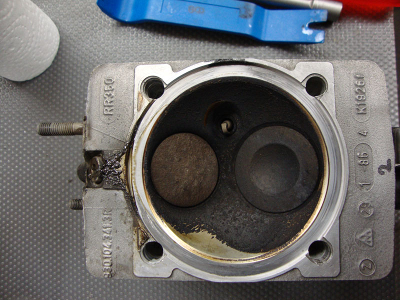

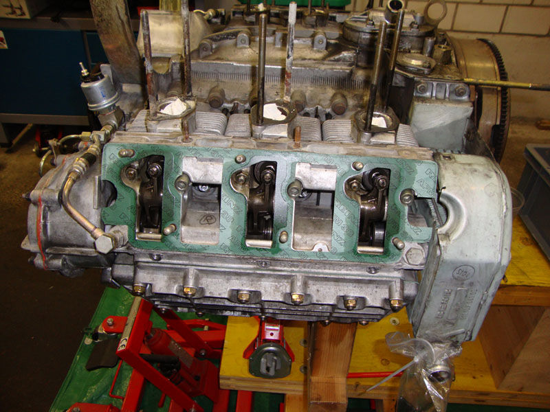

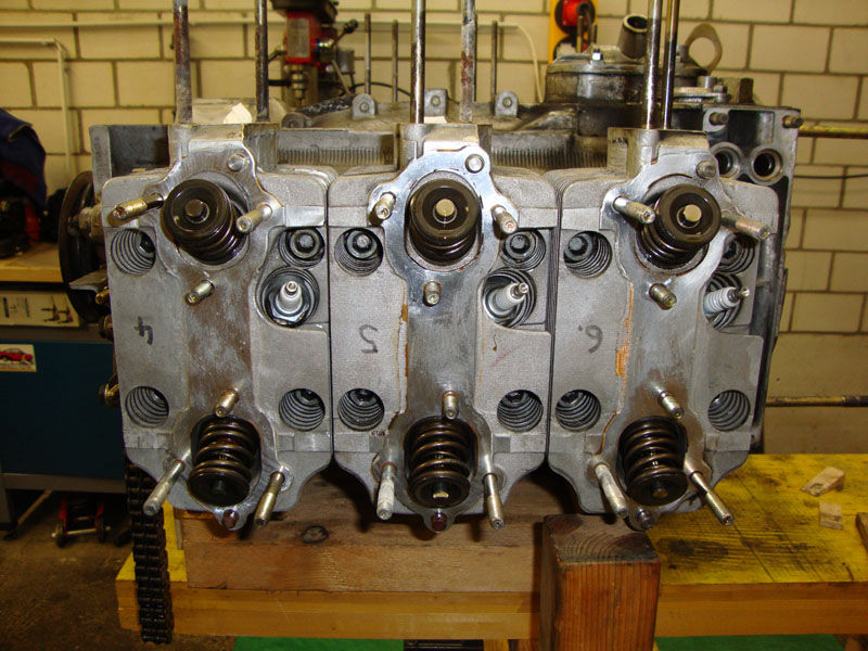

Camshaft Housing / Heads Removal

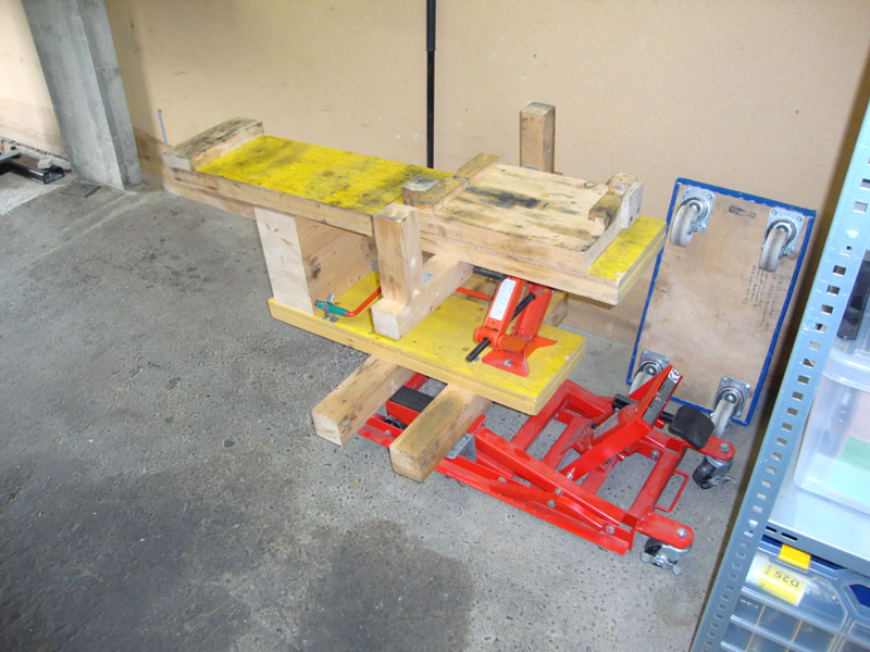

believe me there are many more pictures
I have see it in the newsletter i love this section:
And check out his home-made engine and transmission stand!
he is really practical for working, the angle can be easily adjusted for removing and installing

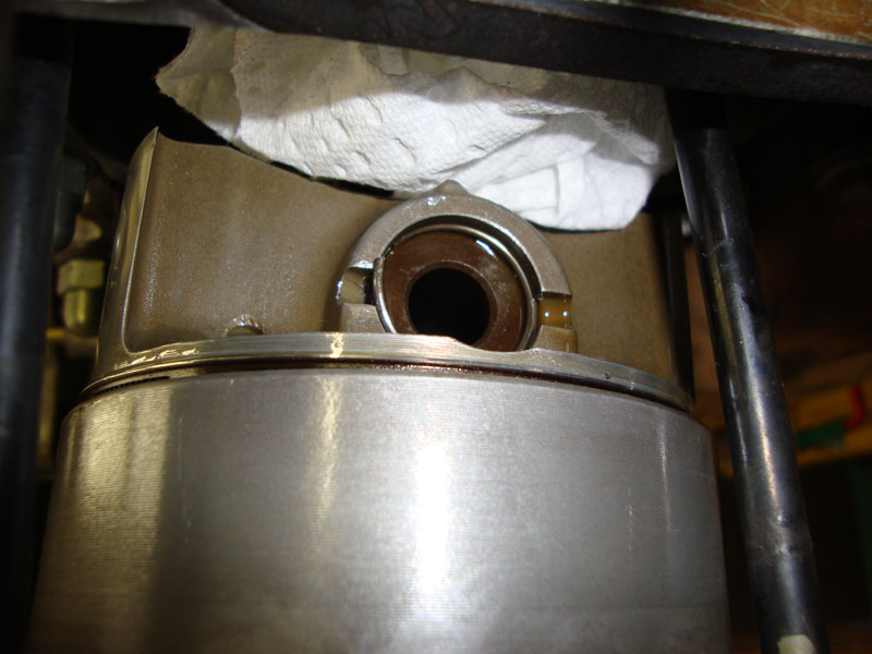

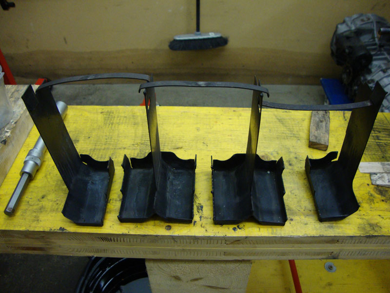

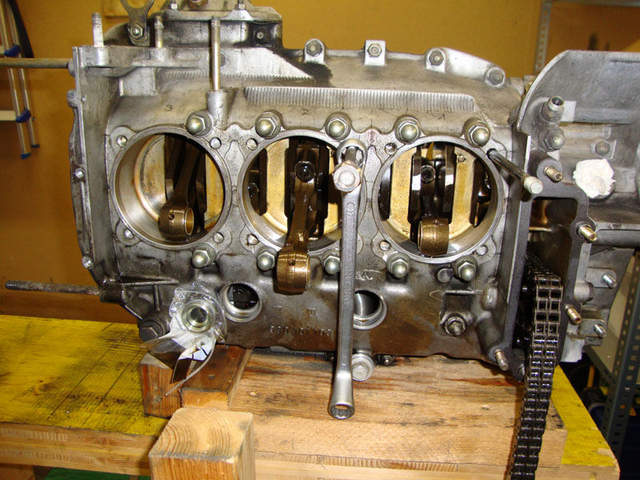

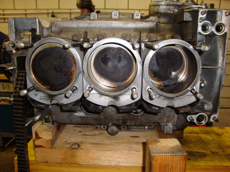

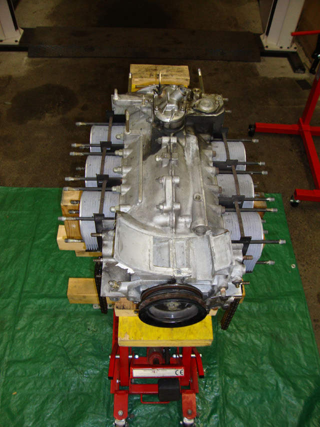

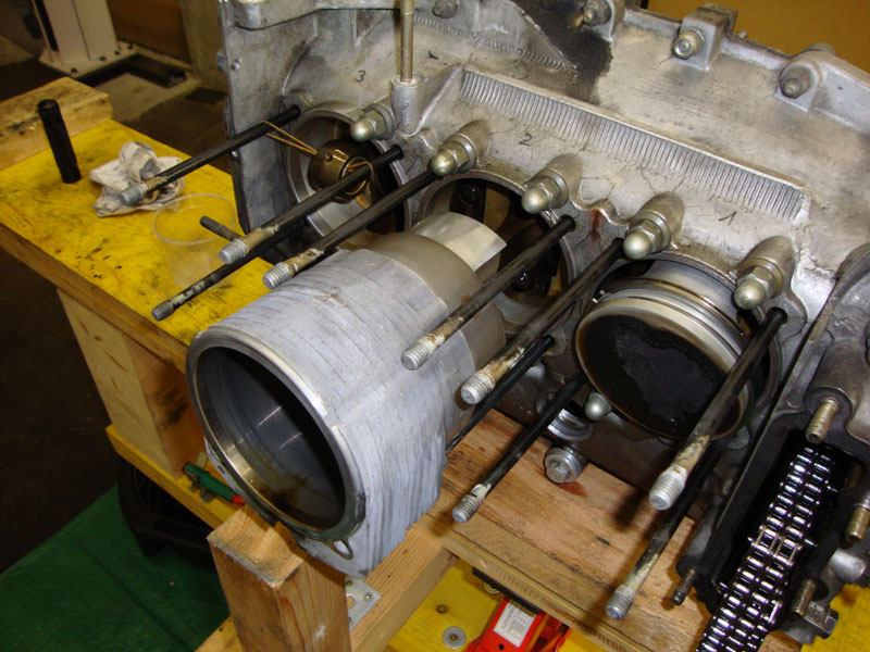

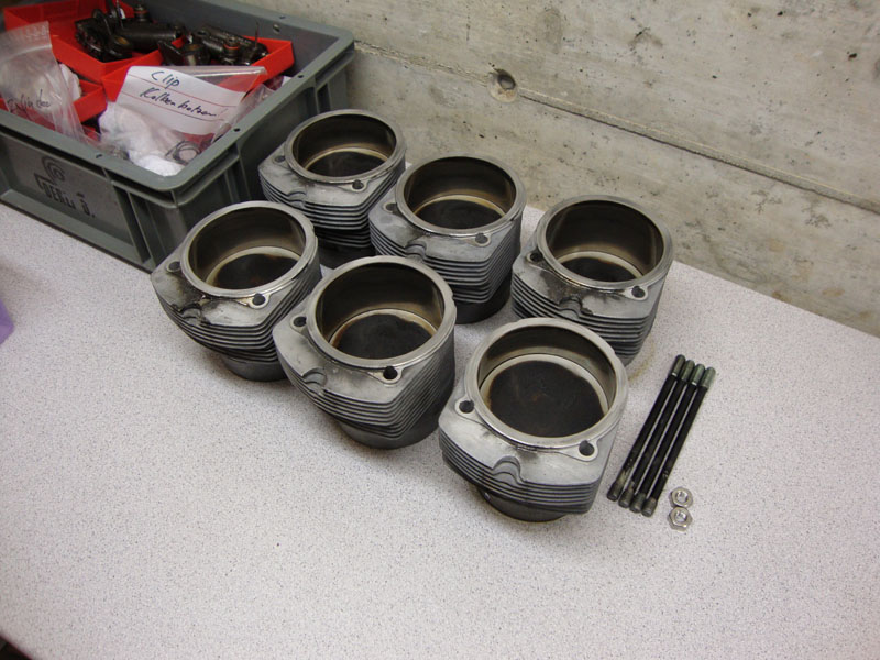

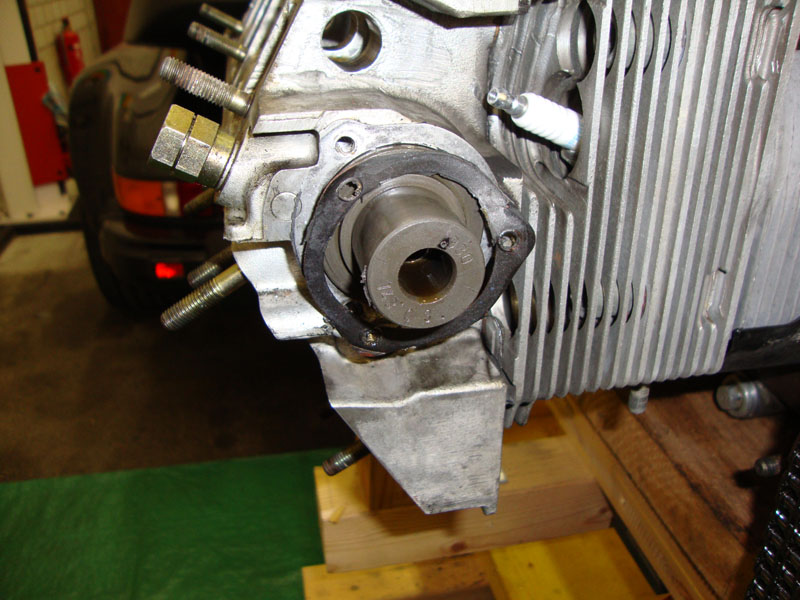

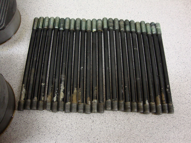

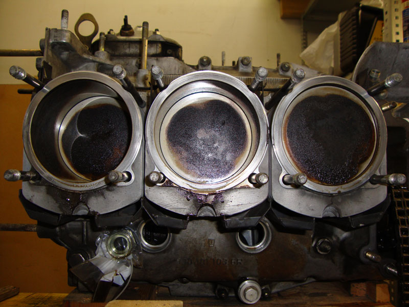

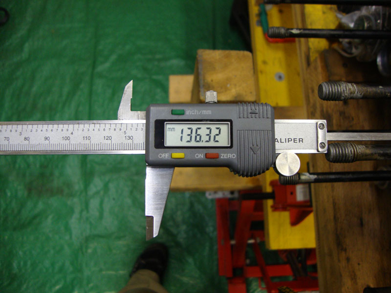

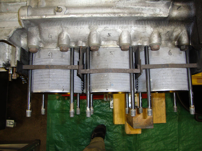

Removing Air Guide Plates / Piston Cylinders /Dilavar Studs
air guide plates
removing pistons and cylinders
dilavar studs / just 2 off 24 have make some problems (heating the loctite helps)
just with 2 nuts an 2 wrench
