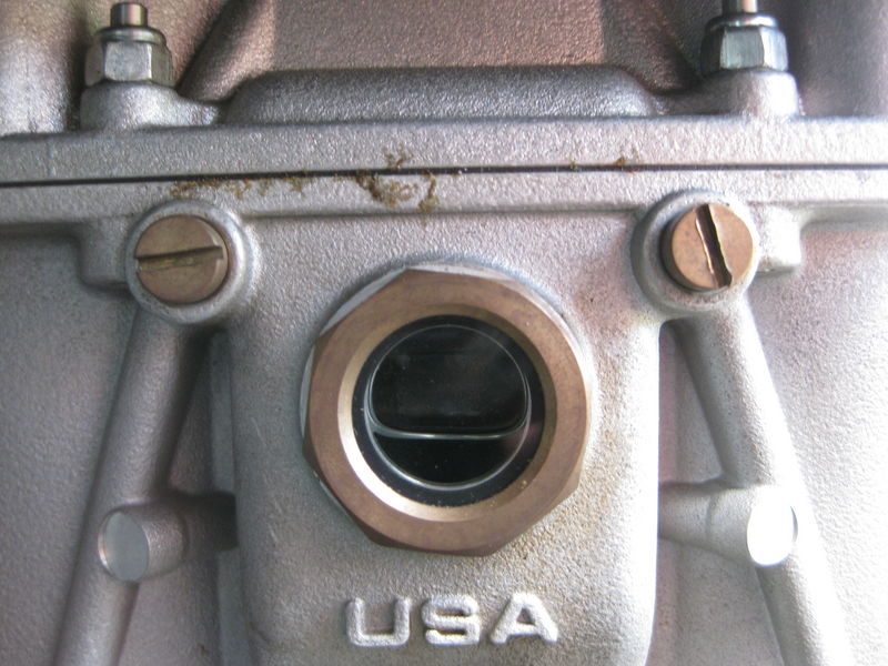

OK,
Pierburg fuel pump is installed - I'm at a steady 3.5 PSI. I'm not a fan of the universal pump by the way.
Meanwhile I'm going very lean under load (AFR reading of 15-16 and climbing at ~3,000 RPM when I let off).
My float bowls appear to be below the 1/2 mark - so I'm going to dig into adjusting the floats next.
Any tips or recommendations for adjusting the PMO floats?

Gordo2's Avatar
Join Date: Sep 2002
Location: Quantico
Posts: 1,924
PMO Float Level
Found some level ground to take a few photo's of the current float level (while running).
Looks rather low to me:
I couldn't get a good photo showing both float windows in the same shot, but in general the levels are inconsistent.
From everything I've read - it's important to have the float level set to a point that the fuel is midway up the window (some PMO windows apparently have an etched center dot - mine do not).
Will be adjusting to get each float / fuel level to the mid-points.
Gordo
