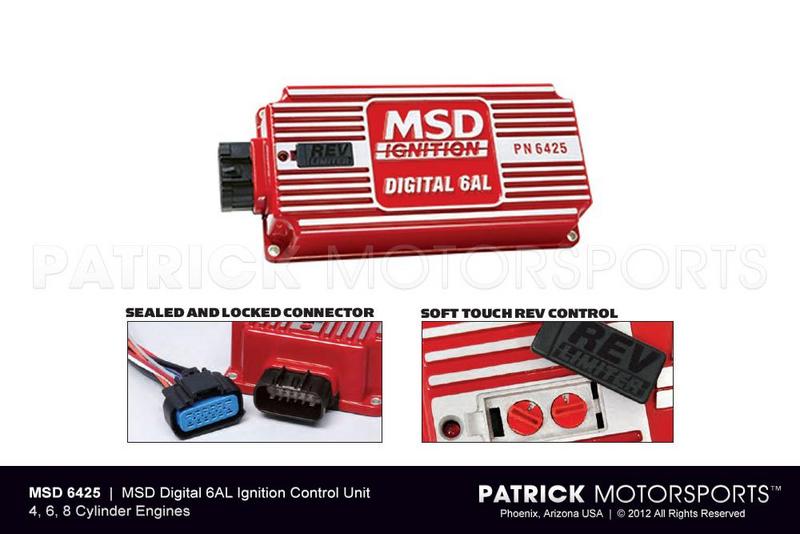

Next collection on my list is ignition for the dual plug set-up.
I have a used 964 distributor that needs a rebuild kit - where do I get such a thing???
The dissy came with a twin coil pack and this housing.
http://forums.pelicanparts.com/uploa...1448577896.jpg
I know I need new ignition cables etc, but what else do I need to make it functional?
I understand Andial signal splitters are scarce these days, so is this what I need?
http://forums.pelicanparts.com/uploa...1448578082.jpg
