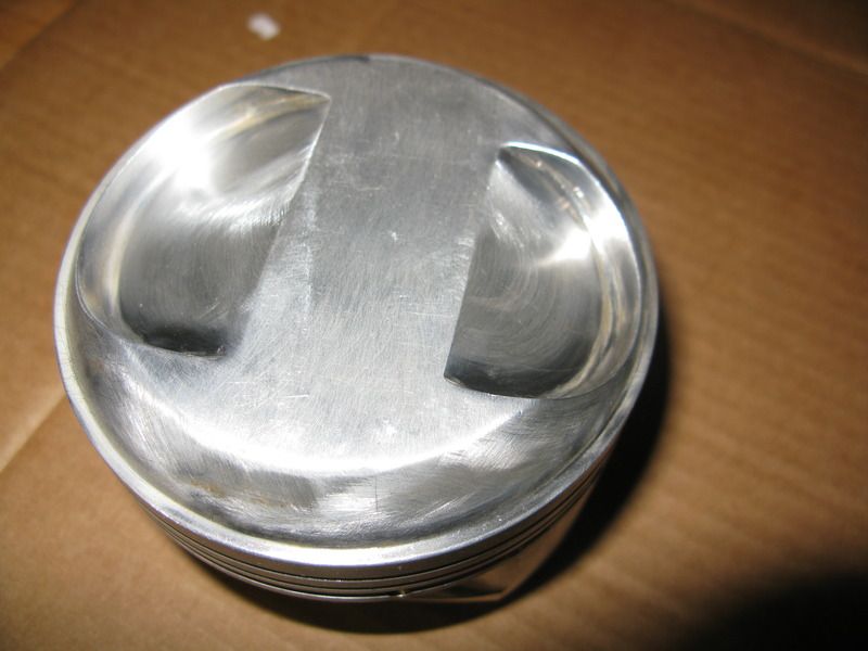

It all starts around the pistons and cylinders so after some reading and investigation I opted to give the QSC pistons and cylinders a try. I have noted that some regular contributors on our forums use their cylinders, but have opted for JE pistons. I decided to give the QSC P&C's set a try and measured the pistons and cylinders extensively when they arrived.
Pistons
I measured the pistons at the crown where the rings sit in a North-South & East-West measurement and then again at the skirt at the bottom of the pistons at the widest point. All Pistons measured between 99.69 to 99.73 on the upper N-S & E-W measurement.
The skirt measurements had a variance between 99.93 to 99.95.
All in all I think the tolerances are pretty reasonable. I was using a digital micrometer.
Manufacturer claims the compression ratio on factory heads is 11.2:1
I dont believe this to be accurate as much of the reading I have done on this forum shows me that claimed CR's and actual CR's OFTEN seem to vary.
My problem is, I dont know how close that number will be to reality and if it isnt, I dont know if it will get higher or lower in reality. Im also not sure how to measure it without a burette or more sophisticated tools.

I noticed there are no valve pockets cut into your QSC pistons. I understand CIS pistons do not have the valve pockets because of the SC cam design. With your WEB Cam 20/21 you will have a .485"/.452" valve lift. The QSC piston domes do not look like the stock CIS piston tops. Maybe with the 20/21 duration of 258*/246* it will work out but it just caught my attention.

This is what the JE 3.4 pistons look like:
The valve pockets are deep.

Allan, When you ordered the pistons did they ask you what cam you were going to use?
The more I look at those pistons I think they just forgot to cut out the valve pockets. The piston dome looks to be about .350" to .450". There would most likely be some valve to piston contact. Also sense your keeping the CIS there seems to be no help from that dome to give the correct CIS flow path.

If I read the OP's first post correctly, he's got an 85 Carrera, so it should be a Motronic engine not CIS. The GSC piston domes aren't that different from the stock Mahle Pistons in my 3.6. Here's one of mine:
Obviously, the valve-piston clearance needs to be measured to be sure that everything is going to work together. But, the general piston shape should work with the Motronic if the compression ratio is okay and the valve-piston clearance is safe.
