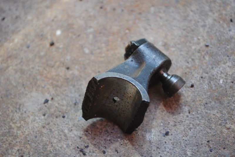

My lower rocker on number 3 cylinder snapped in half while the engine was running, snapped around the rocker shaft mid way around the circle.

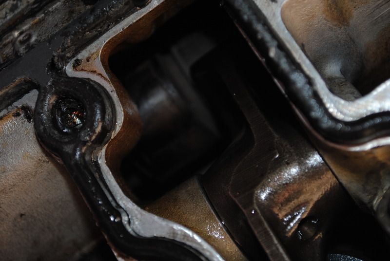

I was hoping that was the only problem however looking up to the camshaft I can see that it's bone dry, this happened 9 months ago but I've only just got round to taking things apart as I've been working away so I've only just found out what was causing the problem.
I know that after 9 months the cam would not be dripping in oil but wouldn't expect it to be bone dry. There's no obvious wear marks on the cam the lobes feel smooth.

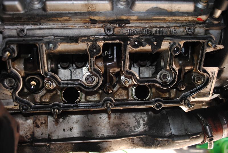

Another thing that was unusual was that the rubber cam cover gasket had partially melted onto the engine.
I'm guessing that there's been a blockage to the oil supply to the the left bank, possibly overheating and causing friction to the rockers on their shafts which caused the rocker to break.

If you had a blockage in the feed you'd be seeing scoring on the rocker face and cam.
It will happens in seconds if it goes dry.

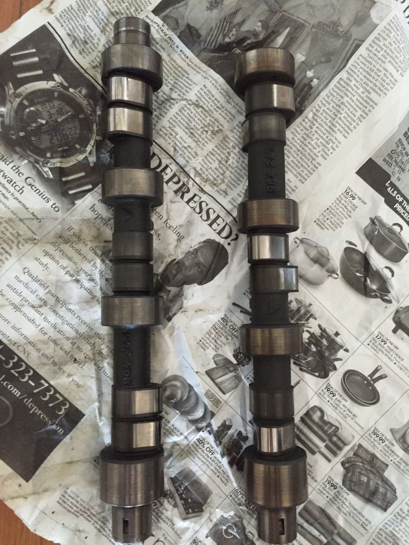

I was very lucky, I had some blemishes on the rocker and cam lobe but no grooves that I can feel with my finger nail.
But, it did damage my bushing so I swapped it for a new rocker with bushing in it
She is an aggressive Street use daily so I was not too worried, if track car I would have changed the cams.
But I could not help myself and opted to do a 964 Cam Shaft swap and verify timing, yeap timing on my 3.2 cams were WAY OFF spec. 1.10 & 0.85

Or it looks it to my old eyes. That cam wont be happy either.

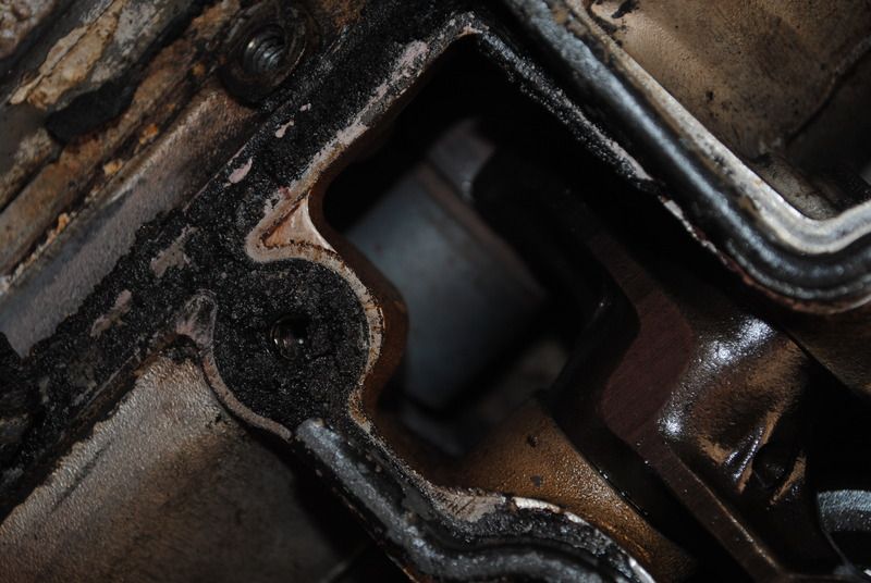

On further inspection there is a very slight groove on one of the cam lobes, it's very minor and difficult to feel but I can see it, also as you can see from the pics the lobes are not shiny silver but have a grey/blue tinge.

Yes it is dry, also you can see that the rocker gasket has melted to the engine with the heat, also some of the rocker cover studs have come out instead of the nut, the studs seem to be bonded into the cam housing, there's a black sticky substance which seems to have melted causing the studs to come out.
I think costly as this is going to be, I've dodged a bullet as the cam didn't seize which could have wrecked the engine.

I would remove the other rockers and look at those faces as well.
I was wondering what caused the charring, now we know. Sorry to see these Brother, I think your suspicions of a blocked sprayer/s are warranted. Wow a nightmare.

Taking a second look at your pics, I think that is the back side of a lobe, which should not be shinny, FYI.
Can you show the face of the broken rocker?
