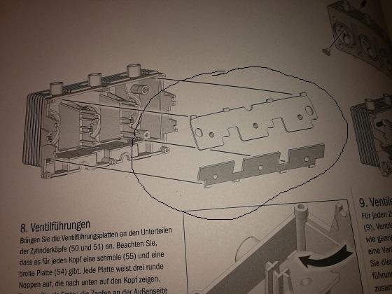

jrblackbox - Ahh yes, the presents to ones self are always the best! Just a note on rocker binding on cylinders 3 and 6 as mentioned in my original post. Shortening the axial length by around .020" using a fine file cured the problem. The picture shown below should clarify what I'm trying to say.

hi boys i am doing one now and after i have opened sealed box i am missing the valve guides plate.Anybody has the same problem?
Ivan
Old 12-24-2017, 08:00 AM
jrblackbox's Avatar
Join Date: Aug 2016
Location: Orleans, MA
Posts: 152
not missing mine.
