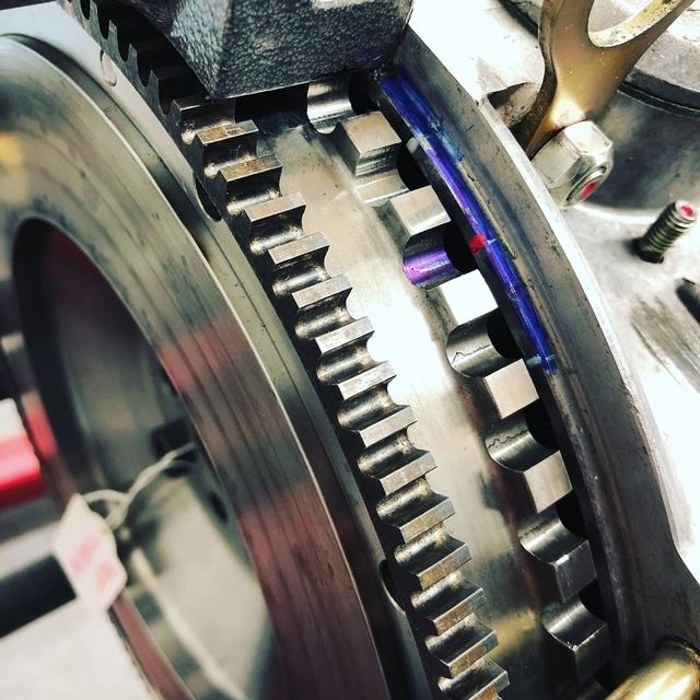

Measuring TDC with a dial indicator gets you pretty close, but the crankshaft can move several degrees while the piston is stationary at/near TDC.
The recommended procedure is to use a positive stop described by ChrisBennet (post #9). However, introducing a hard stop through the spark plug hole can be risky if the valve train is intact (possible valve interference).
The slim probe on this "through-spark plug" tool seems to avoid potential contract with opening and closing valves that might not clear with larger stops. Back off the valve adjustment to limit valve lift.
With #1 head removed, a simple TDC tool can be made with a flat plate bolted across the top of the cylinder and a bolt and two nuts through a hole in the middle as a piston stop. This is a commercially available TDC plate.

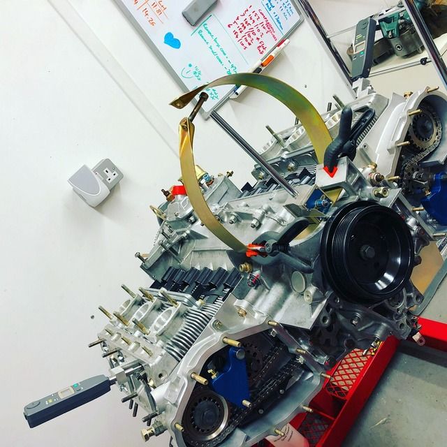

I like the look of the spark plug stop tool, however, I struggle to get my head around the fact that the dowel-based cam sprockets only allow you to "use this hole, or that one"...it's not that granular, unlike other vernier cam sprockets with infinitely adjustable inner/outer halves, with 3 or 4 bolts that lock one to the other. I'm surprised somebody hasn't developed these for our (aircooled) engines; maybe they're used on the water cooled lumps, no idea.

It isn't obvious, but if you treat the holes like short "slots" you can get finer adjustment than just putting the pin in the hole and torquing it down. Getting the cams timed th same side to side is generally considered more important than their absolute value. I like to use 2 dial indicators, one on each bank. That way if I run out of adjustment in the sprocket "slot" on one side, I can adjust the other side "back" to make them even.

I agree, the one locating pin seems suspect in terms of accuracy. Turns out on my motor the Z1 was spot on.

Yup, exactly what I did; 2x Mitutoyo Digimatic DTI's on Z-blocks one on each bank simultaneously. A razor blade held on the crankcase to mark my absolute TDC (case parting line nowhere near accurate enough, IMHO), and I was successful in getting exactly 1.26mm on both banks - exactly what I was aiming for with max advance on 964 NA cams, so was chuffed with that...all inside a couple of hours one evening.
