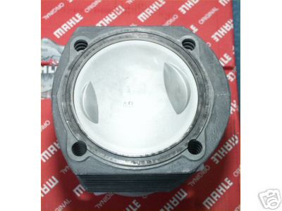

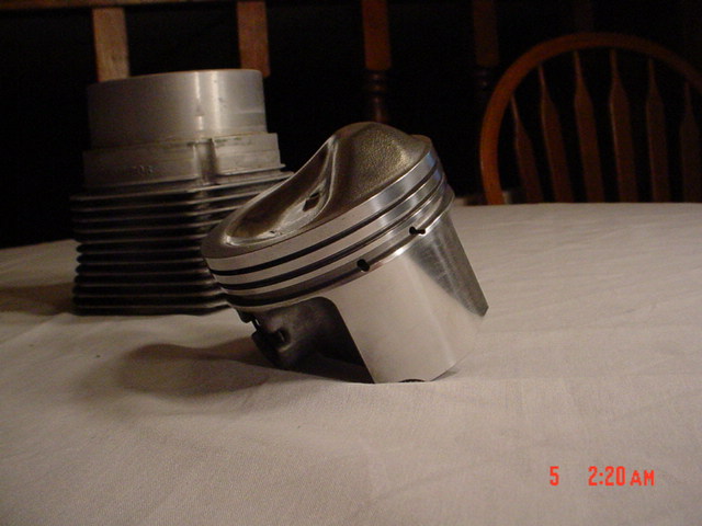

OK, to make it more clear,
the first bowled piston came with the 2.4T CIS:
vs. the previous domed ones used in carb or MFI applications:
continued in the same way "bowled" for for 2.7 CIS
vs. domed in 2.7 MFI
Question again: Why did they do the bowled ones for CIS (i offered a theory in the initial post)
And: Does CIS really need the bowled pistons or is a CIS application capable of creating a reasonable air/fuel mix in the combustion chamber with domed pistons?
