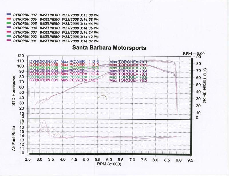

I just got back from Santa Barbara Motorsports after dyno'ing my stock R12S with only a full-Akrapovic exhaust and oxygen sensors connected:

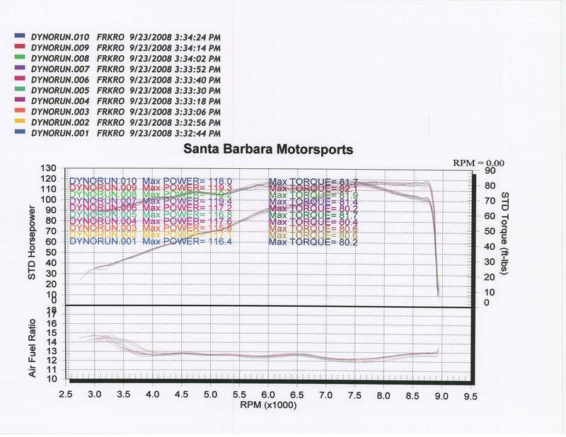

And again with my new Blue air filter from Santa Cruz BMW and my PowerFRK plug-n-play trickster module. I did the change-over while the bike was on the dyno in about 5 minutes. Here are the results:
As you can see, both HP and torque are up noticeably. So it's not just the fact that my wallet is a bit lighter. Also note the A/F ratio is dropped significantly too. and the A/F gyrations are more tame at low RPMs, which might have something to do with my perception of smoother off/on throttle transitions? In any event, I'm very happy with the combo. Unfortunately, I didn't have the $$ to do a run with just the new air filter and no FRK or just FRK and stock air filter, though Robert says that my unit is optimized for a hi-flow air filter and full exhaust. Apparently, they can even retune it slightly if I want. Keith at SB Motorsports says that the A/F ratio is probably even a little too rich. Time to go for a ride

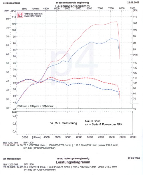

Another data point was sent to me by Robert Foster for an R1200R, this one at 75% throttle:
And at 100% throttle:
It seems strange at first, but I guess it's possible to have larger gains at part throttle. FWIW, my results are 100% throttle. I didn't even consider doing dyno runs at part throttle. Maybe the expert tuners on this board can enlighten me?

I don't mean to piss on any technology, but I don't get this. It doesn't look like a performance gain at all but a shift for some reason. The 100% run looks the exact same, I would need to see at least 5 runs each with and without the FRK before I would make any conclusions about the small differences on those 2 runs, and as far as the 75% goes, all I can say I apply the throttle as needed, and never think about position unless its pegged, all other times, I pour it on as needed, so I don't see the benefit of the supposed "gain" at 75% throttle. Any differing thoughts?

Shreddr's comment about not seeing any difference was (I think) directed at the plot forwarded by PowerFRKUSA. And I totally agree that *my* results which I posted at the beginning don't distinguish the benefit of FRK and air filter separately. I mentioned this in my post and I wish I had the $$ to spend on additional dyno time. But it is, nonetheless, useful information for those that are considering a relatively cheap upgrade to their R12S, regardless of merits of the individual parts. I have separately stated my seat of the pants assessment (http://66.236.61.177/showthread.php?t=387804&page=7) of the FRK alone (well with Akra exhaust) and the improvement IS noticeable. It's my *opinion* that changing the air filter alone would not have produced these same results, since the mixture is quite noticeably enriched. I think others who have installed Techlusion, etc. and have done more extensive dyno testing (or racing) can comment on this better than I can. Everything I've found on this forum about exhaust/air filter upgrades alone suggests it just makes the bike run leaner which exacerbates the flat spots and the less than ideal off/on throttle transition. Techlusion, RapidBike, FRK, or equivalent are needed to improve fueling and other parameters to get the most out of the respective combination.
Maybe I should apologize for posting the R12R results. My reason for posting was that I hadn't even considered dyno'ing at part throttle. If you don't affect the full throttle performance (unlike my case) but do improve part throttle performance, then it does seem that you've just changed the throttle's progressiveness, no? I was hoping that one of the many astute tuners on this board would comment on the merits of part-throttle dyno testing. I'm very happy with my results and maybe it's best to end this thread on that note

Shredders comments notwithstanding, look at the power difference on the 75% throttle run at 6000RPM. WOW!

Please show me a filter that flows more air and creates a richer mixture. You can't, cause it ain't happening.
Second a high flow filter by itself will not do very much, unless FI is adjusted to take advantage of the availability of more air. Stock FI is lean, more air will make it worse.
Ergo, conclusion must be there is significant improvement by correction of FI and it is now properly exploiting the advantages of the high flow filter.
It is not exactly rocket science and if you (and shreddr, others) actually stop and think for yourself, instead of following the apparent current hype of FosterRAD bashing you'd get it without actually looking stoopid.
