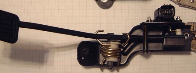

If you ever held the "drive by wire" gas pedal assembly in your hand and I have just today at Mitsubishi, it is very possible that the spring loaded piston can stick.
The original styles look like the bottom assembly in this picture. Basically a spring loaded rod with a sensor that measure rod movement that sends a signal to the EFI control module.
The one I examined today at Mitsu has a spring attached to the end of the rod and the spring rides on a nylon piston. This nylon piston slides in a stamped steel cylinder. A similar sensor measures rod stroke. It's quite possible the some contamination, sand, dirt, etc. could enter the stamped steel bore and impede or jam the spring's stroke.
My point is this Toyota issue is quite possibly mechanical and not a function of an ECU/EFI system fault.

It has long been comfirmed that it is a mechanical issue... the fix is equally interesting as the problem... I'll see if I can find some pictures.
Trouble is the there are more manufacturers that use CTS gas pedal assemblies... Honda now has admitted to issues as well. Wonder who's next.

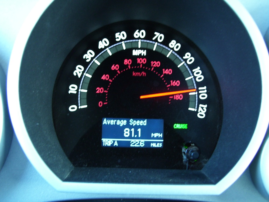

Toyota pedal recall here.
Toyota Sticking Accelerator Pedal Recall
Not sure if I will have it done, i usually have my pedal in the Super Tundra to the floor anyway.
