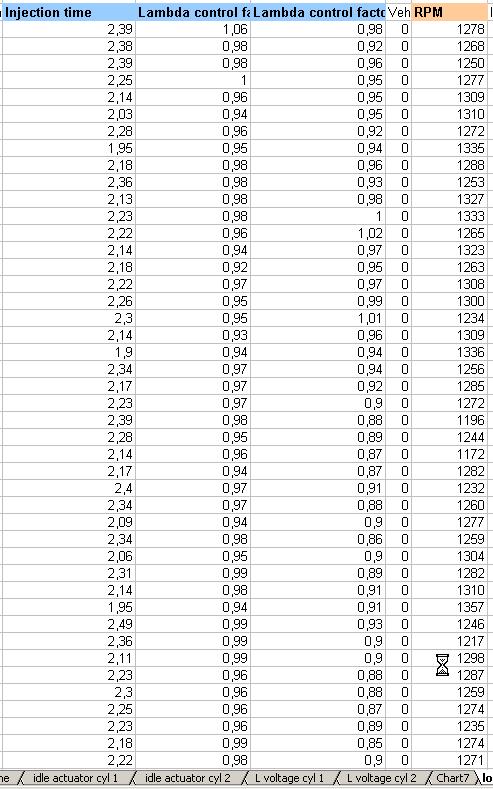

Originally Posted by AntonLargiader View Post
If you have a scanner (like a GS-911) you could observe some of the outputs such as injection time.
OK Anton, the gizmo found, connected (no ride and data logging possible), Idle actuators calibrated, then talked to Big Brother and reported the following (I can't attach here the xls file - this suffix is not accepted in this Noble Forum).
Some generic data first:
Then this:
and that:
and that:
and something not that good:
ditto:
R12S, black, ex Ohlins (now WP), full HPE, RB3

PS: Idle actuator cyl 2 chart is 100% identical to cyl 1, meaning that at least the super gizmo calibrated these ugly things.

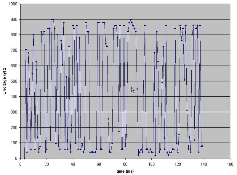

Save the data in CSV or some 'safe' format.
The part I'm looking at is between 50 and 60 where it runs the RPM back up to 1400. You have a succession of low values on the O2 sensors, the idle actuators ratchet up, what happens to the injection duration at that time? If you look at all of the numbers together, you might see what started it.
The O2 results are normal, in the general sense. They naturally swing wildly. But the only time they stop swinging is in that 50-60 section where the idle jumps again.
Silly me > here's the full xls from that csv (with charts et all):
Download log 2010-06-27.xls, upload your files and earn money. 2010-06-27.xls

That's getting kind of interesting. At the times that the idle goes up, the BMS is decreasing the injection times and raising the stepper value (I don't know if that means more air or less air). However, both of those are outputs. I think we need to look at inputs to figure out what the BMS is responding to. I can't tell if the BMS is responding to the increase in idle speed or if it's causing it in response to something else, but it sort of looks like it's responding to it.
Inputs would be air temp, engine temp, O2, RPM, knock. Do you have temperature logs?
The O2 sensor voltage drops down very low during that time, which is lean. Is it possible that you have an air leak? I wish I knew which way the stepper worked. If the BMS is decreasing the fuel and air, then it's probably responding to an outside influence.
Have you checked the fuel pressure?
BTW I also don't understand those throttle position values, but it seemto be going between zero and full. Could it be as simple as a bad TPS? Or bad wiring to the TPS, or a problem within the BMS?

Anton,
Yes, the fuel pressure is checked.
Note: this log is performed with bike hot (to approximate the ride/stop/ride/stop etc etc...but that's nonsense, only an "on-board" GS911 when riding could "emulate" the real-life thing).
With regard the full aperture of data that the gizmo provides:
With regard temperature data (but I don't have a 2nd engine head temp sensor - I made a post a year ago and several others said the same):
With regard knock values (a VERY odd reading due to differences that can't be explained - log captured at idle etc etc):

If you plot the Cylinder 2 Lambda control factor against the RPM, it REALLY looks like that correction is driving the RPM changes. It would be interesting to look at it vs the stepper motor position but (and I don't understand this) it looks like the two steppers stay synchronized at all times. I would expect to see each of them moving separately.
