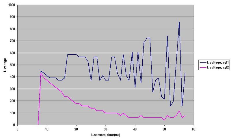

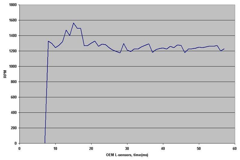

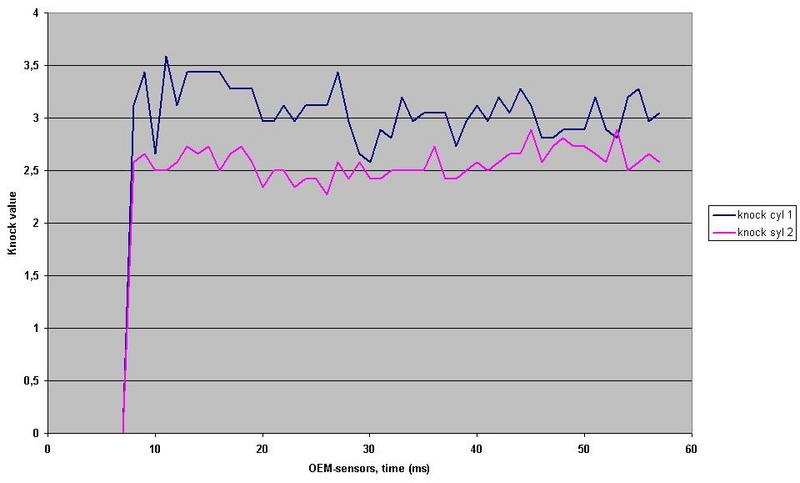

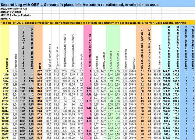

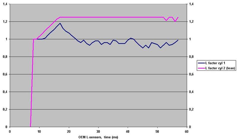

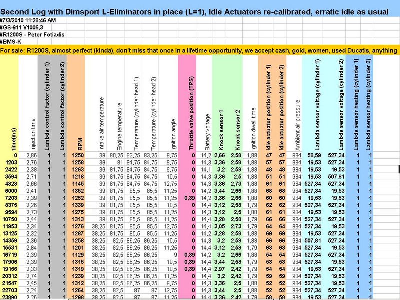

OK,
2 more logs are ready: one with the L-sensors in place,
And another (as Anton suggested) with these L-eliminators (L=1) in place. of course idle is pig ugly in both cases (meaning that there's no L related cause ??).
Original xls (from csv) files are here:

And with regard that idle thing: AT LAST, I'm lucky enough to capture a log that clearly indicates a very lean Cyl 2 situation (graphs shown are with OEM L-sensors).
Now...what kind of bad RON 100 fuel (a given fact in Greece, he he) can cause this? Note: L-sensors and Injectors changed positions (cyl2>cyl1) > always the cyl 2 is the guilty thing.
So, assuming that the Fuel part of the equation is OK...only the Air part could cause this...BUT...the idle actuator in cyl 2 has changed last week. A defective cyl 2 Throttle body housing? a "vibrating" butterfly?
More analysis (L-eliminators in place, L=1) later.

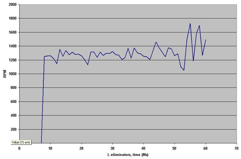

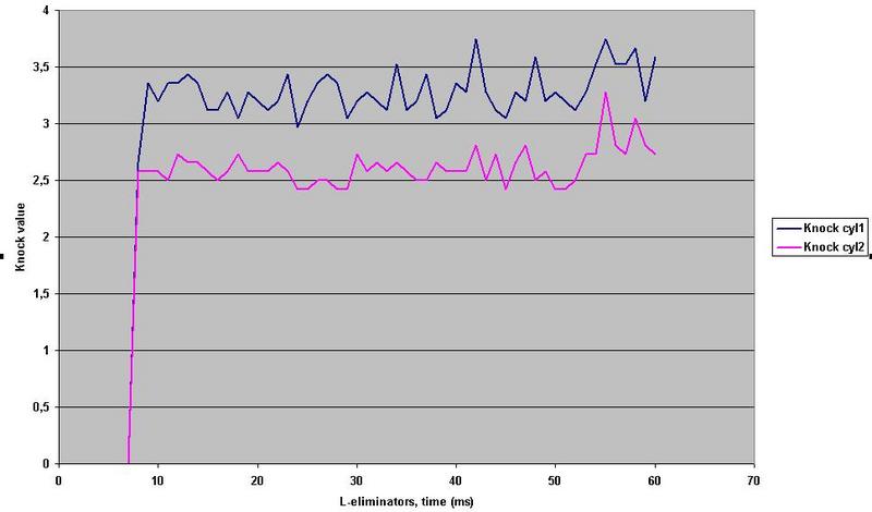

And here's the graphs with L-eliminators in place (a constant L=1 send to BMS-K).
This is something that I don't get it: how's possible with the L=1 steady signal?

The interesting (?) thing with these rather BAD readings (case : L-sensors log2 shown) is the naif/bad design of the whole BMS-K "error/fault management" capability:
I mean whilst is rather obvious that "something" is going rather bad in cyl2, no warning message is displayed in I-Cluster, nor any kind of fault code (BMS-K inquired via GS911) is stored in memory. What it happens actually is that the BMS-K is trying to handle a hopeless situation that can't been handled.
It's not a mystery why the extremely slow responding GT-1 super gizmo (kinda) can't report anything bad.
Who designed the system? Was he (or she) some graduate student?

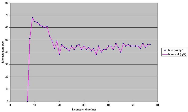

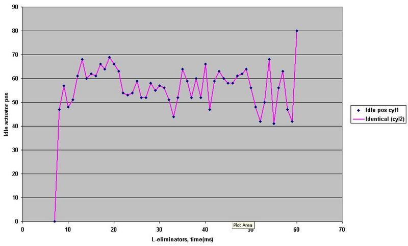

And here's the graphs for Idle actuator(s) position for the latest 2 logs (still identical values, meaning that something very bad is going here - Idle re calibrated but no avail)

Well I've swapped injectors and idle actuators (no avail). Appears that the GS911 gizmo "locked" the idle actuators for good: every test gives identical values a rather faulty situation (some BMS-K parameter set to "NO thanks" - no GT-1 reset is possible). With regard TB replacement (as a hypothetical solution) read this >
