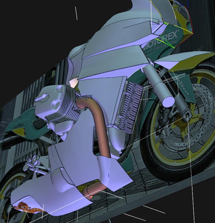

Indeed this thing is the king of craps (more than 30 bikes owned, never another bike gave me such a frustration - and I'm not talking solely about idle issues).
Anyway...my cynicism apart... I had the best of intentions when I bought the thing 2.5 years ago...to the extent to spend time (and fighting The Angry Wife) designing various stuff - shown here at WIP/unfinished stage (spot the CNC oil cooler + SPAL fan).
But, you know what? It's all about karma : the entire related CAD dataset is lost (carried over in a memory stick - never stored in one of many workstations at home: how idiot someone can be?).
Moral: biking and karma are pretty much the same thing
He He
