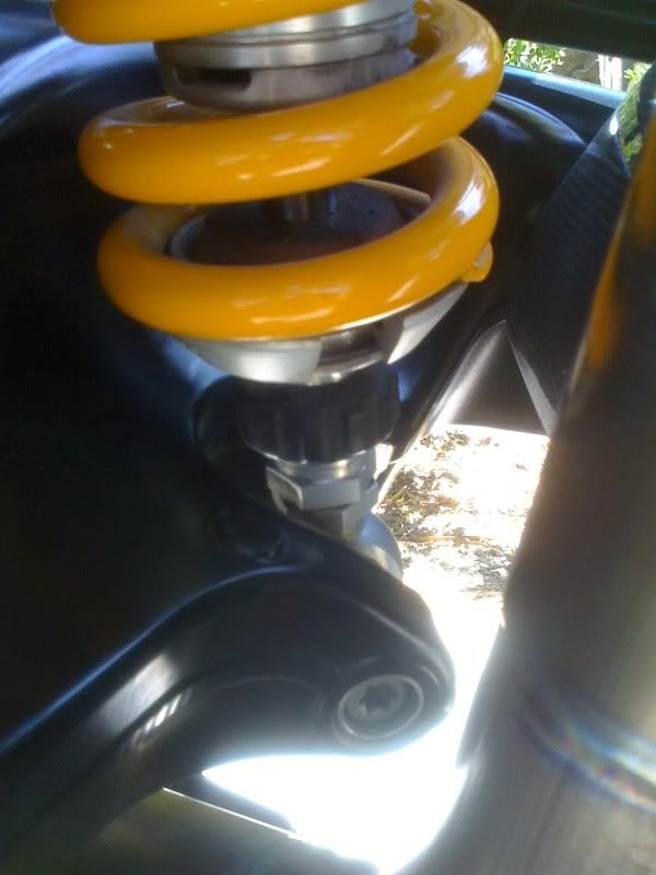

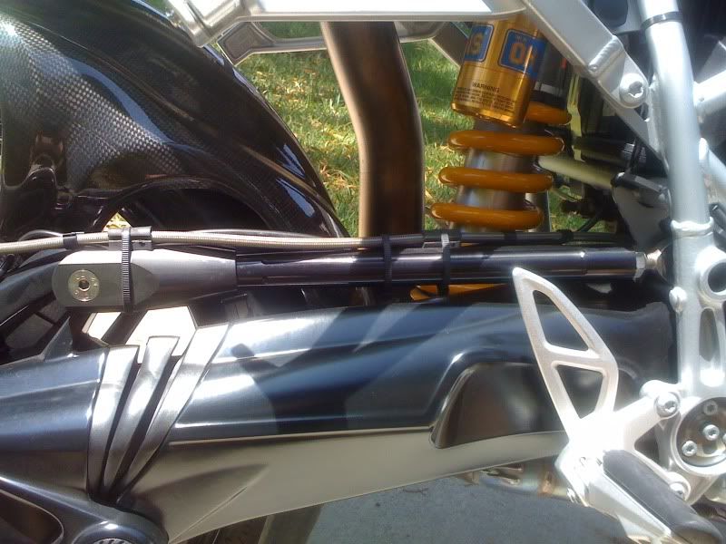

ok some pics....
First this is the torque link on the bike. It does not look to me like the rear ohlins has had the shock height raised at all but I will include a picture of that as well.
Photobucket
Next, the picture of the bottom of the shock as seen from the left side of the bike. Sorry I am so dumb - but am I increasing rebound damping turning this knob to the left or right as you face the edge of the knob??
Photobucket
As I mentioned above it doesn't look to me like the shock height has been adjusted at all but I'm not sure if a little goes a long way.
TIA JT

We've seen that link before but I don't remember the brand-it was on that HP2S that somebody in the Mid-West was recently trying to sell.
Somebody just needs to do a center-to-center measurement on the stock arm.
I'm at work now and can't do it for a couple of hours. You should adjust that one 5-6MM longer than stock. The FD bellows is not unusually extended.
The shock adjuster is at full short-I've got 6 threads showing-I think shreddr has a few more.

Your torque arm looks to be at full short, which on the R12S would lower the bike in the rear. The Ohlins is at the factory shipped setting which is as short as it will go.

The torque arm has a couple threads left that could make it a tad shorter, but even so from center-hole to center-hole it measures a full 3/8" longer than the stock arm (which I have off the bike). It's my understanding that this raises the bike? I get that it changes steering head angle but are there any other theoretical ramifications where the handling is concerned with the change in paralever geometery?

The stock torque arm looks to be 378MM center-to-center by hand held tape measure with the torque arm in my hand-add 5MM to that length for your adjustable arm and you'll be good to go.
Ok, I am getting 15 3/32" on a careful measure which translates to 383.4mm. This seems close enough to +5mm that I'm going to leave it alone.
On to shock height... currently the shock is sitting at the bottom. Considering that I already have inputted some increase in stock height with the paralever geometry change, is there any pressing reason to add height here?
Thanks again,

Time to just ride it some, JT. If it feels any amount of truckie as you turn-in, then you might want to add ride height. The fine tuning is done as a result of time on the road.

I have the same torque arm, it's an Evoluzione. You change the length by adding or removing shims. PM me with your email and I will send you the PDF instruction sheet.

The torque arm I have looks like you could just detatch the forward eye and unlock the locking mut, spinning the foward eye a few threads for extra length. There are no shims in it (although certainly one could add them). It seems around 5mm longer than the stock arm (which I have).
