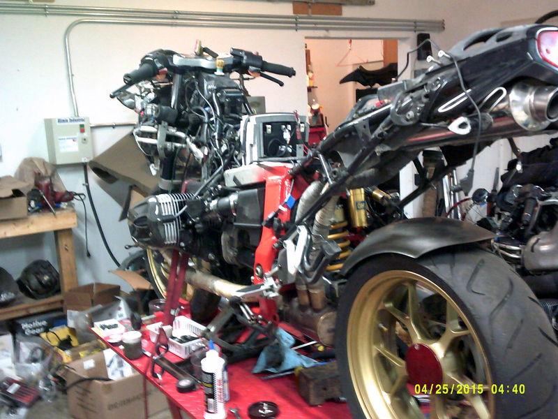

OK, I'm going to start posting this. I'll state up front this is an absolutely unnecessary endeavor and should be reconsidered if you would rather ride than work on your bike.
I'll start with my finished trailer queen below so you know what it ended up looking like when done, albeit, not running right.
The trailer queen above lasted a whopping 40 miles before running on 1 cylinder on this trip. It also had an oil leak (fixed now), steering issue (fixed now), ignition failing on left cylinder (fixed now) and major lean fuel issue (fixed now). Yes, I should have done a shake down.
This bike started as 2001 R1100SL from the original owner (Darryl Carmichael, works at Bob's BMW) with a blown engine and a trans input shaft on it's last leg BUT with Ohlins front and rear, Remus, BBPower chip and some carbon fiber bits I haven't seen anywhere else. It defines "delete" option for these bikes with nothing added and running the smaller alternator (or so it looks). Miss those heated hand grips too.
The bike above (Gotroad? calls it my Frankenbike....ouch), started as a pile of parts the week before this pic was taken and is now made up of the following parts:
-2004 R1150R motor (kept R clutch)
-2004 R1100S trans (low miles, beautiful shape)
-R850R final drive (Need to figure out the speedo)
-Buzzz gear indicator (like this)
-Ohlins (ProPilot rebuilt)
-RSC steering damper on 10mm shorter telelever arm
-2004 Rockster forks (fits 320mm rotors)
-2007 R1200S front brake calipers (very minor mod to fit my brake lines) + EBC HH pads
-K1200RS fuel regulator and coil (BMW connector kit to adapt + custom mount)
-2 sets of red Nology wires (dual plug heads)
-custom oil pressure spring shim
-stock bottom end with JE 13:1 pistons, Trick Titanium wrist pins, original piston rings
-flowed and ported heads (280 CFM now), 2mm larger Ferrera inconel valves with dual valve springs (something like bacn5 did only these are for a Hyabusa and fit the stock retainers)
-Edelweiss EM 4V2 cams (BBPower Hi-lift cam) using stock cam gears, lightened lifter buckets, stock pushrods, slightly lightened rockers (wish I could find the Titanium adjusters BBPower used to sell)
-BBPower chip (Type 2)
-stock throttle bodies
-SJBMW induction/filter/etc.
-Remus exhaust (wrapped, hides the crappy finish on the headers and looks fast)
-carbon fiber here and there (front fender, front head light fairing, valve cover sliders, dash cover, rear wheel hugger & foot rest heal plates)
-Iridium plugs
-Shorai LFX21L6-BS12 battery (couple of pounds)
-PVM wheels
-Baaker paralever link (black, 365-375-385mm) - 3 settings, it is in the middle setting in the pictures
-stock rotors (320mm up front)
-Dunlop tires (Q2 up front, 180 StreetSmart out back)
-Starlane Quickshifter
-Techlusion Gen 2 (the simple one that you tune like carbs and it ONLY adds fuel to the mapping)

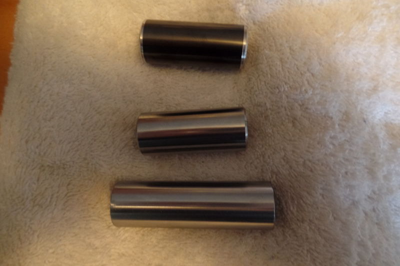

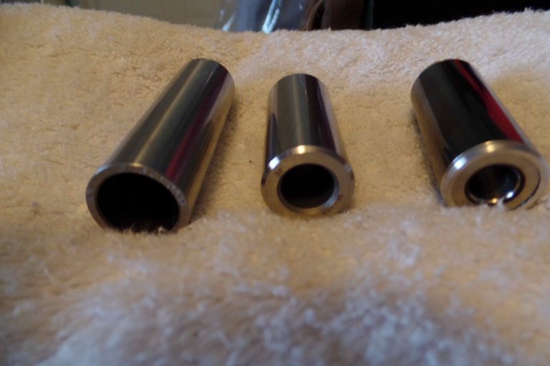

Custom JE pistons. They are a much more current design bridge style piston with much shorter wrist pins. I sent them a mold of my combustion chambers and no knocking at start-up, so they got them right out of the box. They set them up for stock pistons rings, so I just swapped them over, no break in.
Note that the valve reliefs are by valve, not one big relief like with the SJBMW pistons below. Note: I thought the Venolia Circlips were hard to get in. They turned out to seem easy after I had to put the JE Circlips in, really hate them. Now I welcome the Veniolia ones.
JE pistons again, you can see a little of the low friction coating for the piston skirts.
Here's a gambit of different wrist pins - top view. Trick Ti pins on top (note diamond coat color difference); middle pin is the original JE steel pin; bottom pin is the SJBMW Venolia pins.
Gambit of wrist pins again - end view. Left to right, Venolia pin; original JE steel pin; Trick Ti pin with Aluminum inserts to make them the same length as the original JEs (2.050" long). Note; the end thicknesses appear much different but thickness at the small end of the rod isn't. The Venolia is very tapered from the end in, the JEs have no taper and the Trick Ti do not either. All the IDs at the small end are within a 1/32" of each other. The Trick Ti is easily the lightest of the bunch, with the JE next, then Venolia with the stock pin (not shown) feeling like a brick in comparison.

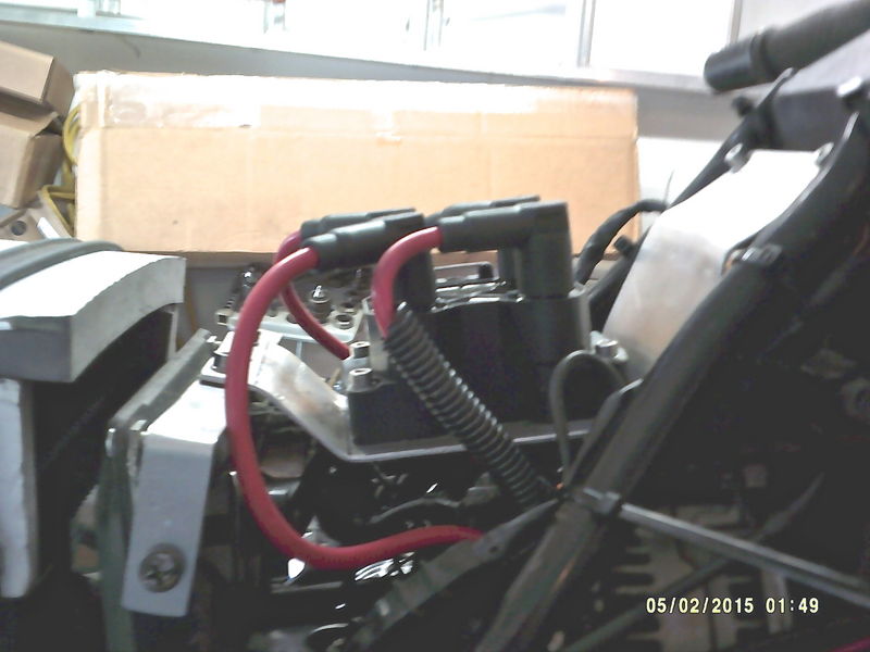

OK, my trailer queen ignition gave it up after only 40 miles. I put the old stock coil and wires in with none for the 2nd set of plugs (just filled the hole). That didn't work out too well. Nology's commitment and follow-up meant they came about a week later than planned. So once I had the queen home and on the lift, it was time to put the dual ignition on I wanted. It has a K1200RS coil with the right connector kit from BMW (in stock) spliced into the stock harness. The way this is wired is the middle pin (#2) goes to the green wire from the original harness and the other two (#1 and #3) go to the brown (might have been black) wire as they are the coil returns. If you turn on the ignition and do a continuity check, you see the green one turns on with the ignition. I started by trying to use the SJBMW coil mounting bracket I bought for my Tourer but didn't fit and found it just as bad on this one. I took a hammer to the Tourer tank, I wasn't doing that again, so I made up some mounting brackets that put the coil down into the empty space where the harnessing and ABS II usually resides.
Trust me when I say those brackets look better than they are. They're fine structurally but you can tell I made them. I know how to make sheet metal and machine parts, I'm just a hack.
Here's it installed with wires and ready to go.
There's been a lot of debate as to whether or not the Nology wires really are better. All I can tell you is when I put them on my Tourer with no other changes, my idle RPM came up 200 RPM. Putting these on the bike solved the one cylinder only firing problem. Also clears the tank nicely.

I also rewired for my BBPower chip (sorry about the focus, my new to me Fujifilm with autofocus is charging up).
Set it up to flip between Stage 4 (road) and Stage 5 (track), added a switch to turn on Stage 5. I might rewire in the future to play with timing advance options but not now.
Hopefully this will cure my lean problem (was running on Stage 2). My quickshifter also arrived, that's going on after I resync the injectors.
