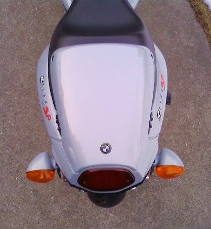

And good suggestion for the Harley signals, Rapid Dog. I took a similar route by repairing a pair of front signals from a crashed Yamaha R1. Here's the R1 signal attached to the bike vs. the stock part.
After some filler and sanding, I really like the attractive shape of the housing - especially after painting them frost blue to match the bike.
And since the front R1 signals contain dual filament bulbs, I have running lights (shown below) and much brighter turnsignals.
