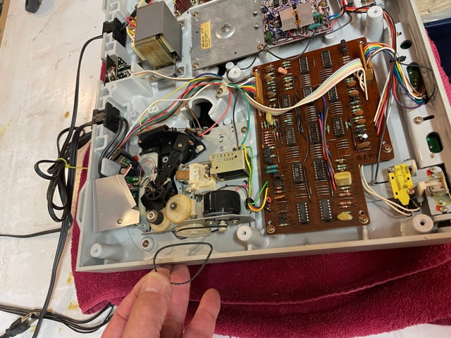

I have been watching Mr. Vinyl Obsessive on You Tube and that started me thinking I needed to dig out my old turntable and tune it up. In the midst of Covid I spent a bunch (for me) of money on an Integra Surround sound system, and some Klipsch reference speakers and a powered sub to add to my old Technics. I have had lots of decent car audio over the years, but wanted something that would shake the house.
After doing some research online, I got replacement tone arm belts from Turntableneedlesdotcom. I found all the service manuals at vinyl engine forums, along with a bunch of info to do the work.
First I replaced the slipping belt for the tone arm.

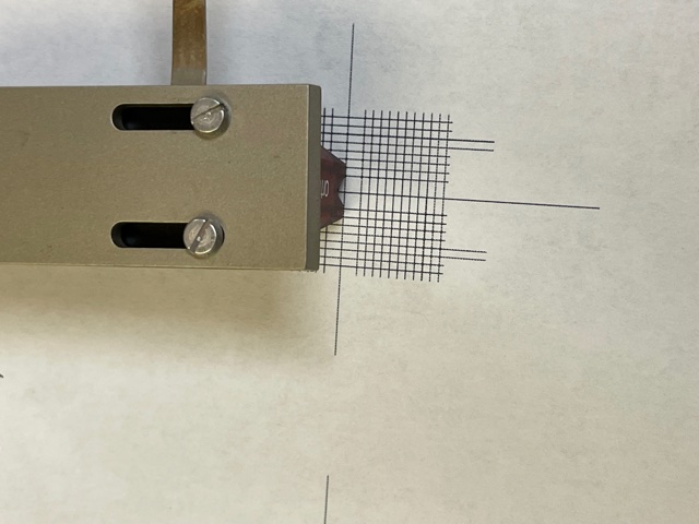

Then I installed the Ortofon 2M red you suggested.
The service manual gave specifications where the stylus should be from the base of the tone arm mount which was 50.5mm.
I used a protractor template I was able to download from Vinyl Engine to verify alignment at two locations .

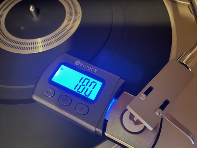

I also picked up a scale from amazon. My turntable has a really accurate adjustment weight... I set it to balance, then turned it to the 1.8 grams of force, and was off by .02... readjusted it using the scale.
Put on a U2 Album that I really like.... Records have never sounded so good from my system. Only a little popping between songs.
Now to sit back and enjoy the music.
