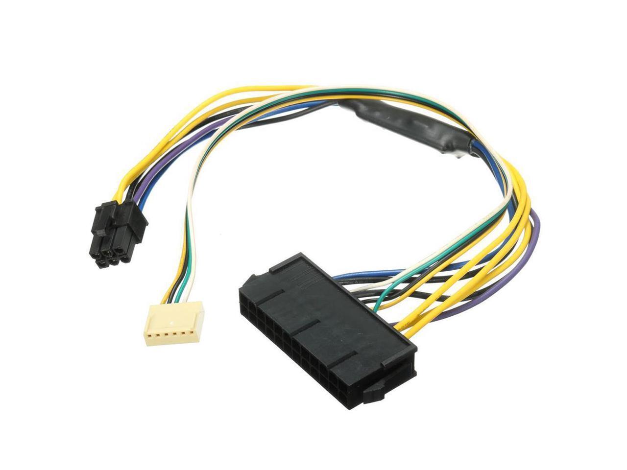

It uses one of the ATX 12V 4 pin to power the processor and the motherboard. The problem is, that won't supply power unless the main power connector (20 or 24 pin) is also hooked up to something telling the power supply to supply power. My motherboard has no provision for the main power connector.

That one wont' work because it goes to what looks to me to be a six pin PCIe connector.
I was thinking that this might solve my problem:
https://www.amazon.com/dp/B01N8Q0TOE/?coliid=I27QHGFICRJZ05&colid=2032DNG1ATX9N&psc=0&ref_=lv_ov_lig_dp_it

Oh, and I went with a Thermaltake power supply with the 24 pin jumper I posted above.
