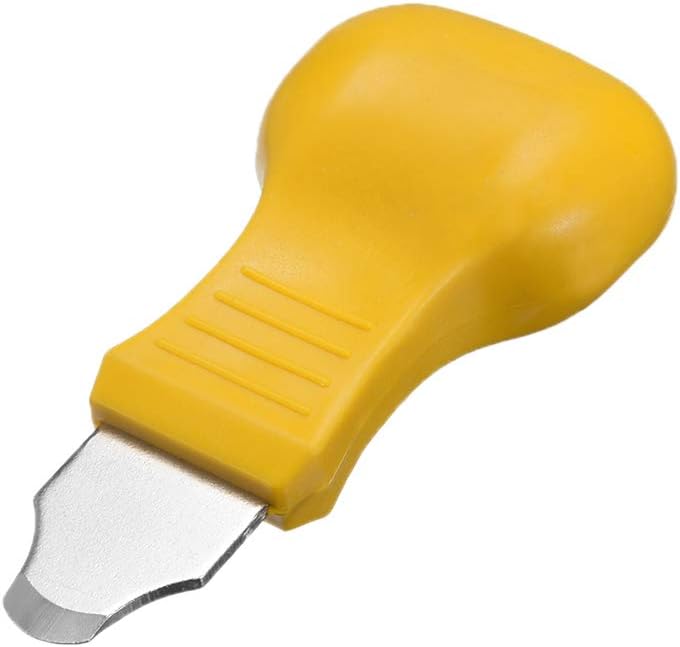

I have a Skagen watch, which I don't use much, with a dead battery.
I tried every screwdriver and knife to get the back off...no go...scratched the back trying.
Ordered one of these from amazon yesterday for $8...it arrived today. First try...the back came off.
https://www.amazon.com/dp/B07KY8BYFQ?psc=1&ref=ppx_yo2_dt_b_product_details

Cuticle pusher?

Nope...you push the sharp edge into the gap, and then use the plastic handle to pry up from the watch base.
If you don't use the watch base as a fulcrum...it won't work.
The lid comes off instantly.

the distance from the edge to the plastic is critical.
It makes the perfect leverage for the removal.

It even arrives with a plastic cover for the edge...just so you won't hurt yourself.
