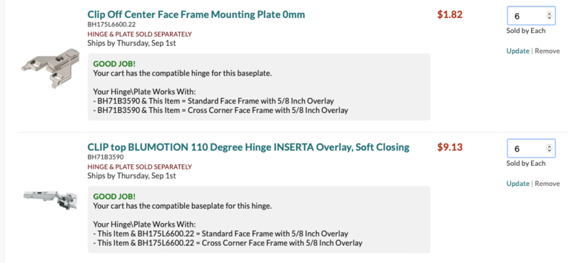

https://www.cabinetparts.com/p/accuride-drawer-slides-side-mount-drawer-slides-AC383222EC-p184?mtm_campaign=780262739&mtm_group=43589091591&mtm_source=google_ad&mtm_medium=cpc&gclid=CjwKCAjwpKyYBhB7EiwAU2Hn2d8hXPO3LLR0W7tsPnhH x7Btg25YE0uiz8kPaME5gV-AoJCrsPr6mRoCAPEQAvD_BwE
We use only accurate for side mount slides and have been for a long time (way before the Chinese imports). I am sure some of the Chinese imports are just as good now, and have used them in a pinch and have not had any call backs. Cost less too.
https://www.cabinetparts.com/p/blum-hinges-european-cabinet-hinges-BH71B3590-p6660?s_qid=216ca5d150ca95d9cf77940e67b2d45e
120 degree can be had if you like. This is 110 degree
Pull off the old hinge and remove the plastic plug in the 5mm hole and insert new hinge, snap to tighten. Do not drill out the hole to remove plug. The 5mm hole must not be enlarge or alter at all.
https://www.cabinetparts.com/p/blum-hinges-european-cabinet-hinges-BH175L660022-p6577?s_qid=78b5773684651462c7cb41ff5187839c
This is the 0mm hinge plate you need. It attaches to the frame. Please predrill the screw holes. I can see someone just cramp the screw in the face frame causing the wood to split. Make sure its 3/4" overlay.
This is a pretty simple DIY now that you have all the correct parts needed.

WOW, thanks so much for all the information. I am placing an order for 6 sets of drawer slides to get started, and if I am satisfied, I will work my way around the kitchen and master bath. The hinges on the other hand are a pain. When I add the 2 parts to the cart, they show as 5/8" overlay. When I try to get a 3/4", it displays another part. What drop down option do I need to pick from the product screen?

Its all metric, so get the 0mm plate is the one you need. That is the correct hinge, because it has about 1/8" left or right adjustment. Once installed, it needs to be moved about 1/16" to create a 1/16" gap between the edge of cabinet or the other door. Between doors, there should 1/8" gap.
Thanks. Initial order placed for 6 drawer slides and just 1 cabinet hinge. I want to see how it goes before I spend a lot more money.

Must replace both hinges on one door for test fitting or else it will bind.

Depending on the hinge plate. Some have no adjustment on them Which are very common ( we use lots of those and are actually stronger then the "wing" looking type and lower profile). The hinge plate OP shown us in the second pic has a elongated slot that allows what you described. The adjustment is in those hinge adjustment screws. Again, look at the gap between door and cabinet. As long its it has 1/8" then it should be fine. Adj from there. Sometimes, cabinets themselves aren't plum and most people fake it with adjusting doors to fit.
