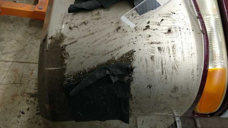

I spent days scraping the factory applied 3M "clear" crap off my 2004 motorhome project.... Hopefully the stuff the they make now is better than what was put on in 2004. Once the sun dried it out it apparently got micro cracks in it then the adhesive beneath became discolored.
