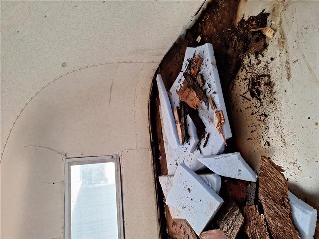

Took a couple pics to help explain what I am attempting to do . The pic with the square box shows how the angle material will be installed . The vertical section of the L will be riveted to an existing aluminum rib . The horizontal portion of the L will be riveted to the bottom skin that covers the bunk section . That bottom skin is what you look at when outside the camper looking up .
The other two pics show the front two radius corners . When the new angle is installed there will be a empty cavity between it and the outside skin . I am thinking I may fill that cavity with expanding foam . It is light weight , waterproof and would add additional rigidity . After the angle is installed I will then make a center backbone out of 2x2 or 2.5 x 2.5 square aluminum stock . Then off that center backbone will be additional joists out of the same material .
It will all be riveted/screwed/adhered and then foam sheets will be cut to size and fit in between the structure . You can see the rotted mess that I still have left to remove . It looks like the overhead roof vent was left open at some point and rain came in . But I will go over the entire exterior skin to make sure there is no water entry . Keep in mind this old girl is 55 years old
