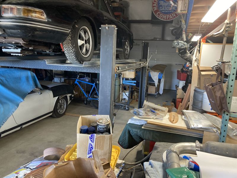

My brother's four post has moveable rails.
Yeah, I get what you're asking about and it also worries me as the attachment is going to be put in a shear situation not the 'normal' compression mode.

Here's an old pic of his lift showing how he's got them all the way outboard so he could put his other 'rails' on them so he could put two cars up on his.
