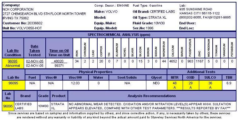

Over on the tech bored, the topic of oil change and if it is better to change hot vs cold has been discussed. I always wondered if the oil that was cold was any differnt than the hot oil (save the temp & viscosity). I tested both hot and cold to see if prehaps the hot oil stirred things up more and kept it in suspenion better. Not a true study based on statistical methods but never the less it was interesting. Both oils look pretty darn close. So close that I would say that oil smapling can be done hot or cold.
Draining is another story. Drianing cold will take much much longer. If you have nothing better to do and you don't like hot oil dripping down you arm, cold changes may be fine.
Personally, I like hot oil dripping on me so I get it rip snorting hot and stick as much of my arms under the blazing stream as I can! J/K
Here are the oil analysis results on my 96 Volvo. I did change the oil because the oxidation/sulfation/nitration was getting high. but interestingly enough, the TBN was still pretty good. Mind you, there is 48,000 on this oil.

There is a thermostat that opens when the oil is hot enough to send oil to the front oil cooler or trombone oil cooler. If this valve is closed you will get about two less quarts of oil than with a hot oil change.
This is all you need to know.
I am not an expert, just been around you guys long enough and done a few oil changes each way.
Edit: Is the bottom sample done hot? It has more Zinc in it for sure.

The bottom sample was cold. The level is within experiemental error for the instrument that is used (<5%). The Zinc is found in a common anti-wear agent. It I was to pontificate and speculate, I would say that the hot oil allows the Zinc to plate on the metal surface and when cold and has a decreased affinity. Sounds cool but I do not think it is accurate.

Lube, 48k on this oil??!! What kind of oil are you using and assume that you were changing filters often? Have used syn oil when living in Europe but changed it at 15k or so.

I'm using Certified Labs STRATA XL. It is a straight mineral based oil! I changed it to STRATA XTREME which is a blend. I expect that to last even longer! No, I didn't change the filter because the contaminants were kept in check. They can either come from internal sources or external sources. Interally the deposit formation is held in check with good chemistry, externally I changed my air filter twice and very good about not contaminating my sampling port which is my dip stick tube.
