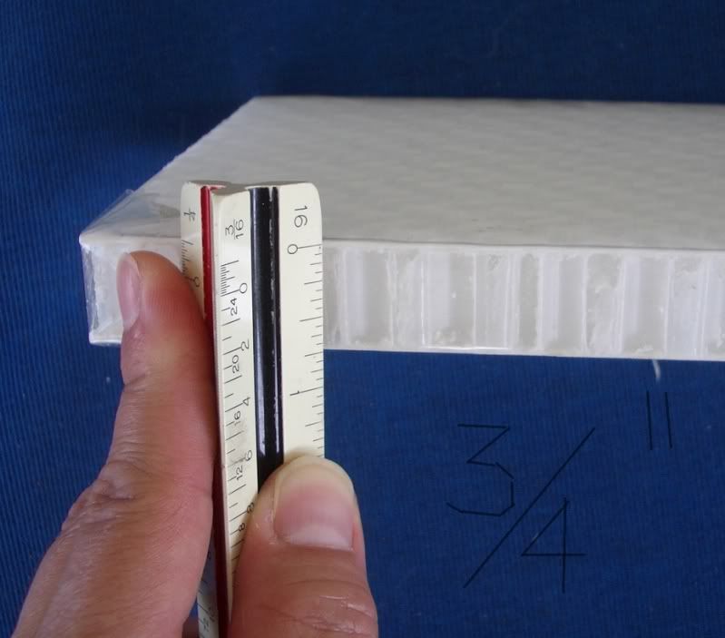

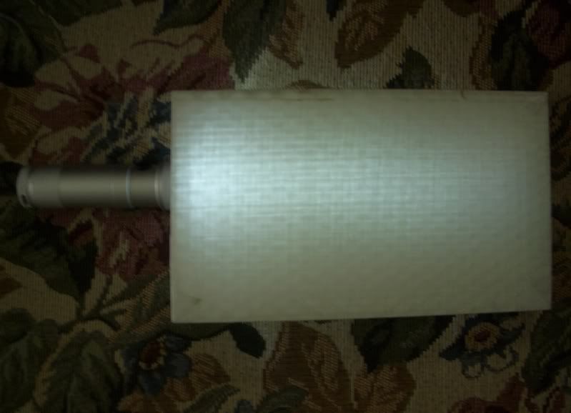

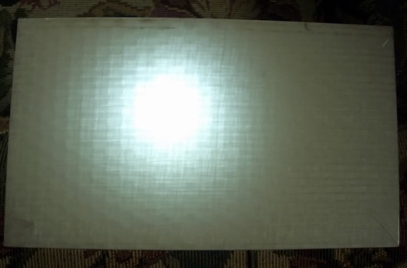

I think Monopan has some acoustic as well as thermal properties. It is translucent so the porch will still feel like a porch, and it is very light-weight. I'm picturing placing the full height panel on one side of the porch, maybe a small return "L" if wanting to turn the corner.
MonoPan :: The Future in Material Technology
Pictures of my sample:
Hovercraft Random Pics pictures by kach22i - Photobucket

Consider doubling the panel with an airspace in between. May want to cap the ends to prevent spiders from making a home in there. I would still weep them however to prevent condensation.

Monopan looks cool, but I doubt it would hold up well against UV in the south unfortunately.

These are here in Kansas City and it holds up pretty well.

I'm talking deep south... Texas, southern New Mexico, Arizona, California desert type sun. Paint and polycarbonate headlight shredding sun.
