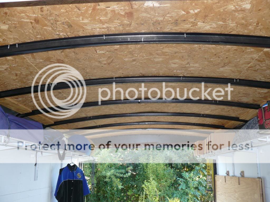

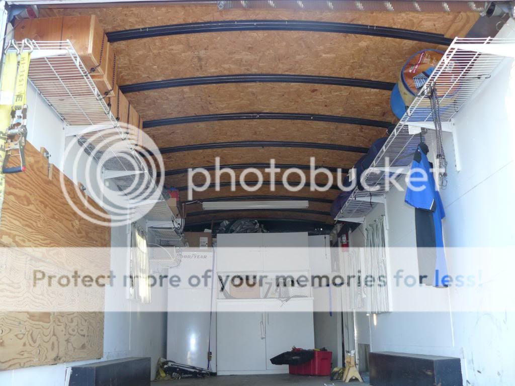

Can you post some pictures of the inside of the trailer? I assume it is lined with wood? Maybe you could put foam in the dead space between the aluminum and wood. Like those 1" thick sheets they sell at HD and lowes?
Yes, it your basic generic wood lined interior. Plywood on the sides and Luan on ceiling.
Foam was my first thought as well...

The ceiling is cheap sheet material.
Should be able to install foam panels to the wood then use self tapping sheet metal screws to hold the new veneer in place.
I want to cut in two skylights first.
