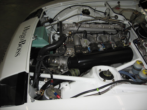

Okay. Tell me how MFI fuels one cylinder more than another. Be detailed...
Cheers,
JR
However, MFI injects fuel only into the cylinder that needs it. Have you ever studied the inner workings of an MFI pump? They have a cam like the cam actuating the intake and exhaust valves. These push plungers in the right sequence and at the right time to increase the pressure in the fuel lines to overcome the MFI injector's spring loaded valve and spray fuel just in front of the intake port.
Then there is the 3D space cam that works with the flyweights and throttle position and barometric compensator and the thermostat to change the fuel delivery based on load, engine speed, air pressure, etc.
By that I mean the fuel is only injected into the cylinder when it is drawing air in. The injectors turn on and off rather than just adjusting flow rate like the Continuous Injection System.
And that's not at all what you said before, which made no sense.
So now, elaborate on why that matters. Or, why it doesn't. Either viewpoint is fine with me.

"MFI injects fuel into only the cylinders that want it" meaning, the cylinders on the intake stroke. Meaning pulsed injection, not continuous.
If the earlier statements were unclear then sorry but I was trying to explain the same thing each time.
CIS is a mechanical carburetor- injection far upstream. There is opportunity for the fuel to condense on the intake runner sides and to pool behind the closed intake valve, hampering efficiency. Thus the need for the swirl inducing pistons. MFI injects at fuel pressures higher than anything but a diesel or a direct injection system, and injects it right upstream of the open valve. Therefore, more precise fuel control and better mixing (finer atomization, which improves combustion efficiency).
Not to mention the restriction of the CIS barn door.

Actually, Porsche endorsed MFI well into the eighties for racing.. CIS simply didn't cut it for racing, only when EFI came along was Porsche able to retire the MFI technology.
For production cars they simply compromised performance for fuel economics and production cost. Fact.
The 930, well, it simply took em longer to get a reliable EFI for turbo'ing.. Different parameters and all that.. So it took em a bit longer to get the turbo EFI into the production line.
I really fail to see where the CIS endorsement is..
No Factory Racing Porsche has ever used CIS. They used MFI for that.
Every seen an 911 RSR turbo with CIS?
or a 917? a 935 perhaps? Or what about the 936? how about the 956/962?
Please tell me which racing legend from Porsche, owned the race tracks with CIS injection...
Not even the 924 Carrera GTR and 924D variants used CIS, no. When Porsche really needed power , they used a Kugelfischer Mechanical injection and individual throttle bodies on the 924.
If you want to play find the CIS gear, try looking for a triangular Kugelfischer logo.
There' s your endorsement for CIS. They never used it when they needed reliable high end power. Not even for a 924 or 944.
Bringing CIS to a 70'ies and early 80'ies race , would have been like bringing a knife to a gunfight so they simply skipped from MFI to EFI.
