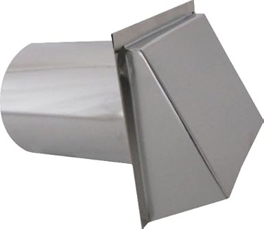

Posts: 43,378
Actually, if he is willing to DIY, he could build his own flow switch.
Use a piece hard metal dryer duct with a flapper at the end. Put a switch in the duct so that the flap activates it when there is no airflow. You will probably need to add a weight to the flap to get it to activate the switch. I would put a relay inline, since these types of switches are not really well suited for lots of current.
James
Red-beard for President, 2020

Old 08-23-2013, 02:58 PM
Posts: 85,365
James I like it! I would have NEVER thought of that.
Now I gotta figure out how big that is and where to mount it. It will have to be hidden fairly well. I love the out of the box thinking. It would be something to talk about when I show my boring stock 350 engine. As Spock might say Fascinating.
I will look into that as well as the speed sensor idea.

Old 08-23-2013, 03:09 PM
Posts: 85,365
Originally Posted by red-beard View Post
Flow switch.
Air Flow Switch for DC/ AC Voltage Supplies (Type 3201.-/3204.-)
These are factory set to 3m/s or about 10 feet per second. You will need to duct some air or place it in an area sure to sense flow.
I could not find a price for that flow meter. It is 100 bucks or 1000 bucks? That does make a difference. Where did you find the metal vent? I need one of those for the house. Or crazy dog decided the plastic driver vents are tasty and destroys one about every two months.
