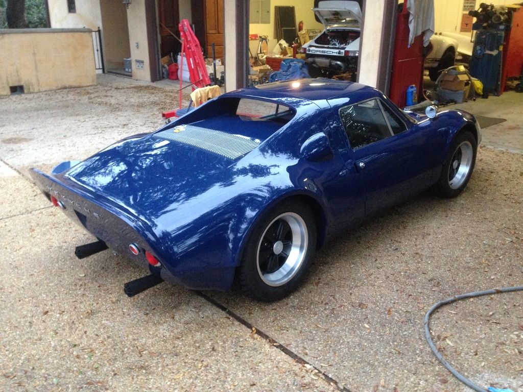

mreid 11-24-2015 04:23 PM
Ignition is done. Need some fittings and remote oil filter mount to finish the oil system, then fab up a throttle cable connection and I'm done. Only a couple more weeks!
Hmm, upgraded my iPad and now pelican says all my pictures don't have the correct extension to post. A problem for later.
mreid 12-06-2015 02:39 PM
Finally was able to drill two 5/16 holes in the stainless engine mount bracket. The damn thing was work hardened and I couldn't get a straight shot with the engine in the way. I'm embarrassed to say it took me two days! Mainly due to bits breaking and runs to Lowes.
There was no provision for another oil filter and since oil is the life blood, I want plenty of flow. This System 1 filter is reusable and has a 1" inlet with 12an fittings. I purchased a 22mm to 12an adapter from BAT that screwed right into the engine case. I now have 12an lines, through the filter and front oil cooler. I would have preferred to have the filter after the cooler, but space limitations keep it on the outlet side of the engine before the front cooler.
All I have left is the clutch linkage (I can't find the clutch lever), throttle linkage (the cable is installed, but I have to fab up a bracket), and adjust the shifter. Getting there! Still can't upload pice since I upgraded iOS on my iPad.
mreid 12-25-2015 07:29 AM
Gave it a good wash and wax, filled the engine and 915, and found a major oil leak in the 915 where the tail housing bolts to the gear case (what a pain). Now considering options to fix the leak, but all ready for first start. Even got a GoPro for Christmas!

GH85Carrera 12-25-2015 08:25 AM
My next project is a...
Just a beautifully done project. Neat toy for Christmas.
onewhippedpuppy 12-25-2015 08:45 AM
Fantastic! Can't wait to hear the first drive report.
billybek 12-25-2015 10:37 AM
With video from the GoPro!
Waiting for that very impatiently.....
Craig T 12-25-2015 10:48 AM
http://forums.pelicanparts.com/uploa...1451069238.jpg
Just awesome project. I am insanely jealous. The color, wheels, everything. Let's see some action videos soon.
