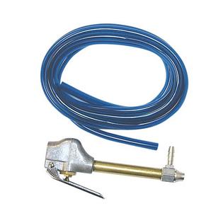

My second job out of college was a large foliage nursery in Apopka and they had a maintenance department. The head guy (Dave) would clean my Volvo 145 engine for me periodically - he used kerosene siphoned through an air compressor. Did a wonderful job.
I have been know to spray WD40 or PB Blaster on engines and agitate it with a brush. Then I hit it with the long reach blower, and blow off the residue.
