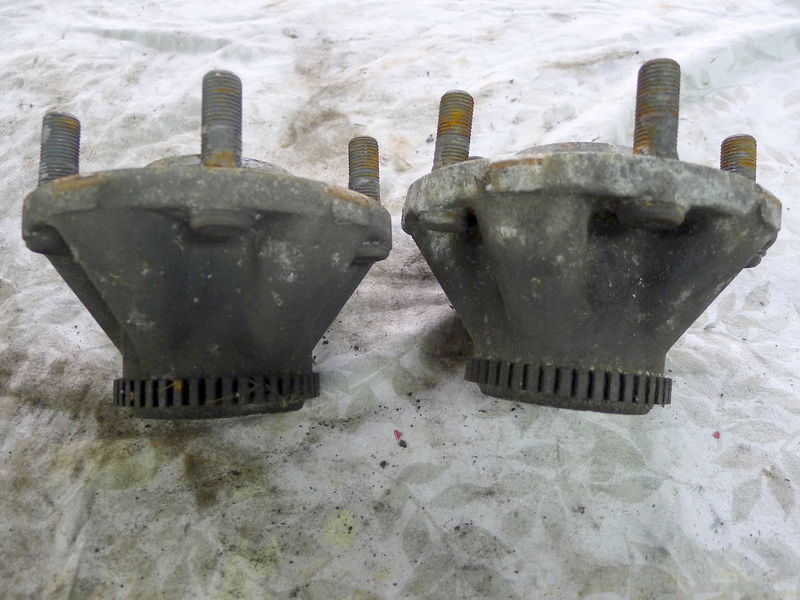

Here's the scoop. Nick makes a strong point about buying the unit that will save time and result in a cleaner finish, and given what he does, I am sure the net-net on the hot water pays real dividends.
My issue is two-fold and uses Nick's logic introducing the fact that I'm saving for a vapor blaster that I will use 10 hours per week every week at a minimum, and the one I need is a significant purchase. That's what my capital equipment account is focused on right now. Since I'll do just 4 cars per year with a pressure washer, it's a long amortization schedule to spend $2K on a hot unit.
Like I said, there is some serious clay-like material on this tub near the front fender wings. That's the real test. The rest is grimy but I think (we'll see) will manageable with cold/100F water.

Nick, you were right, at least in the grand scheme of things. First, the 2500 psi washer was weaker than I thought it would be. No reason to believe the unit (Karcher) was defective, I just thought 2500 psi was stronger. Should have gotten the 3500 for the front wheel wells.
The washer completely failed on the aftermarket tar on the driver side but did a decent job on the passenger (it was lighter) and did a really good job on the rest of the tub. I ended up "painting" the heaviest/thickest tar with a mapp torch and hitting it with a plastic scraper and brass bristle brush. That worked pretty well. Was careful to move the torch around so as not to disturb the factory coating. Then I hit the area with gas and a super scouring pad. That got it down pretty clean, the gas dissolved the tar slowly but effectively. Then the washer to clean up and then wiped down with brake cleaner and a towel. Honestly not that much work and I'm not even sure how well a heated pressure washer would have worked on the tar. But I am sure it would have worked better than the cold water.

Ypu’ll Want something that can clean the parts well before you vapor blast. You don’t want grease, oil, tar, dirt, etc running through the machine. You will love the vapor blaster. Makes aluminum look like new.
Those do look nice. I typically bead blast and then tumble Al and Mg. I can control the surface sheen with media and various techniques and I like that the media micro-peens the surface to seal it. The Mg 915 below is 2 years done and still glows. My sense is the vapor blaster will shorten the time I need to get to the final finish and sometimes give me a final finish.
