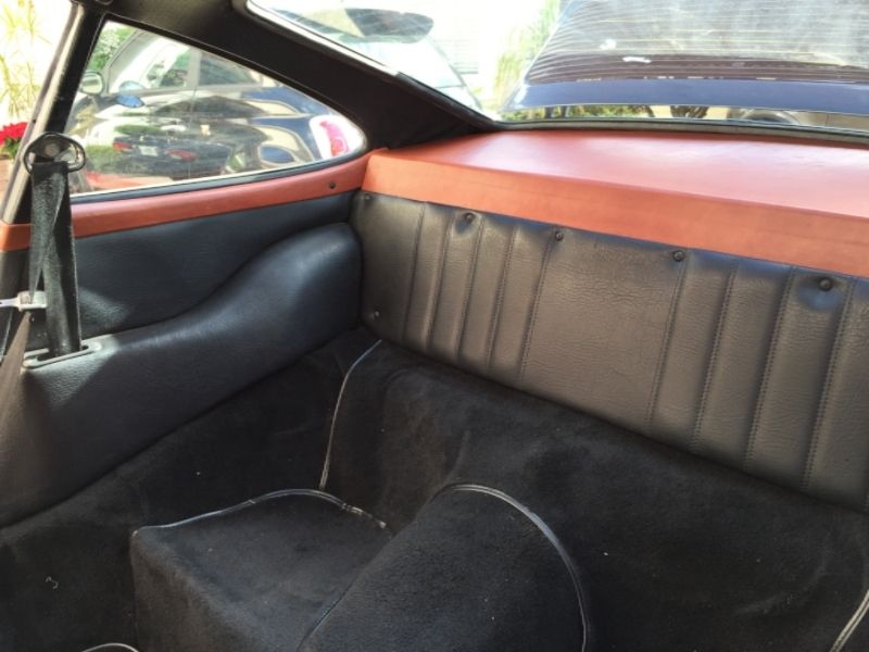

As I mentioned... this is a project that I bought from someone else... meaning, a shell and lots and lots of boxes. The RS carpet, turns out it was missing a section. The one that covers the rear shelve.. What I still had was the original cover. Got some more leather today, recovered the top (had to cut a panel to cover the old one as the holes for the speaker were an issue...) With the top section recovered in leather, used the stock/black front section and voila! It is dark and I was sweating like a pig... Everything needs to be cleaned up... between the dust and the cutting of carpet... it needs a good interior cleaning... I will do that tomorrow and take better photos...
I still need to install the 4 bolts that hold those pieces in the back... forgot to install those...
http://i151.photobucket.com/albums/s...psh86dimta.jpg

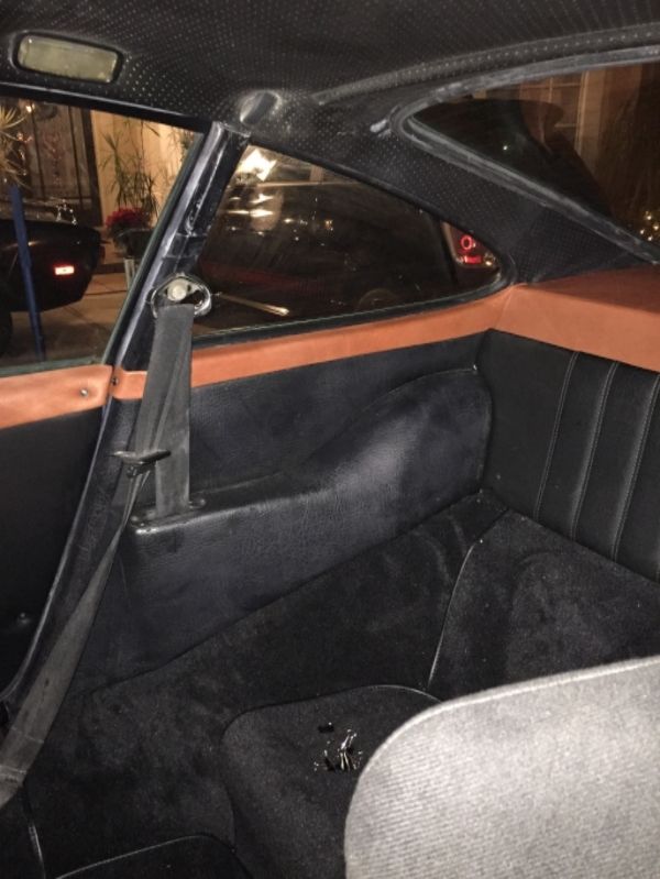

I then went on to work on recovering, in leather, the side molding... one side done!
http://i151.photobucket.com/albums/s...psedsqpsad.jpg
Wine is calling, Good night!
Edit: A better photo... all secured, both sides installed, and panels cleaned... just need to vac the carpet.
http://i151.photobucket.com/albums/s...ps5uk7uezo.jpg

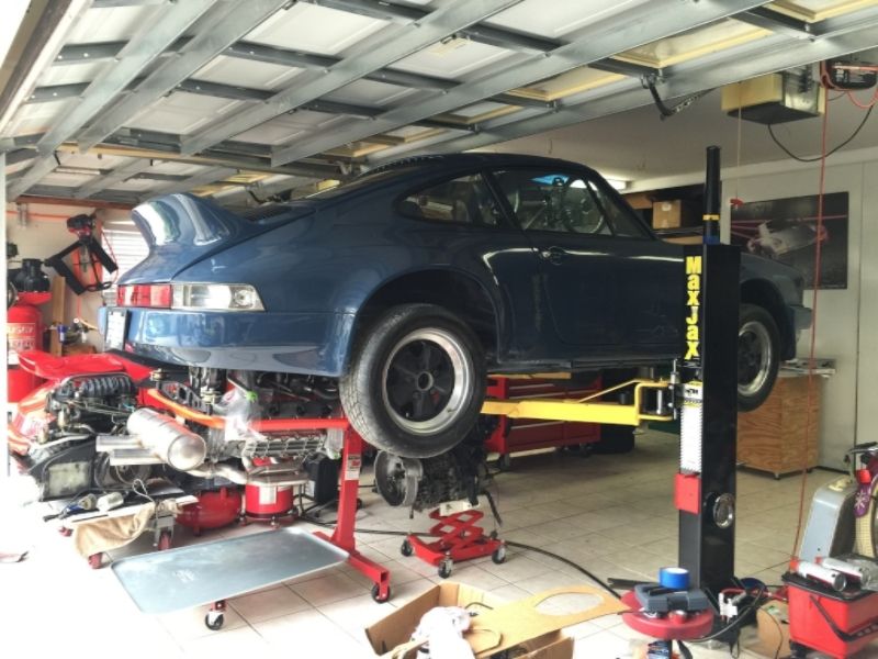

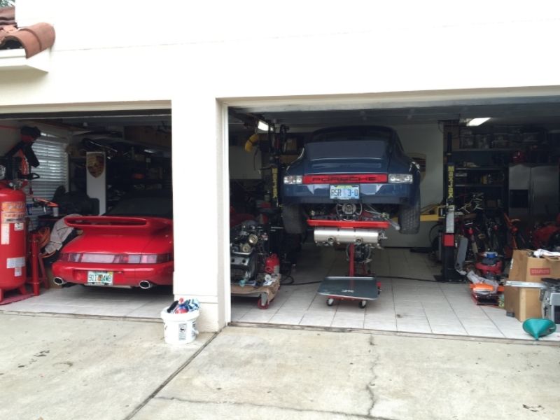

Moved the cars around to be able to work more comfortable with the suspension and brakes...
http://i151.photobucket.com/albums/s...psyb482exl.jpg

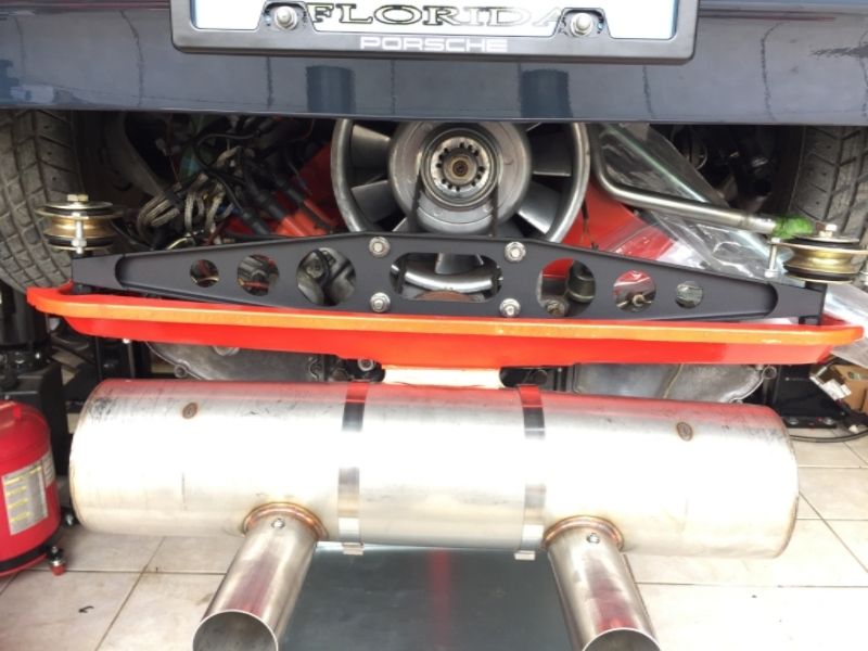

Installed the Rennline engine crossbar as well...
http://i151.photobucket.com/albums/s...psbevdzyu9.jpg
The RSR 3.0 tag was from the RSR project... with that gone, I had it laying around... not the right tag for this car but just using it for the photos.
http://i151.photobucket.com/albums/s...psxgndv1bx.jpg
Still cleaning and organizing the garage, again!. To make room to be able to work on the car while on the lift... it helps that a few 911 SC boxes got emptied and 912 parts can go in their place :) And putting trash where it belongs...
http://i151.photobucket.com/albums/s...pssuxrbak6.jpg

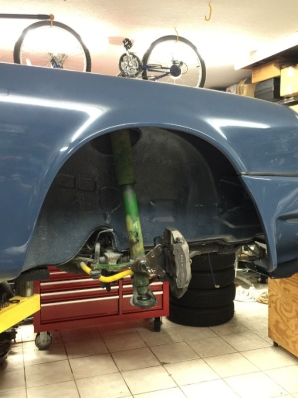

wachuko 01-02-2016 07:05 PM

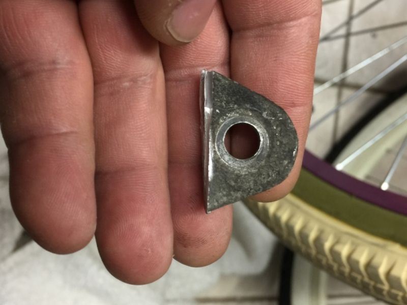

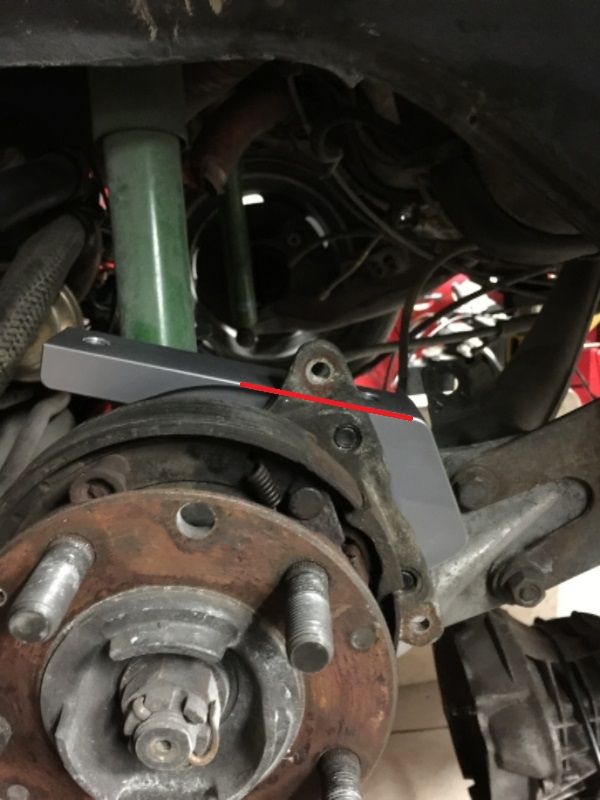

Started to install the rotors, calipers, etc. and forgot to read the fine print...
http://i151.photobucket.com/albums/s...psyoehzq76.jpg
I first have to remove the tab to allow for the needed clearance...
http://i151.photobucket.com/albums/s...psy9juyou1.jpg
wachuko 01-03-2016 11:38 AM
Modification done and both calipers installed. It is time for one or four margaritas!!!!
http://i151.photobucket.com/albums/s...psq28ke82s.jpg

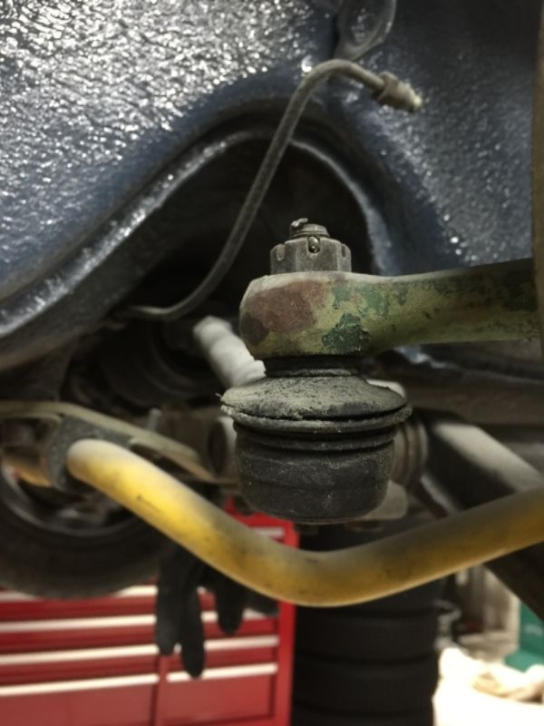

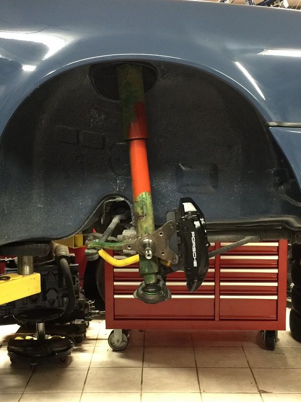

So I spent time taking apart the front rotor and inspecting the condition of surrounding components.
http://i151.photobucket.com/albums/s...pst4daki8r.jpg

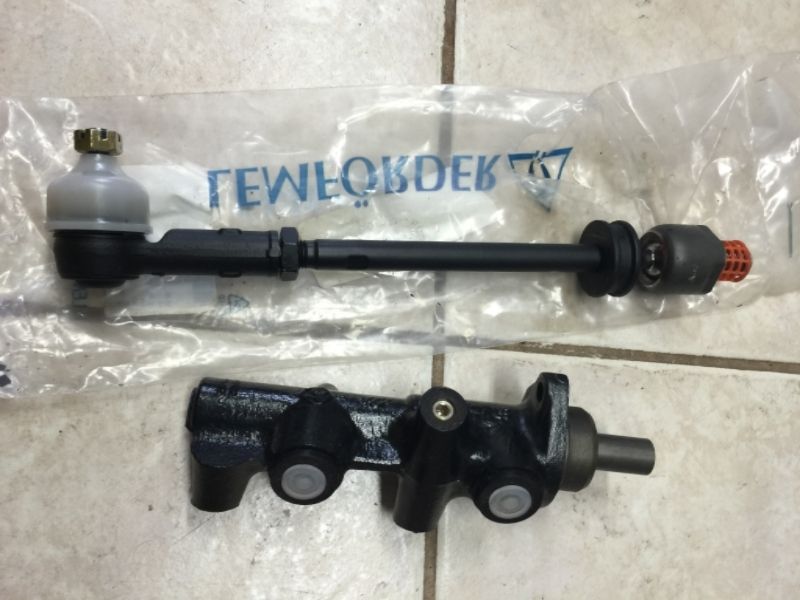

Car came with a new set of Turbo tie rods, perfect as the ones in the car are in need of replacement:
http://i151.photobucket.com/albums/s...psi0ujso8y.jpg
http://i151.photobucket.com/albums/s...psyejgdfy1.jpg
All out, tested the mount and caliper. Since the front set of calipers are used, need to paint them and install the new PORSCHE labels that I got for them.
http://i151.photobucket.com/albums/s...ps2rm3fs7q.jpg
Could not resist to spray some orange paint on the strut :)
http://i151.photobucket.com/albums/s...pspbsfipkt.jpg
I need new bushings all around, remove and clean, powder coat, etc. Torsion bar needs to be redone...black or orange, anything but the current yellow that it has...

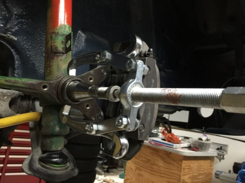

Also need to remove the spacer and O-ring from the spindle using a two jaw puller....

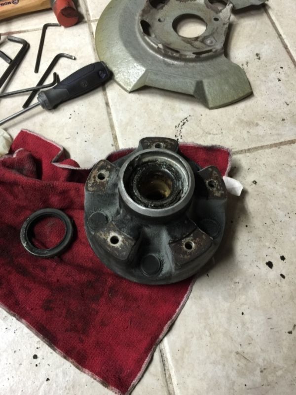

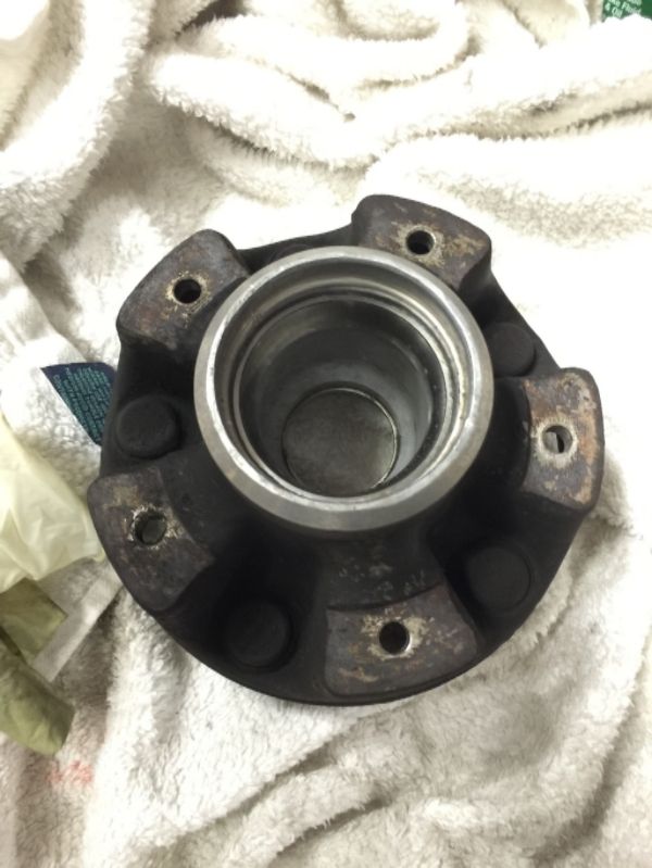

Cleaned one of the hubs... need to do a second pass on it...

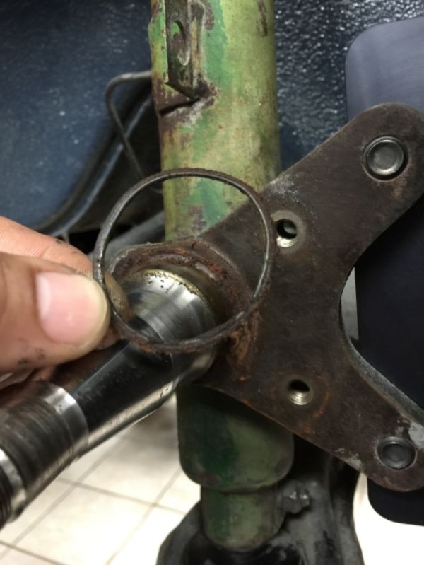

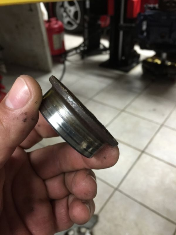

Removed the bearing spacer using a two-jaw puller...
http://i151.photobucket.com/albums/s...psjirv6zpm.jpg
http://i151.photobucket.com/albums/s...psdqqglzhl.jpg
http://i151.photobucket.com/albums/s...psxdydmemx.jpg
Removed o-ring, or what was left of it, lol
http://i151.photobucket.com/albums/s...psl675e6mh.jpg

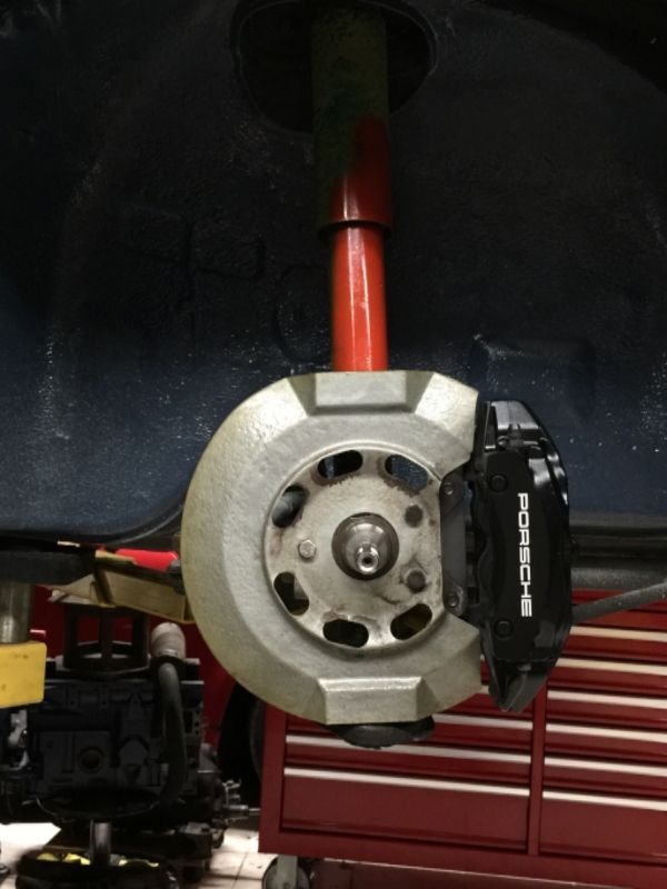

Cleaned the area... also painted the caliper. Will install the PORSCHE sticker tomorrow...
http://i151.photobucket.com/albums/s...psfee0b1nx.jpg
wachuko 01-05-2016 04:57 AM
One front calipers done...
http://i151.photobucket.com/albums/s...psshcep24r.jpg
http://i151.photobucket.com/albums/s...ps2wwezr3x.jpg

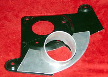

This came in last night... for US$22.00 I figured that I would take the chance with it. It is from a 1996 911/993 but it looks like it would work. So unless there are any clearance issues with that metal piece on the upper left, I am hoping that it works... I will just need to drill out the ball since mine just has a hole in there to insert the rod instead of a ball socket... Cautiously optimistic that it is going to work :)
http://i151.photobucket.com/albums/s...psvxaxyrha.jpg
http://i151.photobucket.com/albums/s...pscnty0ffl.jpg

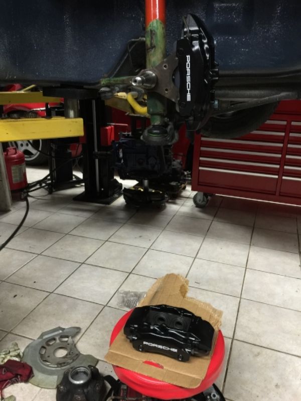

wachuko 01-06-2016 06:17 PM
Finished the second caliper... both now painted and with the script/label
http://i151.photobucket.com/albums/s...psywfccnof.jpg
Modified the shield so that it would work with the new calipers. Yes, still need to get that powder coated (or painted) black :rolleyes:
http://i151.photobucket.com/albums/s...psnehxzewg.jpg

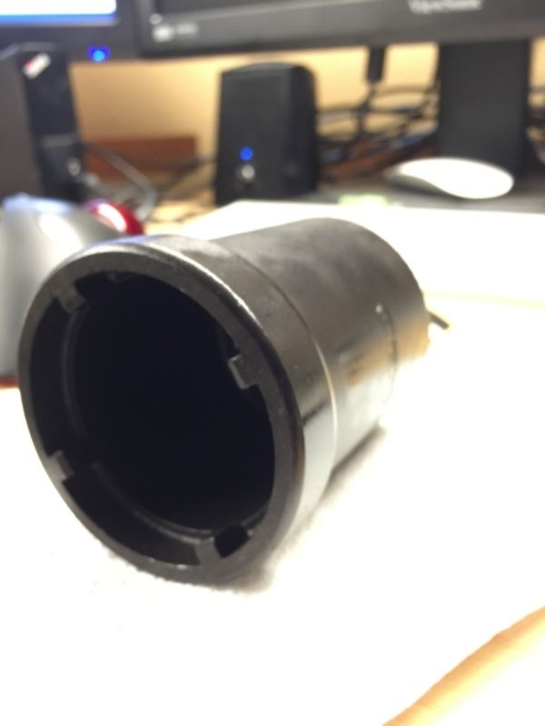

I also got the tool to remove and install the grooved nut for the ball joint . Only 20.00 from Amazon! - OEM 25965 1/2-Inch 66.5 by 80mm Front Wheel Bearing Locknut Socket
http://i151.photobucket.com/albums/s...pslwp1zkyv.jpg

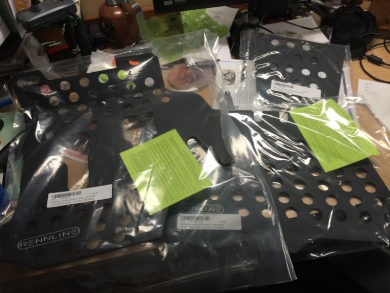

These came in today
http://i151.photobucket.com/albums/s...ps0p3qgbir.jpg

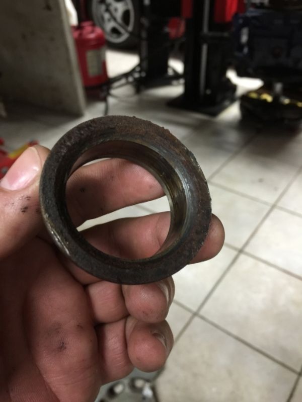

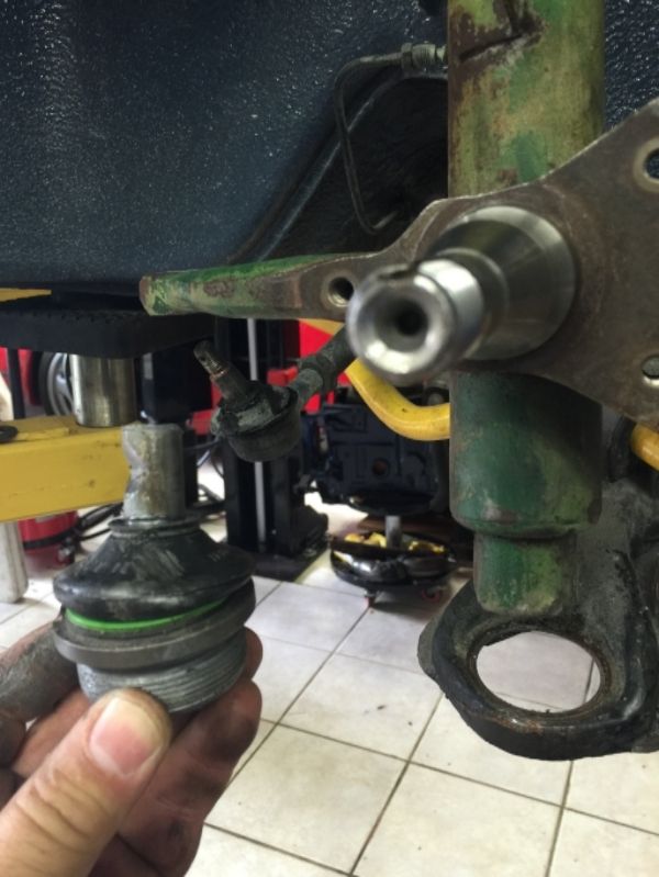

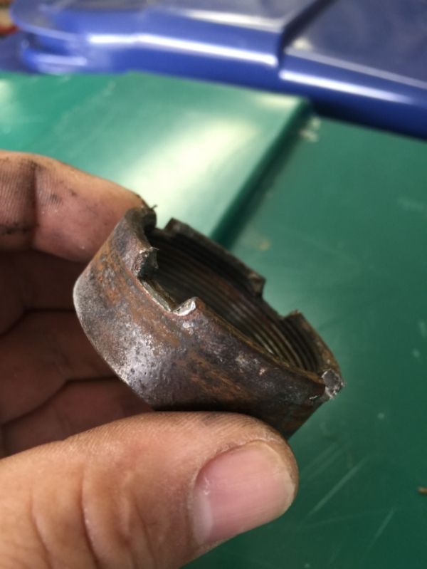

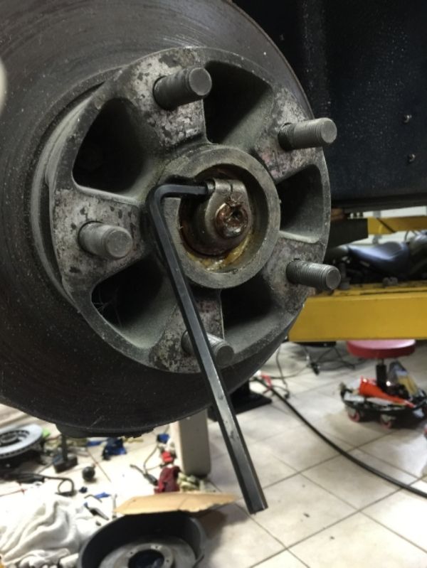

I hate it when people do not use the correct tool... ruined nut, reason why I ordered a new one. The tool that I got worked great with an impact wrench...
http://i151.photobucket.com/albums/s...psrqh9xjhd.jpg
http://i151.photobucket.com/albums/s...psepbqxhez.jpg
http://i151.photobucket.com/albums/s...psdflnakpe.jpg

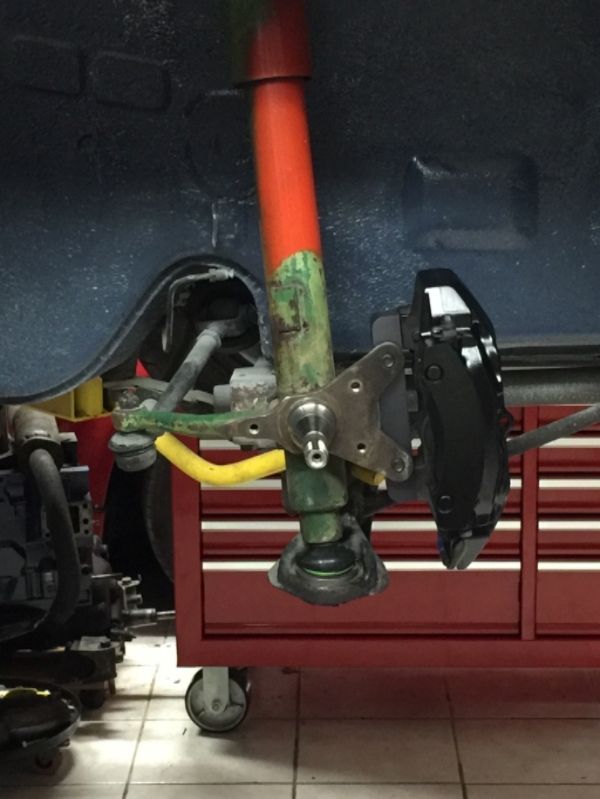

I continue to remove the front suspension and steering rack...
http://i151.photobucket.com/albums/s...psngkruc25.jpg
Removed the driver side wheel hub...
http://i151.photobucket.com/albums/s...psykfqx4ar.jpg
And both struts...
http://i151.photobucket.com/albums/s...psdmmzhaji.jpg
More parts out...
http://i151.photobucket.com/albums/s...pslp75neai.jpg

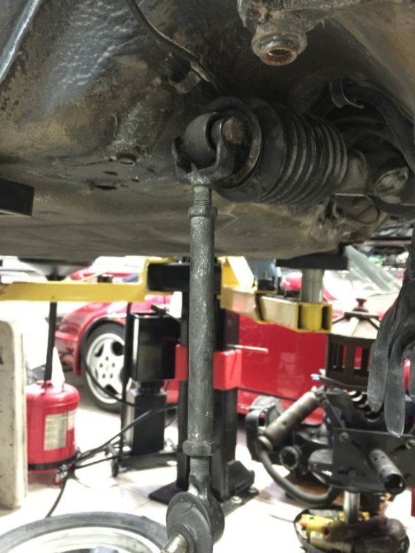

Driver side tie rod out...
http://i151.photobucket.com/albums/s...ps6kfncxve.jpg

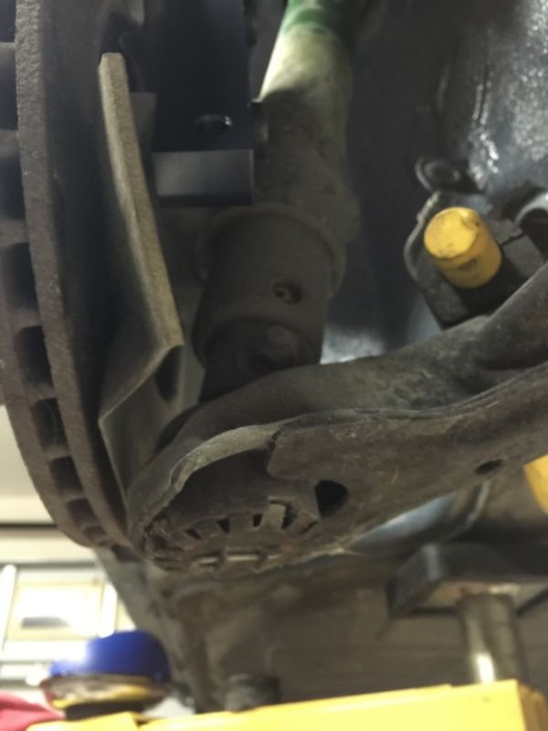

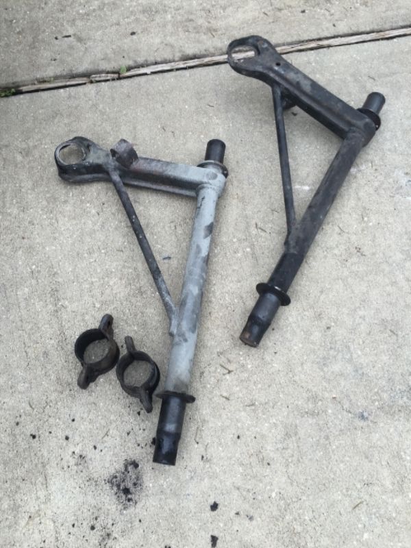

This side is giving me a lot of work to get out... then I remember that the previous owner had Turbo Tie Rods...
http://i151.photobucket.com/albums/s...ps7pddruoz.jpg
http://i151.photobucket.com/albums/s...psq6mvhwrv.jpg
I have to look through the boxes since I only see the Turbo Tie Rods but I do not see the spacers and boots... Anyway, that means that I am just going to unbolt the whole thing from the rack... easier than the struggle that I have been going through the last few hours trying to remove that sucker out! :banghead:

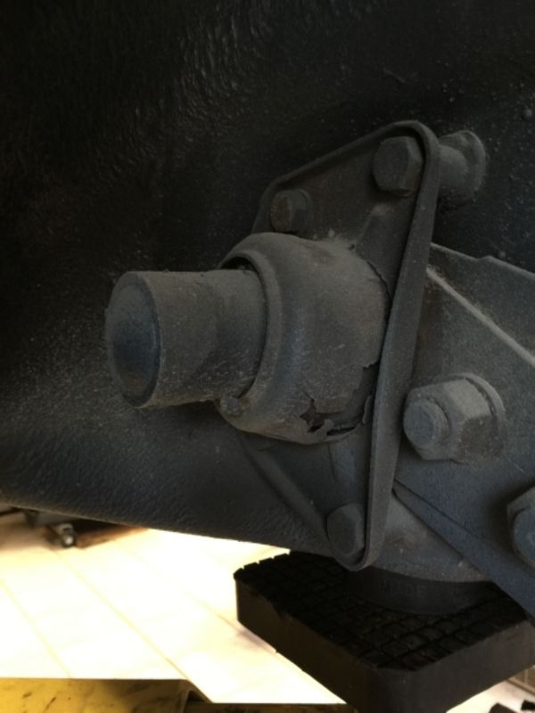

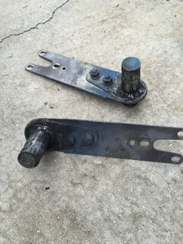

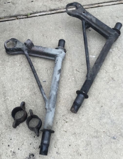

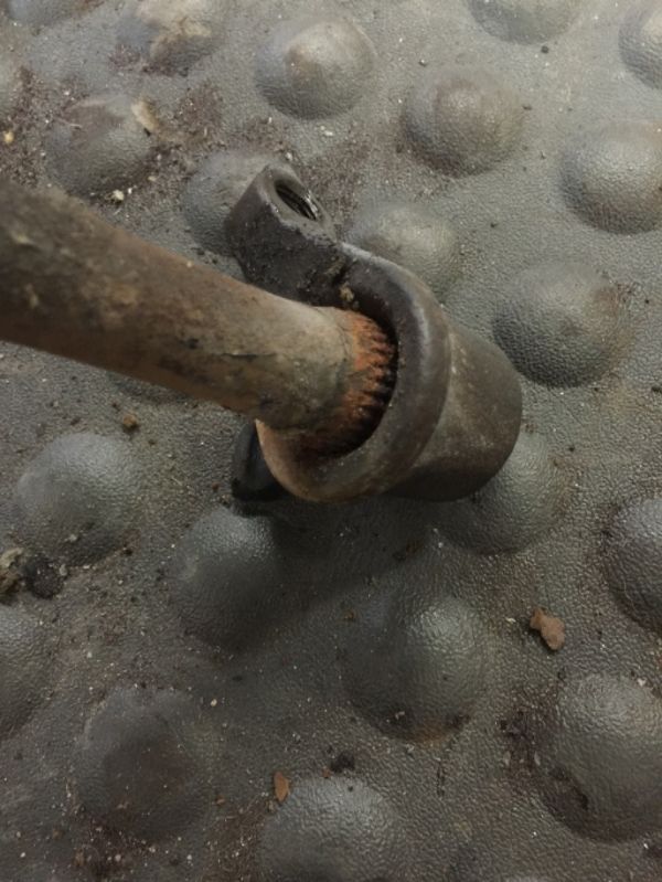

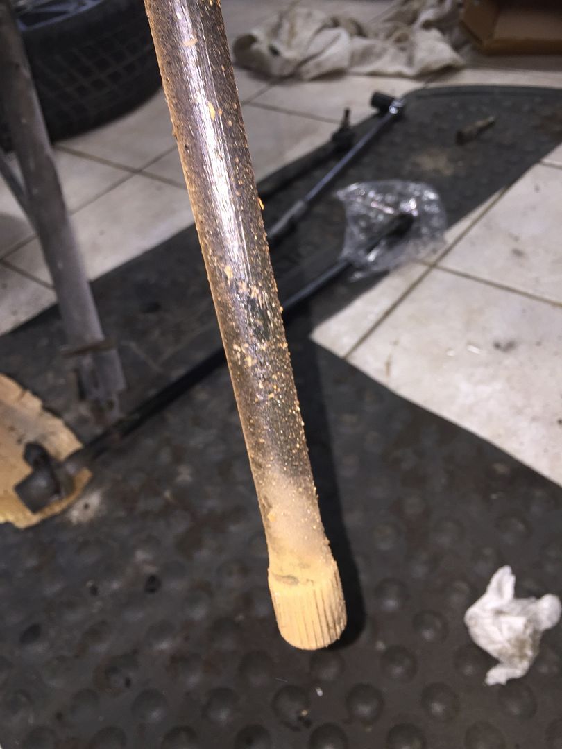

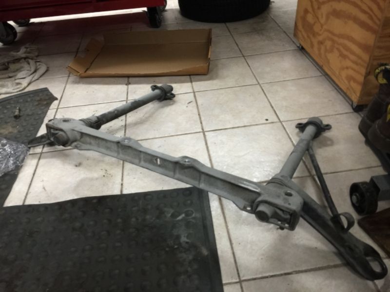

The other surprise that I came across is this... When I removed the torsion bars... one (L) was great and easy to remove... the other one (R) :banghead: not so much... Letting it soak in WD40 to get the reverse lever out..
http://i151.photobucket.com/albums/s...pscjoxogt3.jpg
http://i151.photobucket.com/albums/s...psgjys7ji3.jpg
So Left torsion bar is fine... it had grease all over and came out fine... Right one was dry, rust towards the reverse lever... I am no genius, but I am guessing that I will need a new one... good grief!

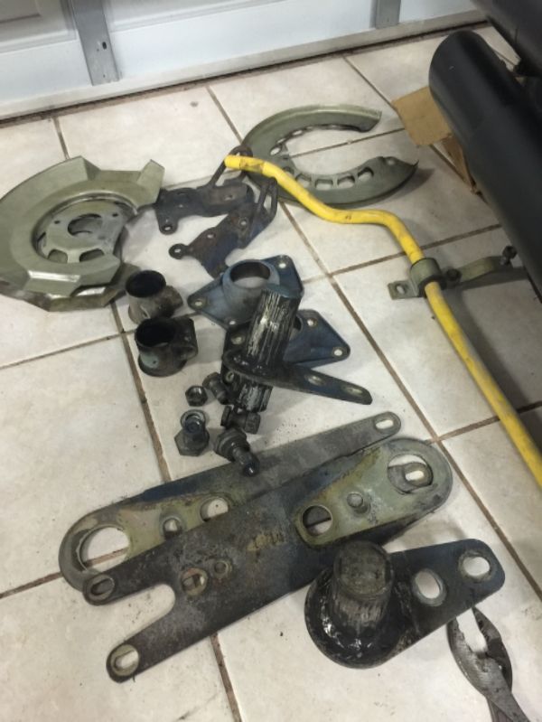

I kept my mind busy with other tasks... put the torsion bars aside...
http://i151.photobucket.com/albums/s...ps7rn9gckm.jpg
Nothing like a torch to release some of the stress, lol. Went on to remove the rubber bushings from just about everything...
http://i151.photobucket.com/albums/s...psz9hj7ghk.jpg
http://i151.photobucket.com/albums/s...ps6sfcb2en.jpg
I thought about doing yellow-zinc electroplating on some of these parts, but this is not a restoration... so I will take all these parts to get powder coating in semi-gloss black.
http://i151.photobucket.com/albums/s...psg6iycn3o.jpg

As I was making the list of the parts to send to powder coating... I realized that maybe I should ditch the dust shields on the brakes... with that RS front bumper, I should route a hose to the rotors for better cooling instead. I wonder if anyone has modified the stock dust shields to incorporate a 3" hose into them...
The cooling duct adapters available for sale are 120.00 each... gives me enough incentive to at least try to use what I have... OR it will prove why they charge 120 for each duct adapter, lol!!
Thinking about something like this:
http://www.allstarperformance.com/product.htm?prod=359&part=ALL42115
